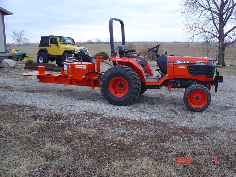

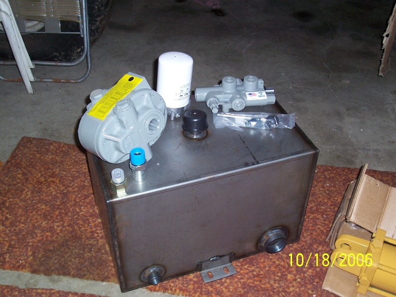

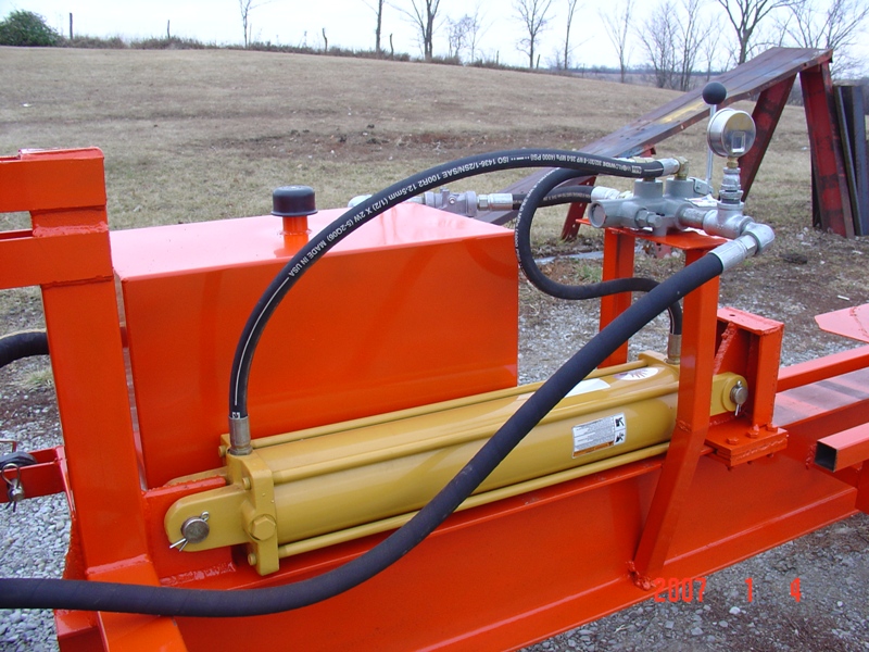

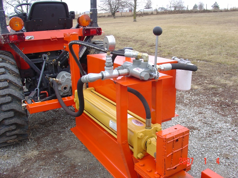

I built one to use on a 30HP Kubota B2910. I used a 22gpm PTO pump. I loved it. Cycle times were great and it had tremendous splitting power.
Here's a couple pics.
