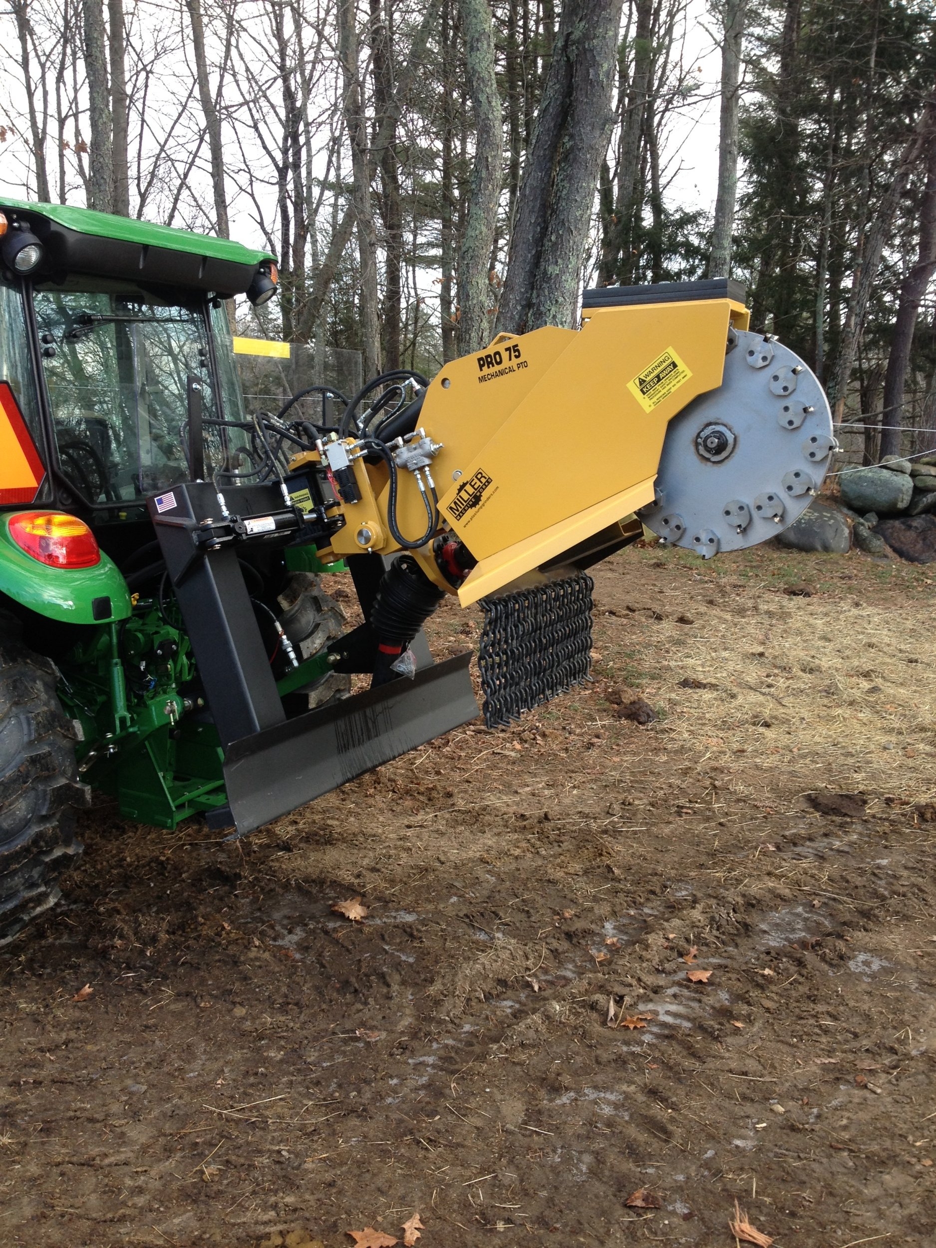

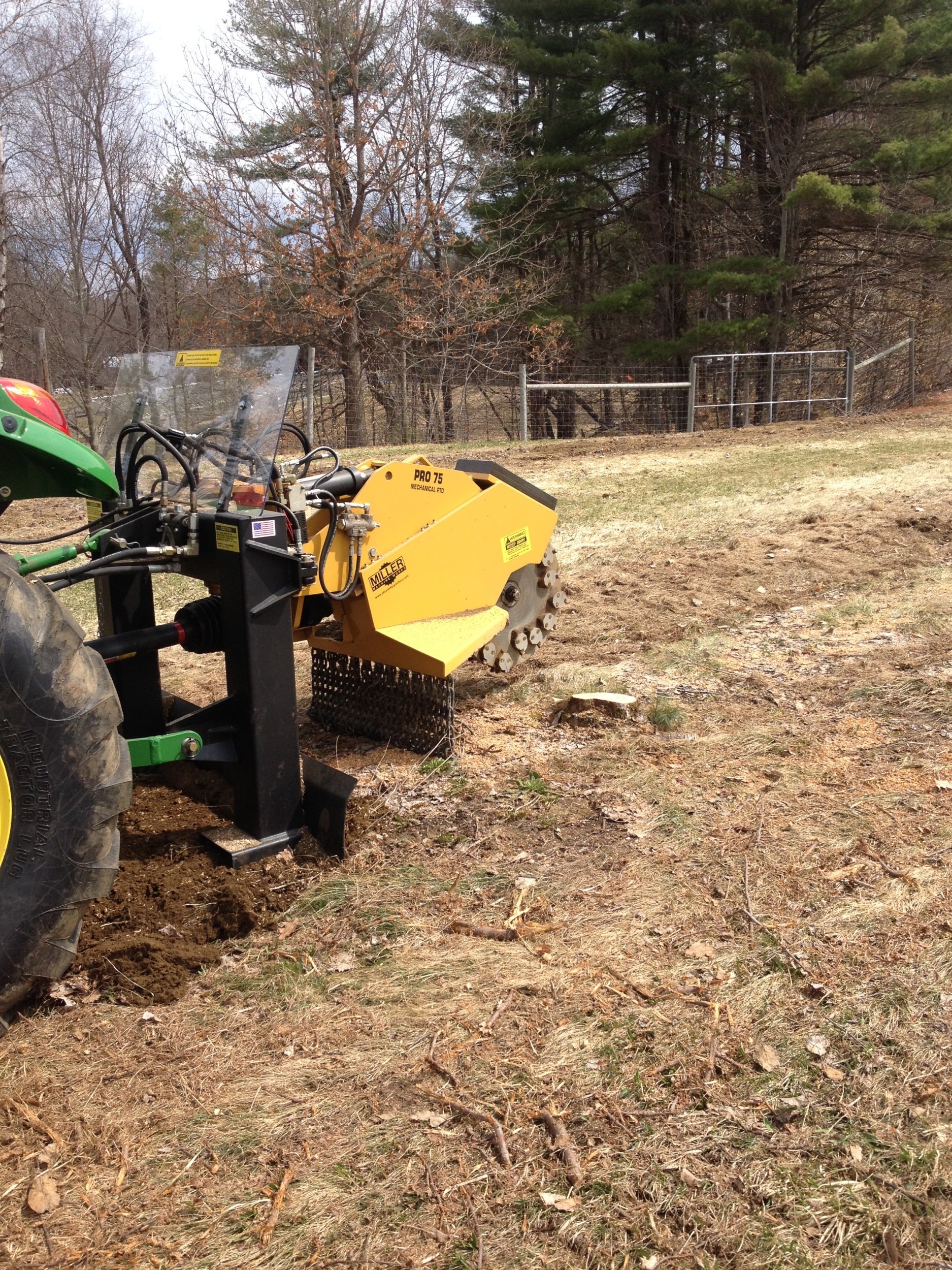

When I quote a job (just got and ground 30 pine stumps for a gal on the other side of town), I cut them all 10 below, pile the chips back over the stump with the loader and let them turn to mulch. It is a money maker for me and upkeep is minimal. Grease the cylinder pivots, check the oil in the gearbox and grease the PTO driveline and that is about it.
Get a kick out of watching Chris grinding stumps on YT with his self propelled Rayco. he has a dozer blade on the front to push the chip pile back over the stump. I use the front loader bucket. He has an air cooled Deutz in his Rayco and like me, always 10 below grade
