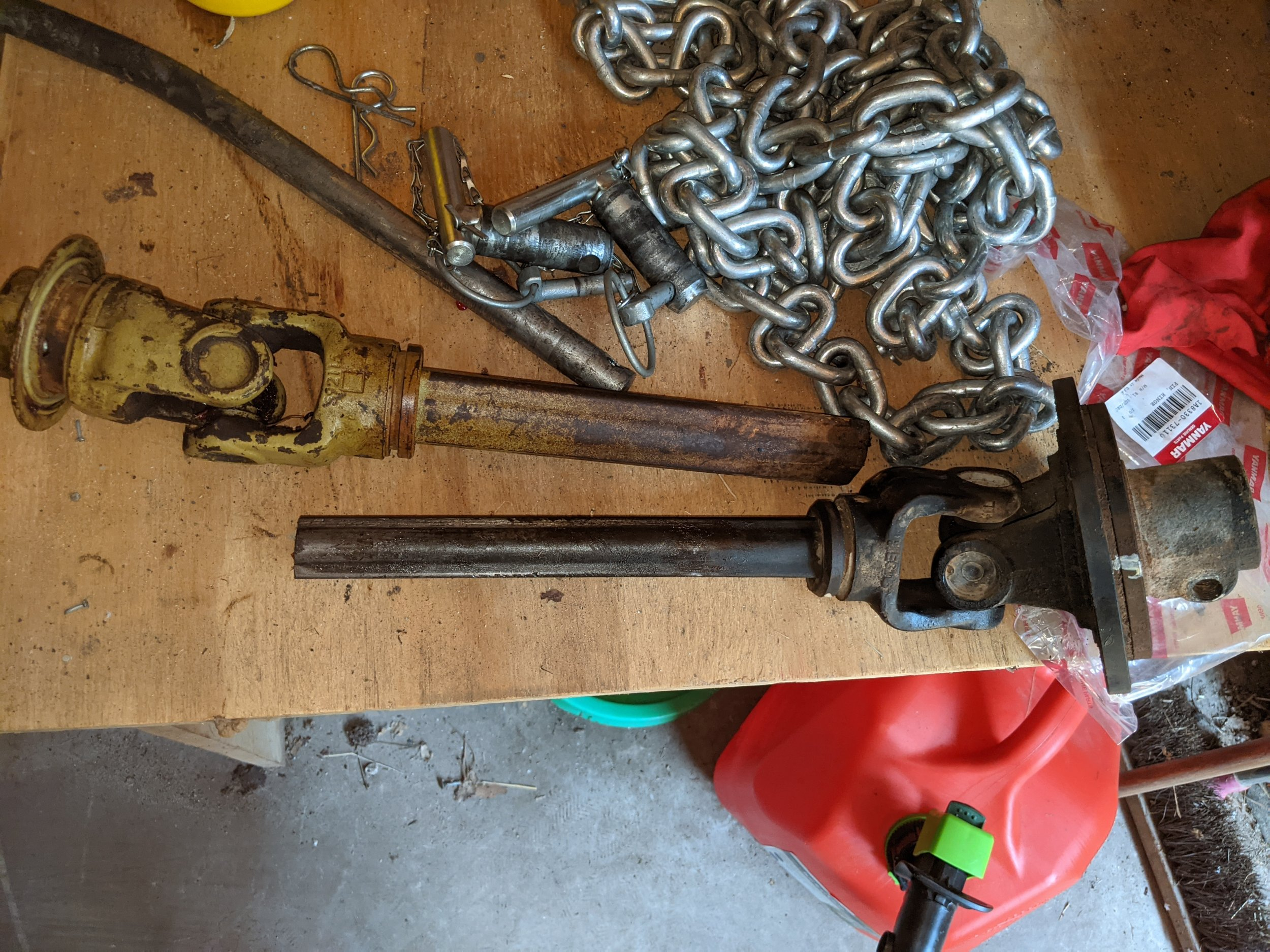

I recently acquired a used Land Pride rototiller, but the driveshaft is too short for my tractor. Do I need to replace the entire shaft, or can I find just the tractor side and replace one end?
Second, the current driveshaft has a slip clutch. Is the slip clutch part of the driveshaft, and if replaced I would need another driveshaft with slip clutch? Or is the slip clutch removable from the driveshaft, and could be installed on a new driveshaft? It looks to me like it's one complete unit.

Your questions and guesses are all valid answers.
Specifically you would need to take an image of your shaft to confirm if it is one of the combined units or if the clutch was added.
Most times it is cheaper to buy both haves of a shaft used than it is to buy one half new. It is also usually helpful to have an extra around if you ever need a joint or get an implement closer to your tractor.

I attached a picture, I'm not sure if I can pull it off at the yoke?
How much too short is the driveshaft? If it's only a couple inches too short you can get a PTO extension or an overrun clutch to put between the tractor and the driveshaft. Otherwise you're probably looking at a whole new driveshaft.
It's not even close, the two halves overlap by maybe 1/2 inch when I lower the tiller.
So I guess I need a whole new driveshaft. That leaves me wondering if I need to find one with a clutch, or can I pull this clutch off at the yoke and throw it on a new one?

Yeah you could pull it off if you were so inclined and have a ujoint puller already.
Sounds like you need to look around for another shaft; find the shaft and if it doesn't have a clutch add one or split your and swap it so you have a standard pto and the long one with a clutch on it.

In my opinion, that "disc" on your shaft isn't a clutch.
At least not what I know how a clutch looks like
If you look closely you'll find that there's a roll/spring pin holding the yoke to the shaft. Just punch it out.

Thanks everyone. Looks like I can use the clutch and collar/yokes I have and just get new shafts, should be a bit cheaper that way.
/ PTO driveshaft replacement #20
So I remembered how I removed the yoke... After driving out the spring pin, clamp the drive line tight in a vise with the yoke facing down and hit the top of the yoke on the outside edges.
Seems like a hassle and you still have a ujoint with no grease nipple based on the picture. Then again probably the same amount for work to pull the ujoint.
