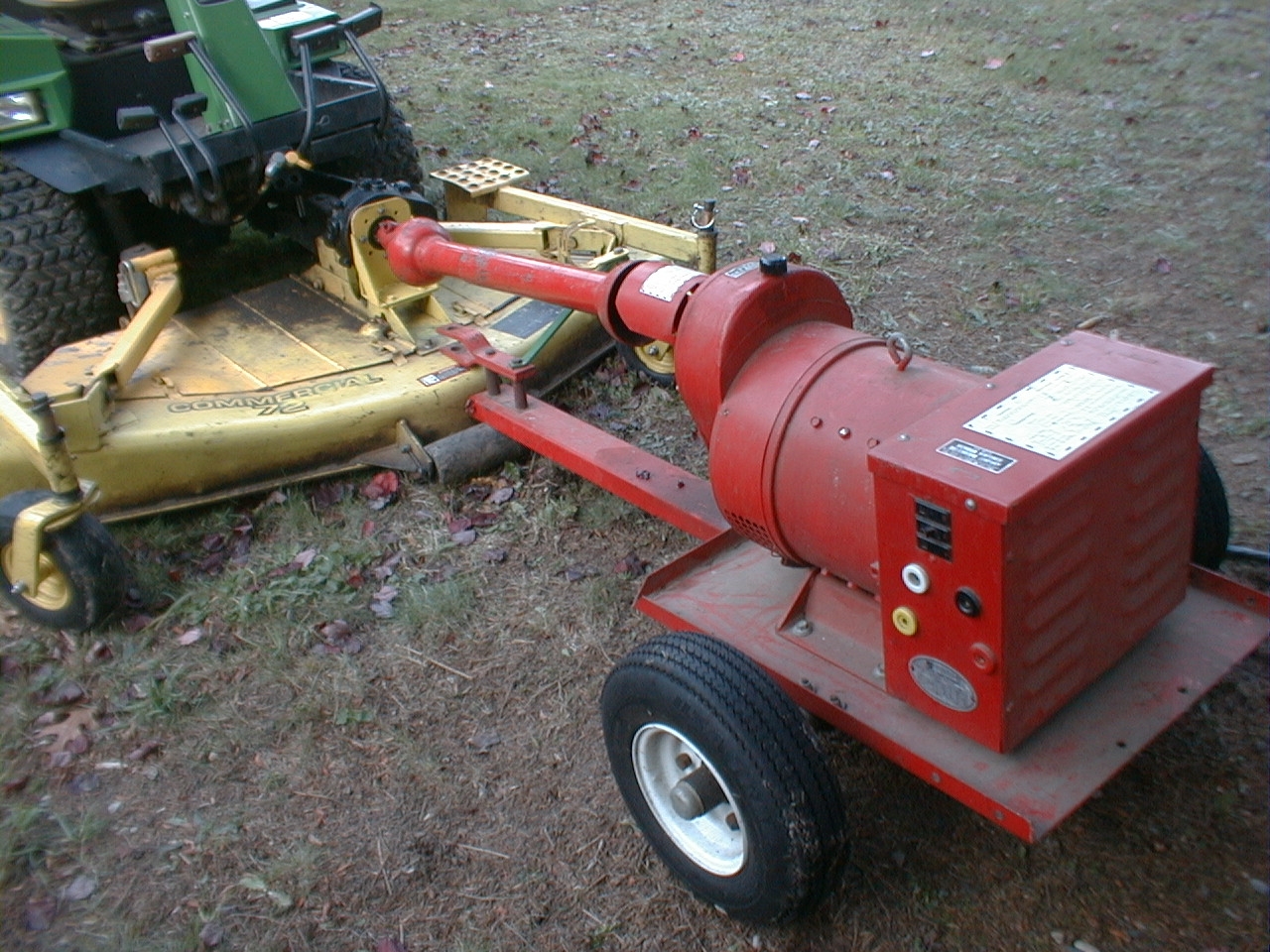

I can run mine off my lawnmower. I bought a 3:1 reduction gearbox with a 540 spline output shaft and made a bracket to hold it. The JD935 is on 22 h.p. but serves all our needs. I use a Kill-A-Watt monitor to get frequency. The only 'problem' is that not everyone in the home is savvy enough to drag it out and hook it up. I'm considering a 3 cyl Shibaura or Yanmar diesel motor out of a junk mower to dedicate it to full time standby. Park it in a doghouse. I also just had to pay $1000 for a natural gas meter upgrade for a standby generator, but there weren't any available in the size I needed. The PTO option has other uses, too. Power out in the Way-Back for pumps, welder, air compressor, etc.
