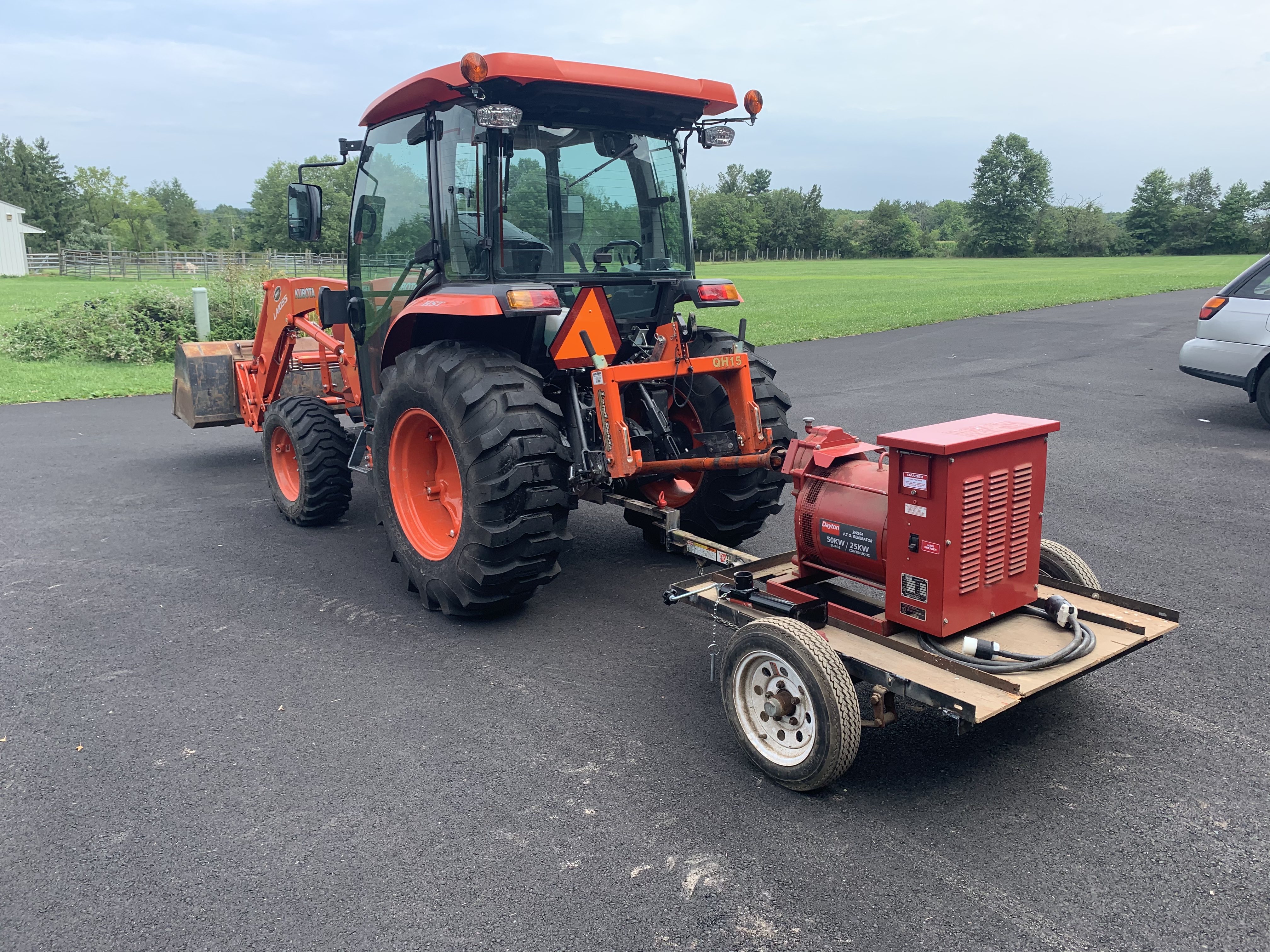

I agree with the procedure mentioned here however I added a heavy ground cable to the frame of my 25kw pto generator so I can ground my tractor/generator to a suitable ground or ground rod.
The electrical integrity of any portable generator should not be taken for granted.
My generator is directly mounted on a 3pt hitch platform and during operation I set it on the ground along with the loader to minimize the possibility of shock when getting on or off the tractor.
As mentioned earlier there are more hours designed into your tractor engine than you could possibly use. Do not worry about wearing out a well maintained machine it was made to work.

I ran across an interesting PTO generator video on YouTube. This is an old IH PTO generator. I think it's rated 13.5 kw continuous 3 phase, or about 4k single phase. I have thought about shopping for a used 3 phase generator like this because 3 phase shop equipment is a lot cheaper than single phase. The voltage regulator is really simple and good enough for non-critical work. The description of that starts around 20:45
