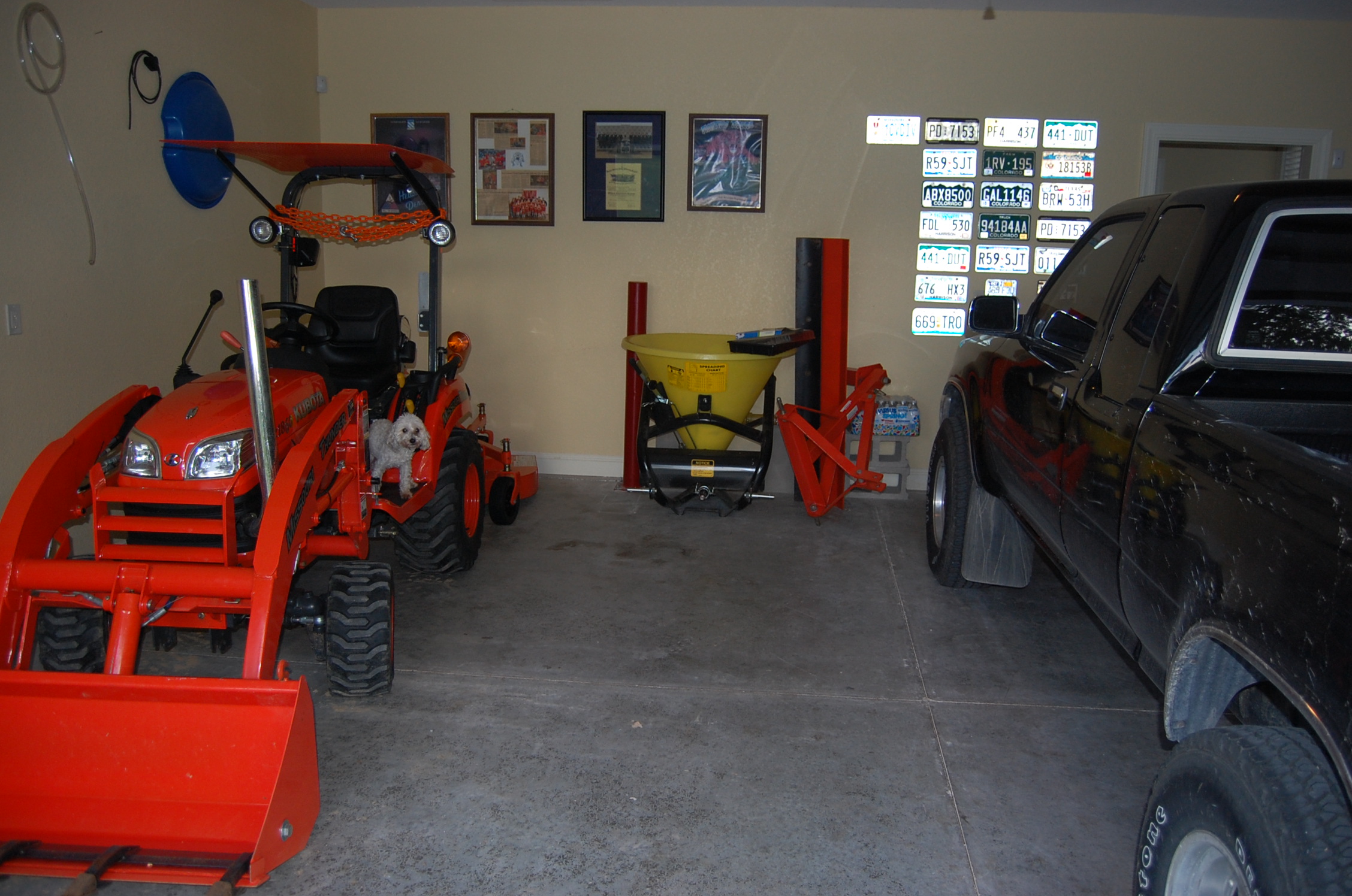

Nice looking new place.

To the OP. Looking at the pictures.....just let that grass grow and it leave it to the crickets.!! THAT is an accident waiting to happen.
