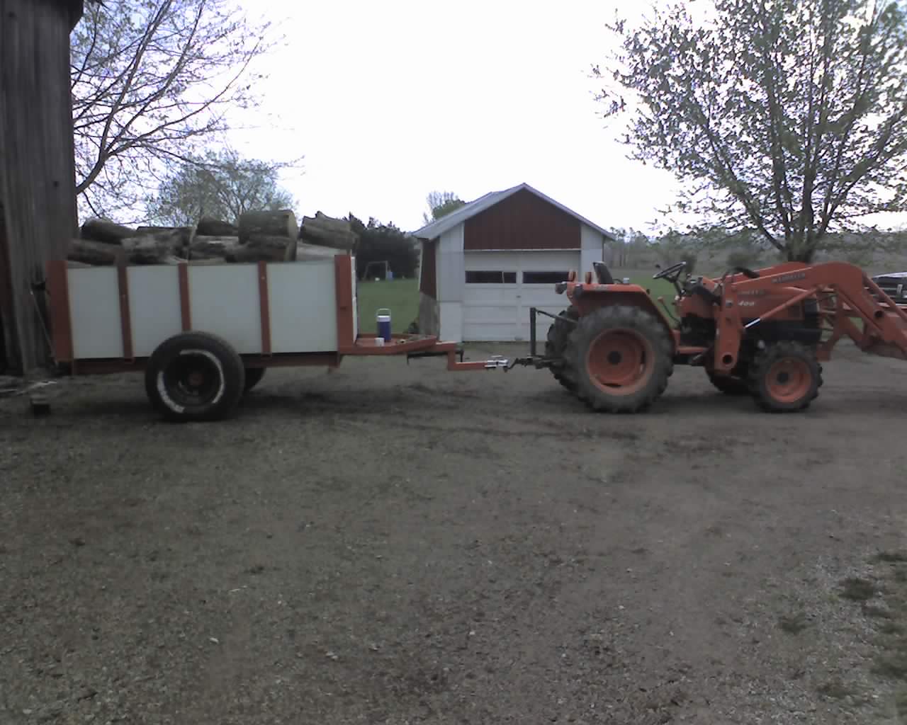

Just FYI, using one of those gooseneck hitches on the 3pt hitch is VERY hard on the top link/mount. We have one that we sometimes use on our tractors to pull a similar sized gooseneck trailer as well as a gooseneck cattle trailer, but only with light loads on relatively easy terrain. When you pull with one of those virtually 100% of the pulling force is transmitted through the top link, which it is definitely not designed for. Furthermore, the toplink mounts on the larger Kubotas are used for the draft sensing mechanism and therefore even less adapt to this kind of use.
I'm not one to tell others how to use their tractor, but just be aware of this as it is something that most people don't consider.
Being a machinist by trade I'm very aware of geometry and angles and I don't see where the top link (draft control linkage) receives any undue strain. As an aside, I lock the hydraulic valve before moving any trailer so the system is in hydraulic lock anyway. Been doing it for years with no adverse issues. I even did it with my 5030 that had no draft control. I've pulled some serious loads, upwards of 15 ton on the gooseneck from the field to the barn.
I don't see (I've watched the linkage and the 3ph out the back window) when pulling and there is no movement in the actuation linkage whatsoever.

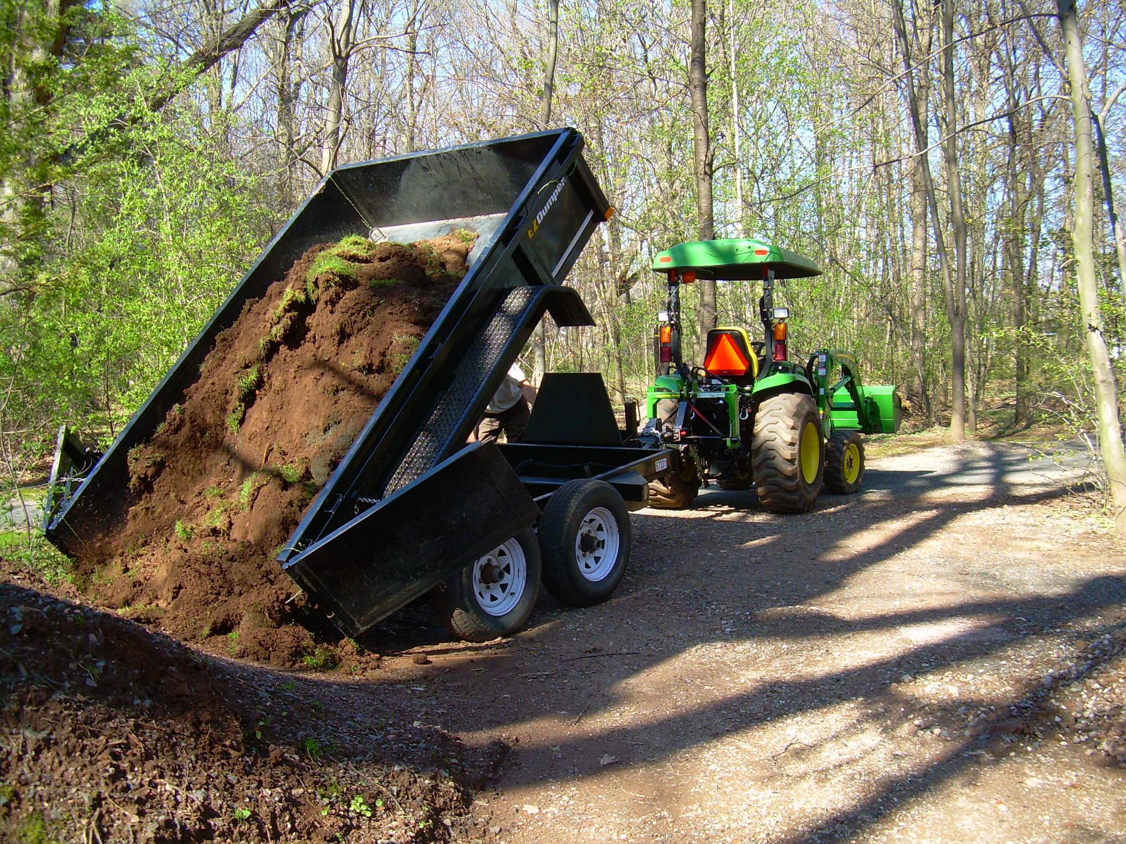

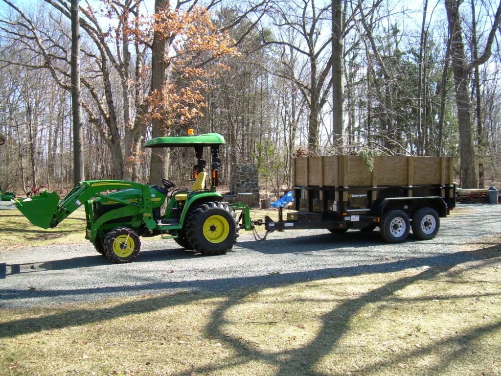

I missed this thread, but I think it's right up my alley, just a different color.
I do exactly what you are talking about with a 10,000 pound pintel hook dump trailer.
Coupled to a 3 pt receiver hitch. works awesome, if you go heavy stay in 4x4 in low range, you'll have all the control you need.
You could use the break away switch in an emergency if you were on crazy hilly terrain and super heavy.
You do need to limit the free travel of the 3pt with a chain to the draw bar, especially for dumping the trailer as it causes uncontrollable tongue/3pt lift.
I did just what you're talking about to dig out my patio.
JB
