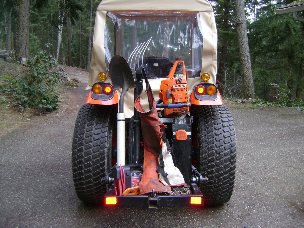

The draw bar worked well on my 8,000# trailer with a 19HP case tractor. I know have a 27HP & use the 3 point a mod..jpg3 point addition 002.jpg
The draw bar is kind of low so I had to raise the ball when I used it. Also it's real hard to see where your going when using the tractor I've considered making up a quick attach mirror.

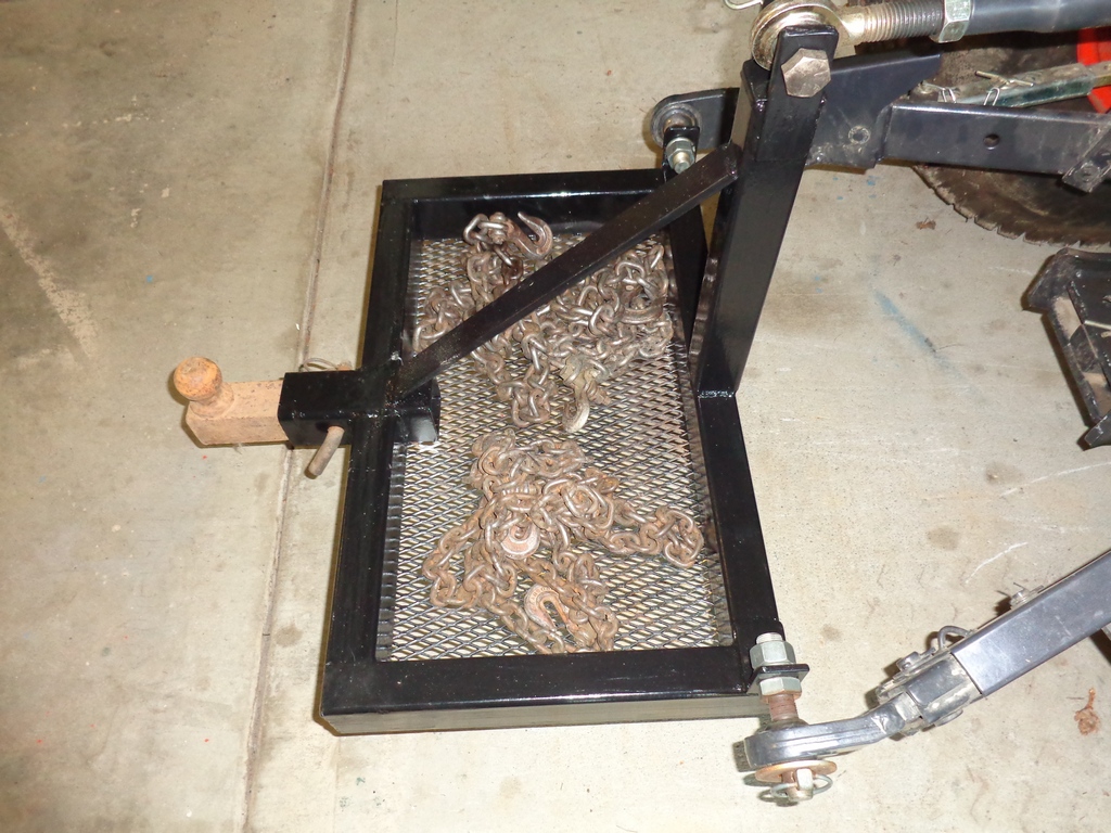

Travel trailer, boat trailer, utility trailer, tractor float, wood splitter, etc. Put a good receiver on the 3pth and you will find numerous uses. Just back up under the trailer and lift the hitch. Most times you will not even have to throw the latch if you have enough torque weight. Most of my trailers have tongue jacks that never move.....

I have a small JD X740 with a three point hitch. I built a trailer mover similar to those at Tractor Supply and it is on and used 99% of the time. I either have a stinger on for moving trailers around or a 2'x4' carry all like cars have on.
The bigger tractor I have has a 3 point mower or it would have one also.
The bigger tractor I have has a 3 point mower or it would have one also.[/QUOTE
I have added short sections of square 2.5" tube to the rear of my back blade, back hoe and snow blower for those times when I just need to move a trailer and don't have my normal counterweight and receiver on the 3pth.
