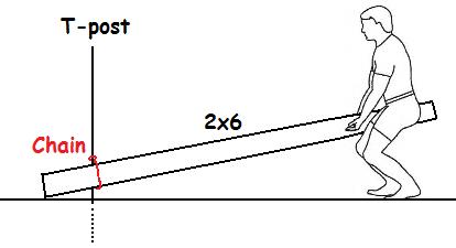

I've successfully pulled many metal t-posts by using just a chain & an 8' long 2x6 (10' or 12' is even better, but 8' works).
Lay the 2x6 on the ground right up against the post, with about 1.5' of the 2x6 extending past one side of the post, & the other 6.5' of it extending past the other side of the post. The 2x6 should be standing on its edge. Wrap the chain tightly around the t-post & then tightly around the 2x6. Put a bolt thru the chain to secure it in the nice, tight position you've got it at. Go to the long end of the 2x6 & lift up until the post comes out.
If you need more leverage, make the 1.5' end of the 2x6 more like 1'. Or get a longer 2x6. Also, putting a rock or piece of wood under the short end of the 2x6 will help if it's digging into the ground.
This is a very cheap method because the 2x6 is only $4 - $6 & most people that would be doing this job prob already have a chain & a bolt. It does require a little manual labor, but you need to work off that cheeseburger & fries lunch anyway.
Edit: A drawing is almost always better:
attachment.php
Edit 2: Dang, I drew the chain around the post above the 2x6 - It should be below.

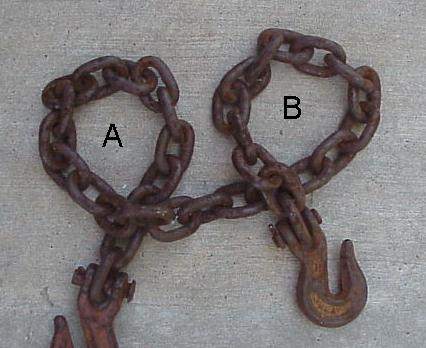

The round posts are often cemented in place, but even if the are not the big problem is getting hold of them. might have to drill holes to bolt a chain to them.
RoN
Maybe it's time to learn or re- learn how to tie the clove hitch knot the simple way and quit fooling around rapping the chain around and through itself until you are plumb tuckered out.:D
Since the top end of the post is open, throw a CCW loop "A" and beside it another CCW loop "B". Set loop "A" on top of "B" and drop it over the post to what ever height it needs to be. Pop one end like a whip to set the knot and pull. If there is any roughness to the pipe post it usually won't slip. If you need a second bite for another stroke, slide the knot, re set it and repeat. Works on T-iron post too. For this type of application 2 chain hooks aren't necessary and really just in the way.
+1. Lots of grip and T-posts don't stand a chance. I wouldn't even care to guess how many posts I've pulled this way.
