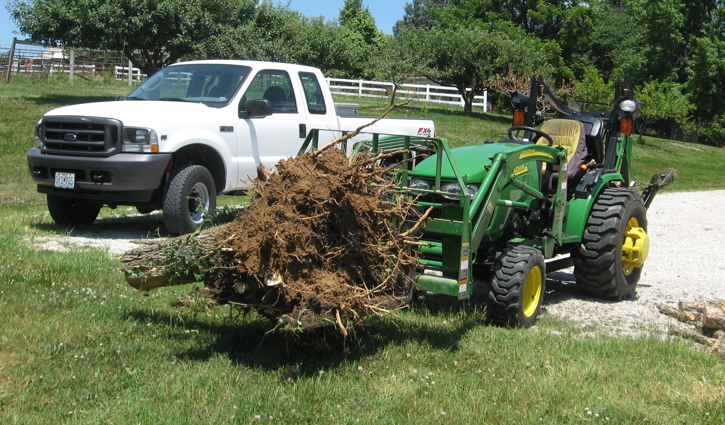

Now I grind the stumps a couple inches below grade, rake the chips back over the non existetent stump and in a short time, the chips rot and nothing is left to fiddle with ar all.
Same here, unless I want to plant another tree in the same spot, then I have to bite the bullet and dig it out with the backhoe.

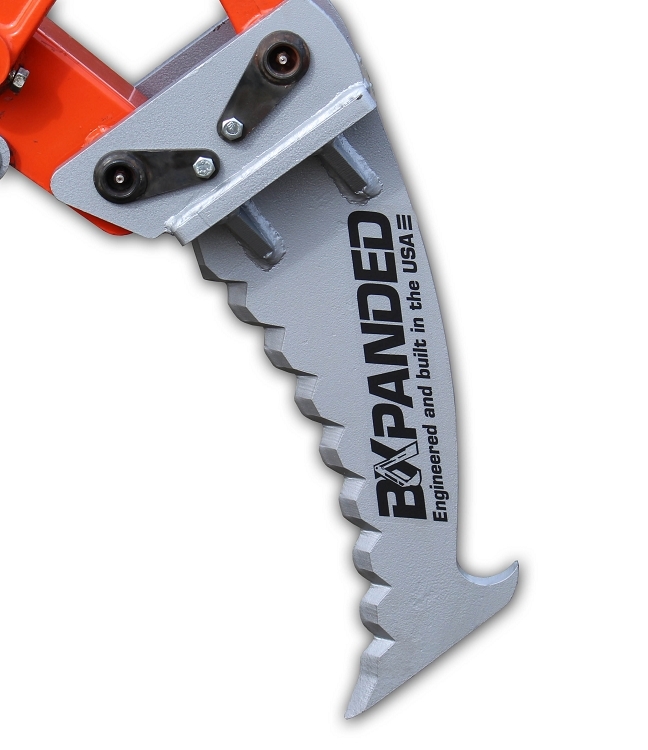

This reminds me, I have been kicking around the idea of building a root cutter like this
except that it would be mounted on a plate that would be quick attach/detached from the bottom of the backhoe bucket. Obviously, if it was just bolted to the bottom of the bucket, you would tear up the bucket, but I was thinking of welding it to a plate that would have a lip that curls over the front of the bucket between the teeth and bolts through the two holes in the bottom to hold it in place. A "slip-on" type of arrangement.
Just don't know if the backhoe on a 2520 has the power to operate it. I have the piece of metal picked out and sitting on my welding bench. Just can't decide whether to pull the trigger and do it. (hate to waste a perfectly good piece of 3/8" scrap steel plate).
I know Bexpanded makes quick detach bucket system to use with this, but they are expensive and they don't make one for my backhoe.

My kx has a ripper. Definitely makes less mess when root cutting.
