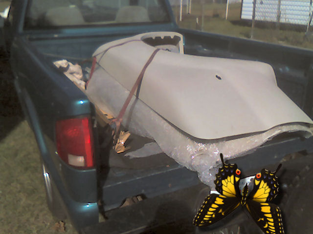

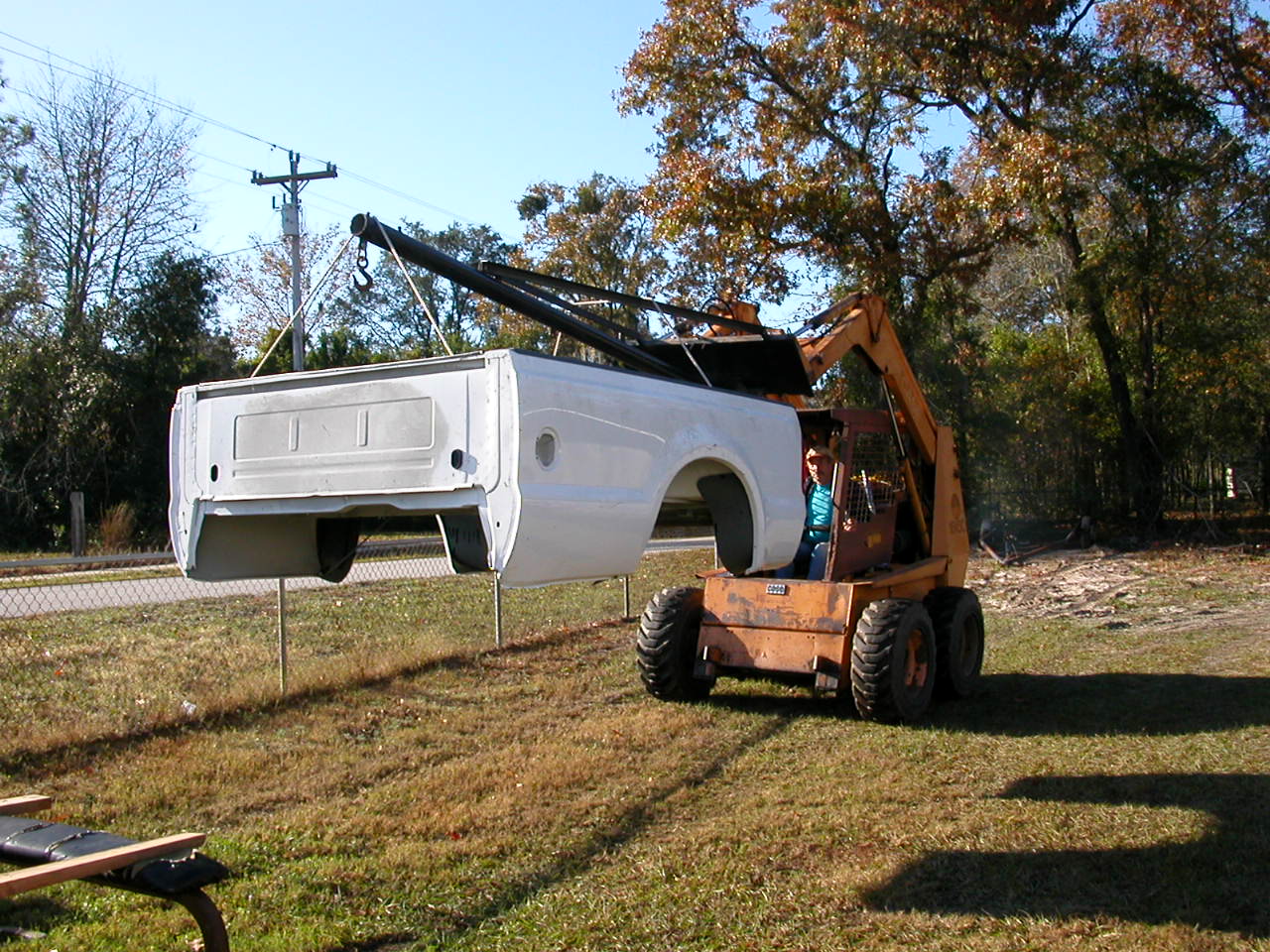

I have no idea about doing this but I think I have most of the parts, I want a strong truck to haul my stuff with and I think I found it after looking at the high prices for dually PU's with diesels I decided to go this way.
I bought a 2002 Ford F-550, cab and chassis then I looked for a suitable bed for it and I do not want a flat bed and I bought a single wheel bed and some new dually fenders for it.
And now the fun begins, I had to travel about 70 miles to get bed and fenders and then it had to come off and get turned over right side up ( I love my 10.5' boom pole and Case 1845C )
I know we all love pictures so here are some for all of you
Take your time and enjoy and if you have any ideas for me, I all ears and eyes
Jim

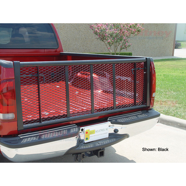

I left the same responce on the ford site, but if the stock tail gate is the problem what about a custom gate like for a 5th wheel. They are thinner, you could cut custom notches out to fit the frame, and make it look like part of the design. Or change the tail gate to a swing out instead of a drop down. Now thats custom!!

could you modfy the hinge points ?
