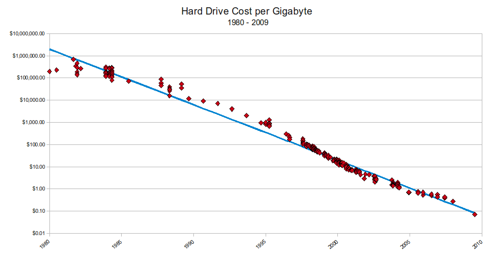

Your numbers are great, even though math is hard. Using numbers like those, I think we could say with certainty (in 1985) that the personal computer industry will be a complete failure!
It's so strange that I so often see many people in this country (the one that once put a man on the moon) say something cannot be done, it's impossible ("Not going to happen") ; while other countries are actually doing it today!
(Be it energy, or healthcare, or many other issues)
