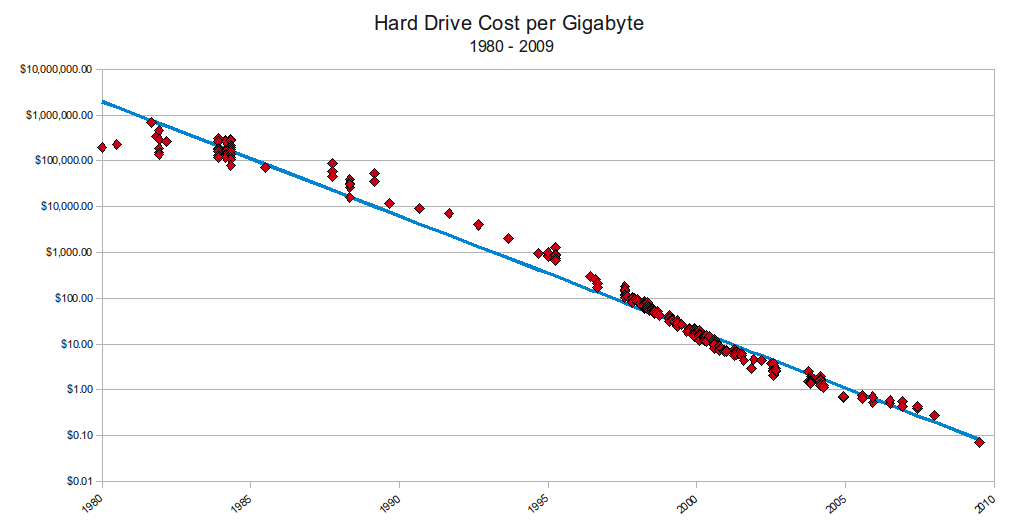

Your numbers are great, even though math is hard. Using numbers like those, I think we could say with certainty (in 1985) that the personal computer industry will be a complete failure!
It's so strange that I so often see many people in this country (the one that once put a man on the moon) say something cannot be done, it's impossible ("Not going to happen") ; while other countries are actually doing it today!
(Be it energy, or healthcare, or many other issues)
The problem with the “predictors of more research” is Jay they cherry pick their examples .
Any new tech that is practical and has market demand . There is a steep ramp of improving performance and declining cost . Airplanes, computers , vehicles , microwave ovens for example .
The issue is however as the tech matures the gains hit a knee on the curve . Costs rise much faster than the increase in performance .
The wide eyed in love with the environment and all fossil, industry and vaccines are bad crowd . They don’t want their dream of solar power and electric everything spoiled with facts .
You can research all you want but you will not find more elements on the periodic table or break the laws of physics . For instance the sound barrier was broken seven decades ago . Modern high tech aircraft are still limited by the sound barrier for practical priced flight .
