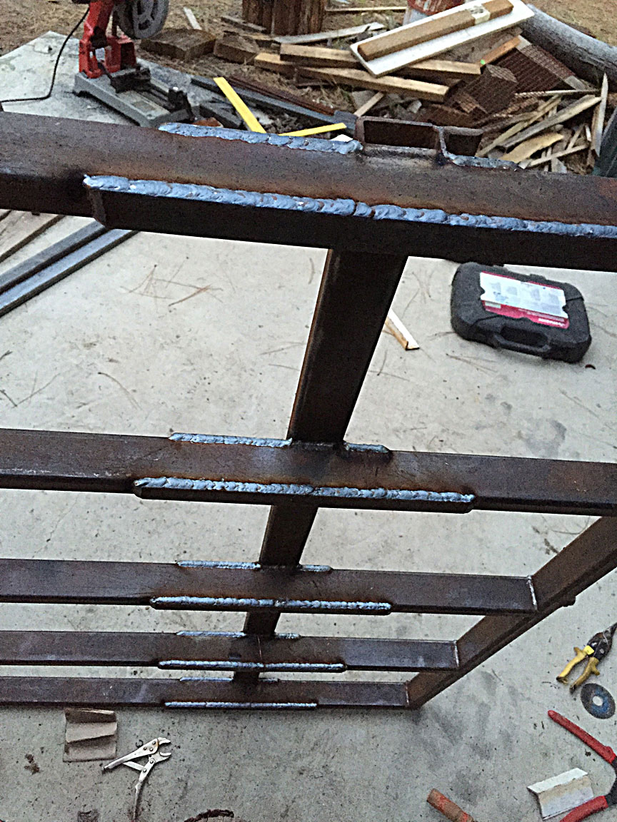

I've seen "duty cycle" mentioned as if its a important consideration for a welder (even for newbies).
I hardly ever have to weld more than a few inches (6" ?) at a time, then I pick up a grinder or do some fitting. Cut stuff, drill holes. Or screw around. But my welder always gets time to cool down.
Yesterday I had a project where I was welding 1 x 1/8" x flatbar doublers on to increase the bending section of my brush fork tines. I decided to fit and tack everything, then go and weld continuous (as possible) until the machine shut down. I am using a Miller Multimatic 200, which has a 20% duty cycle. It's rated for 3/8" thick steel, and I had it set for 3/16" thick. When I bought it they said it will weld at full power for 2 minutes then may require 8 minutes cool down.
At this less-than-full power setting, I welded for 25 minutes straight, only letting go of the trigger for enough time to move to the next weld, and flip the device over once. It never missed a beat. Except I was pretty beat after 147 inches of weld.
I don't know how much longer I could have gone myself. My conclusion is that the duty cycle of my Miller MultiMatic is certainly "sufficient" for my usage. So here's my question, why would someone (non-pro welder) think a 20% duty cycle is insufficient?

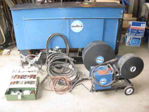

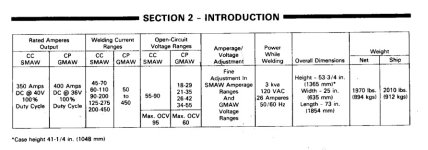

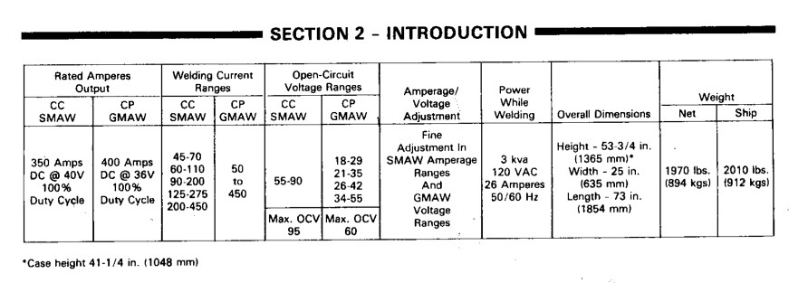

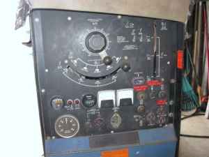

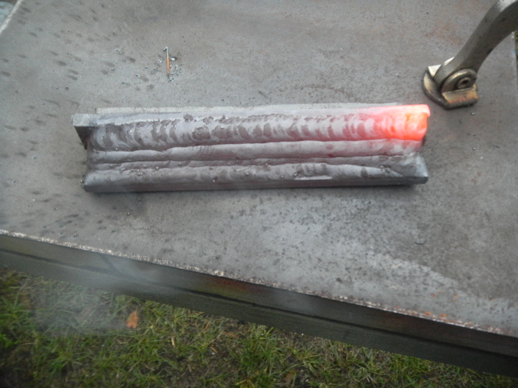

I can't ever remember having a duty cycle problem with a welder. When member here roadhunter had his 120-volt Mig machine shipped to me I did an endurance test on a 15-amp breaker.
In the late 1980s when we built the Alaskan ferry terminal in Bellingham. I got stuck welding down the pre-cast concrete deck panels. I rented my Miller Trailblazer 55D to the company. I was running little over 500-amps, burning 70-pounds of wire a day. Making 6 on 12 welds. Machine never missed a beat.:cool:

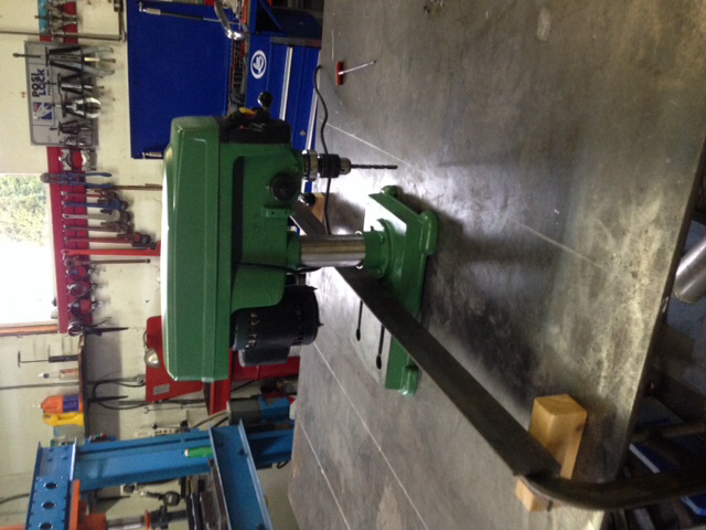

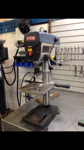

Nice. A Hougen is def on my wish list. In the mean time I picked up a used cheapo Ryobi POS for $20 and lopped 8" off the column.
I used it to drill 5/8" holes in my welding table (á la welding web). Couldn't use my annular cutters tho....
Terry
Terry, you do know they make a adapter to use annular cutters in a drill press. My large craftsman actually has a 3/4 chuck I can put a annular cutter into.
