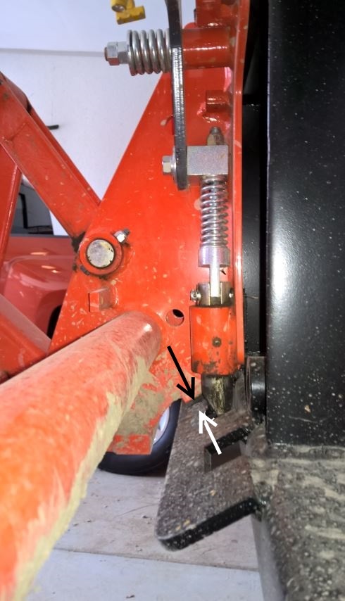

The main thing is the gap to the plate needs to be very small, this gap is too big and the pin is not touching the plate:
This pin is well seated:
   / Question about quick attach spring loaded pins
Exfaxman, thank you, I don't have any gap. The reason the pin isn't going in far is because it is hitting the plate. I'll try it a while, I can always take some out with the plasma cutter later on.
   / Question about quick attach spring loaded pins #6
You're welcome. With no gap the pin doesn't need to go in very far.

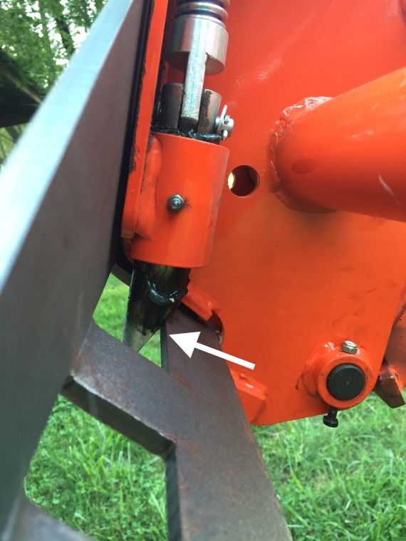

First comment is, since you are not familiar with using them, the tapered latch pins need to go firmly, very securely, into place or all sorts of havoc can happen. Main thing I think is to make sure the levers that lower the pins are all the way down and way past their "over center latching point" in travel so they stay down. Many times I have had trouble (using a skid steer bucket, a FEL mounted hydraulic cutter, etc. on my farm tractor) getting the latch pins to go fully down. They are not an interference fit but do tighten up with the sloped contact surface. Very common to need to stand on the lever to get it the rest of the way down when arm strength just isn't quite enough. If the levers are all the way down you'll be OK.
Here is another example of the latch pins in use with a skid-steer style bucket being mounted on a FEL frame via SSQA adapter. You may need to blow up this picture a bit to see well:
Notice that these pins are fully engaged but probably only at about half of the sloped surface point on the pin, if that much.
I think that the skid-steer interface is so well standardized that no manufacturer would dare be "off" on the dimensions of the holes, spacing, or plate retaining top pockets. I would not worry about that aspect at all (be it with Titan or whoever.) Large numbers of them out there, strength in numbers.
