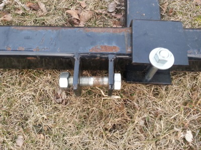

Here are a few pictures of the Forks I had built. The fab shop built this for $400 including paint a couple of years ago. I misstated the fork size in my earlier post - my memory is failing. The forks are 4x2x.156" wall. Also the Cs to attach the forks to the tubes are on top of the tube as shown. As you can see by the photos the ends are all capped for no water, i.e. interior rust. The tips of the forks are tapered as well. I have not weighed them. They are heavy but I can pick the assembly as shown and carry it so am sure they aren't over 150 lbs. I just used bolts for tractor connection for cost reasons but I use them so much I wish I would have put standard pins in.
I like the way they are built. :thumbsup:
Just go buy two standard pins now, and be happy! :D

Again, thanks for the headsup on this nice design.
You mentioned that you wished you had used pins.
Do the bolts offer any tightening force or only serve to lock the
c-clamps iin place? Pins would provide the same fundtion as the bolts?
What thickness steel did you use for the c-clamps?
Picture 1 and 5 are overall views. Pics 2 &3 are close-ups of the Forks attachment to the frame and the connection for the lower 3 pt arm. Pic 4 shows the tapered end of the fork.
