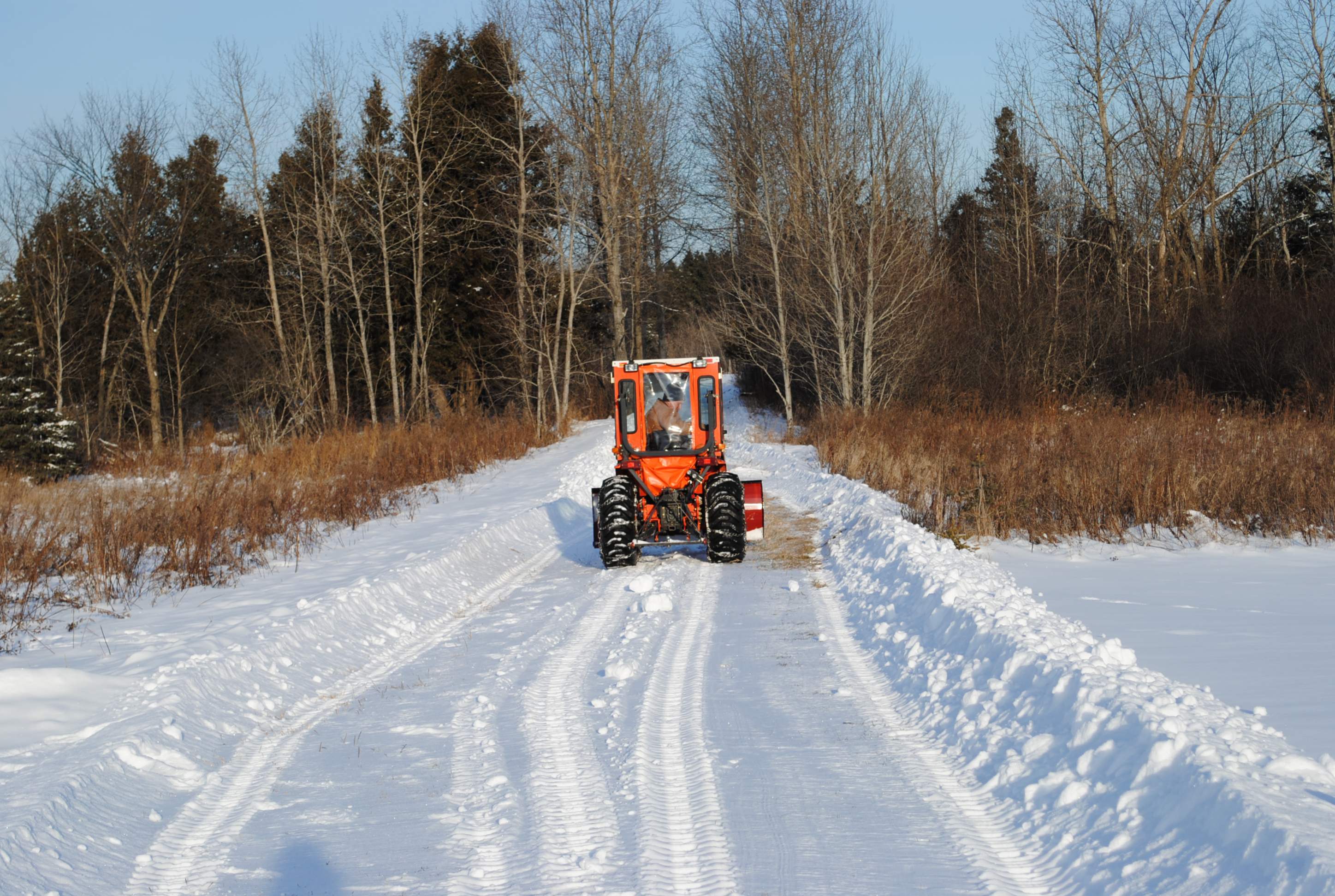

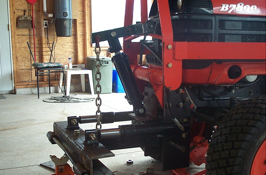

That’s very true "deathtoblackberries" (now thats quite a name BYW), for example, (talking snow removal, home made snow plow made in 2009 on front end on my B7800) I have received the answer I was looking for from a TBN post after weeks of trying to figure out why my installation would not work. The hydraulic cylinders would not work properly, they were locking-up, I was using 2 single acting cylinders to angle the blade. Nothing I tried would work. I was using the existing FEL Kubota supplied hydraulic valve, which I found out by reading a post was never going to work on single the acting cylinders I have installed due to a special hydraulic circuit used on during the dumping action of the bucket, called a bucket regenerative flow valve. We all learn from each other on TBN, a great website & very useful tool, not to mention like-minded people.
Here is a shot of what I used to clear snow for years and the B7800 is same as B2920, very strong and reliable.

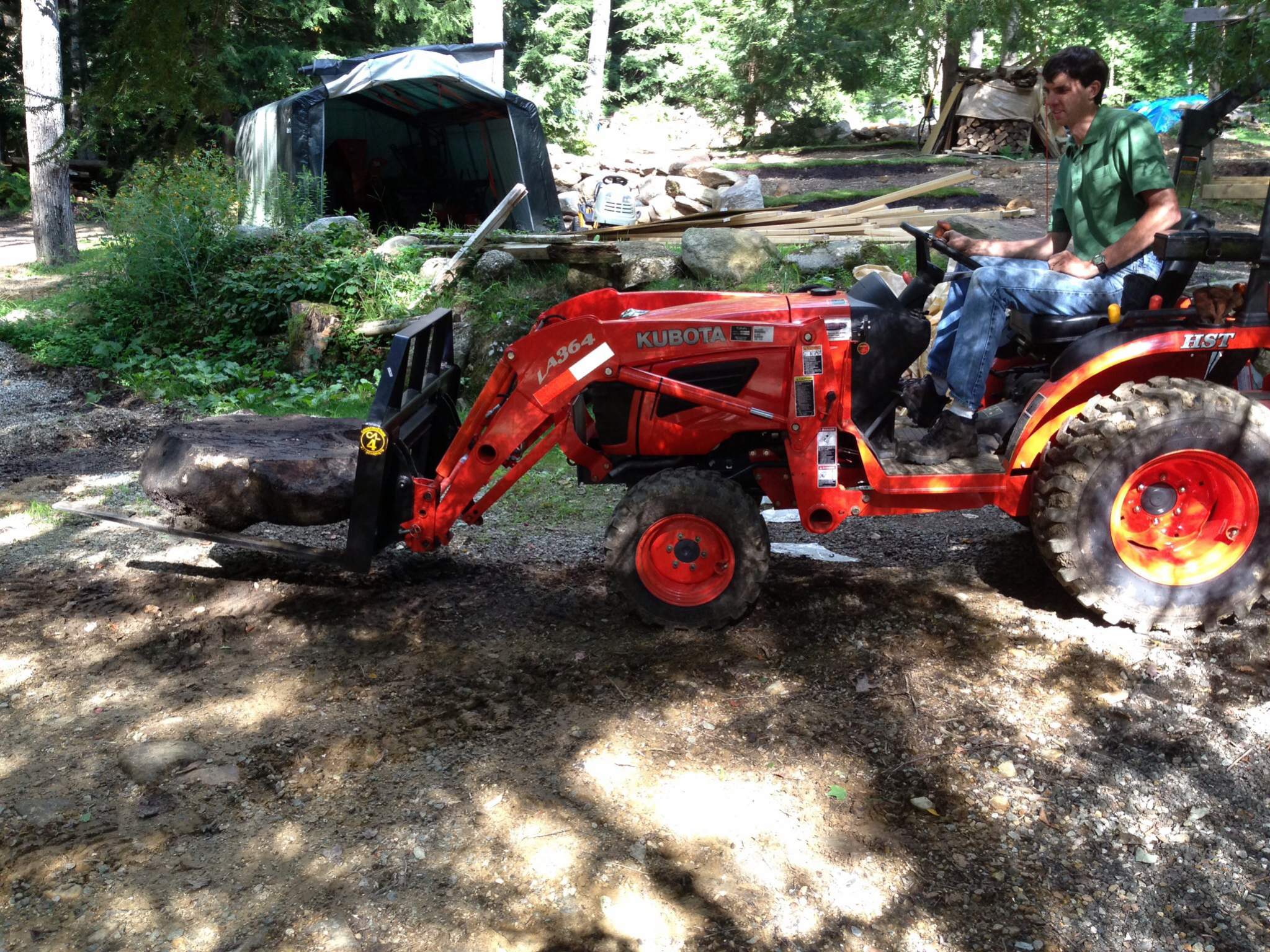

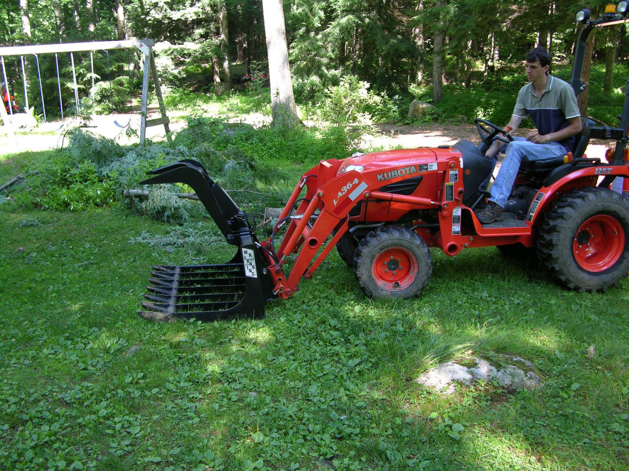

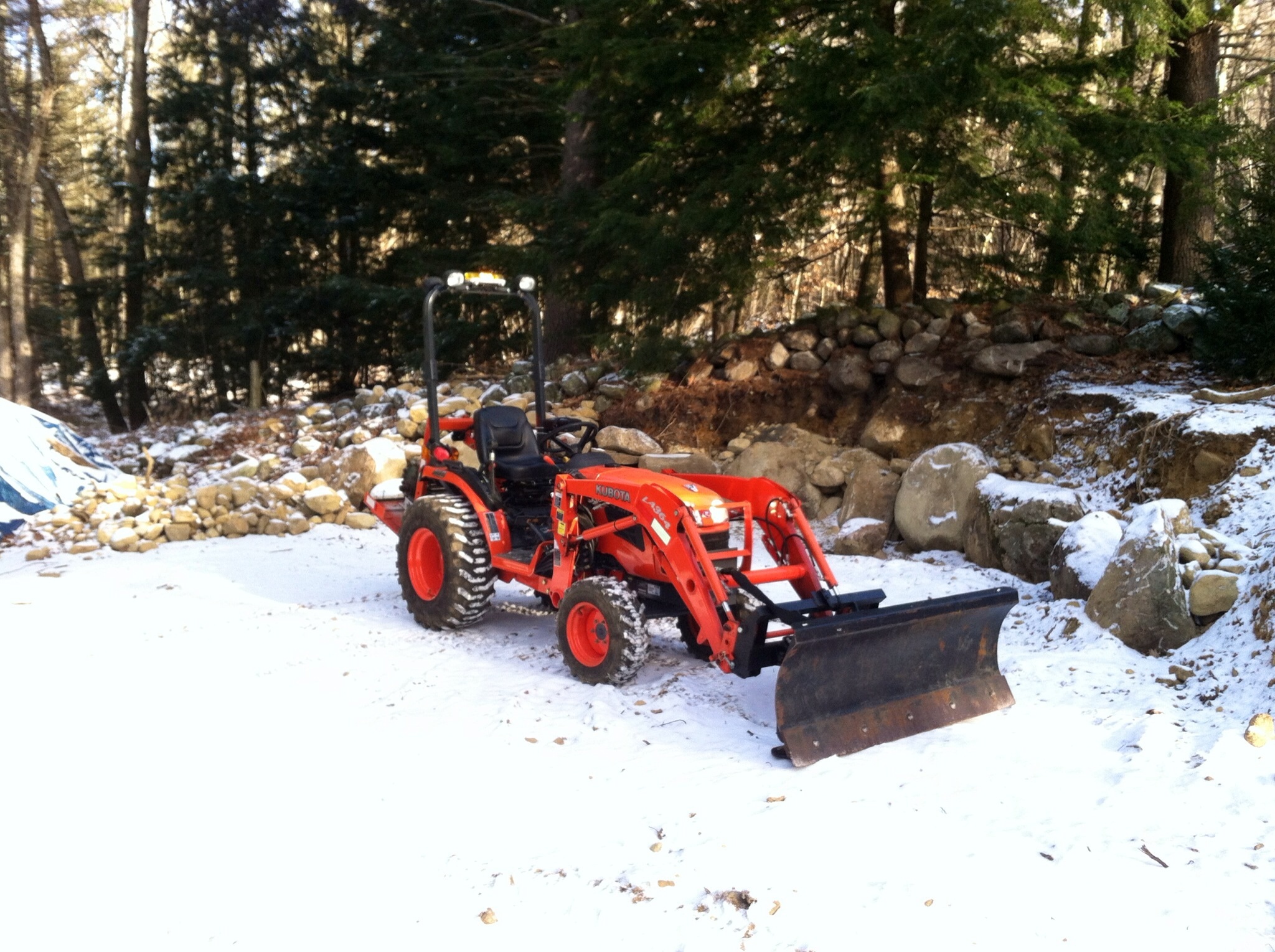

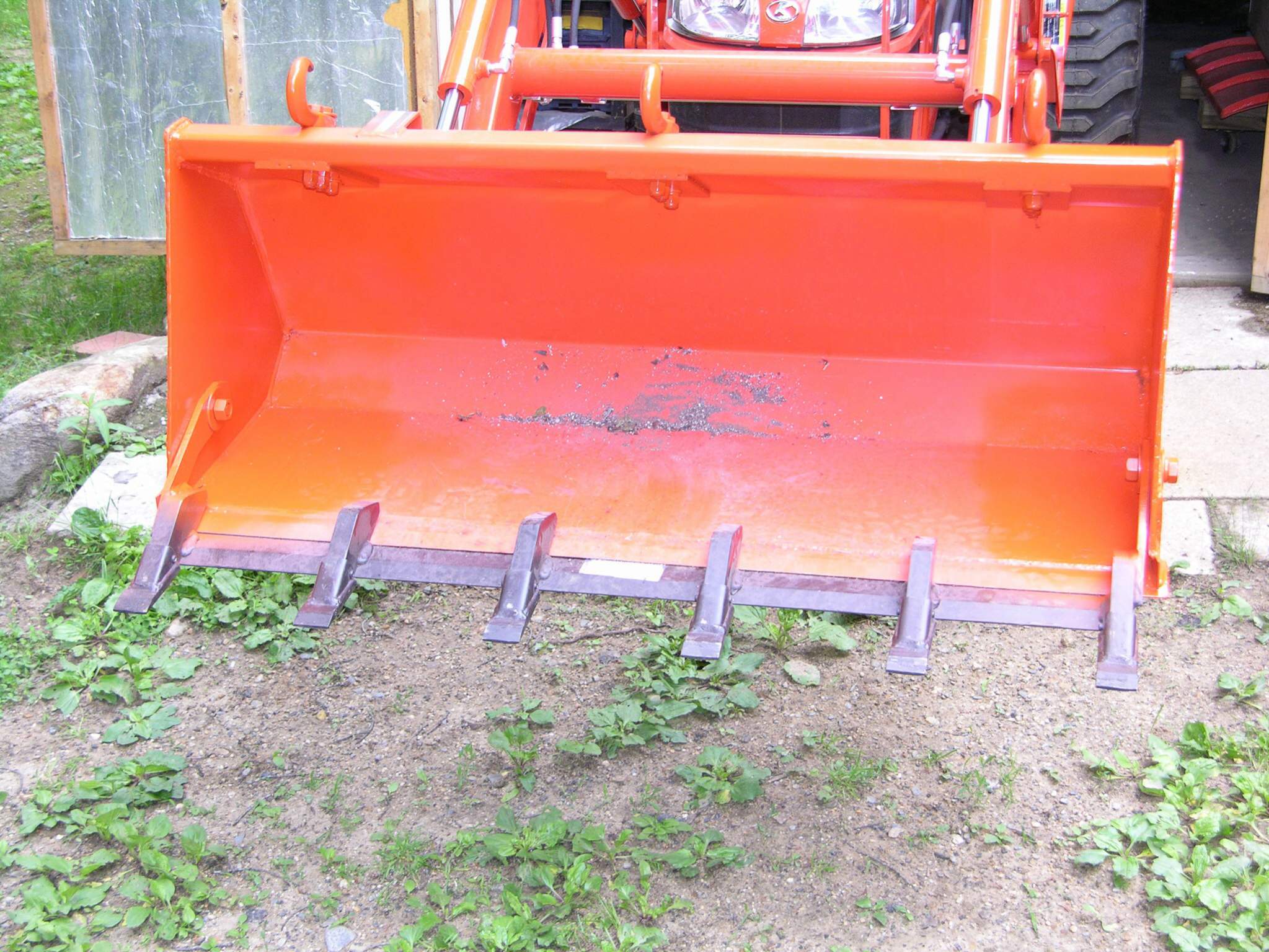

I have the quick attach on my b2626 TLB and I can lift the same weight as with out the quick attach. I have four attachment i use on the loader. Standard 50" bucket, pellet forks, 48" open bottom grapple,and snow plow.

Cal......I'd say that you have the ideal set up. I had a BX without a QA and it really was a pain to "pin on" the pallet forks. On my B2620 I just went with some clamp on forks. Your front hydraulics and QA make a world of differance...I'm envious but plan on getting along as is. Cheers, Mike
