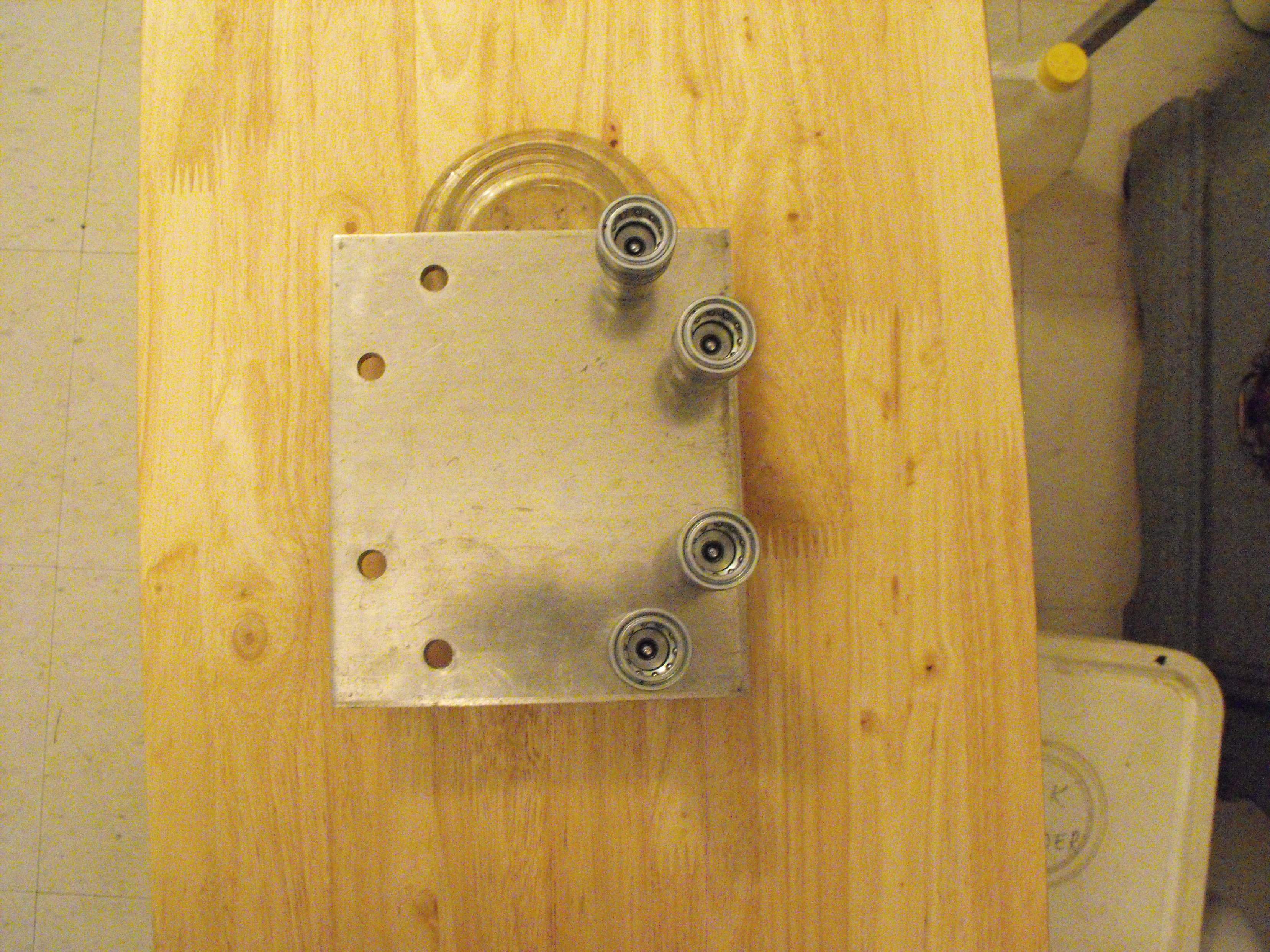

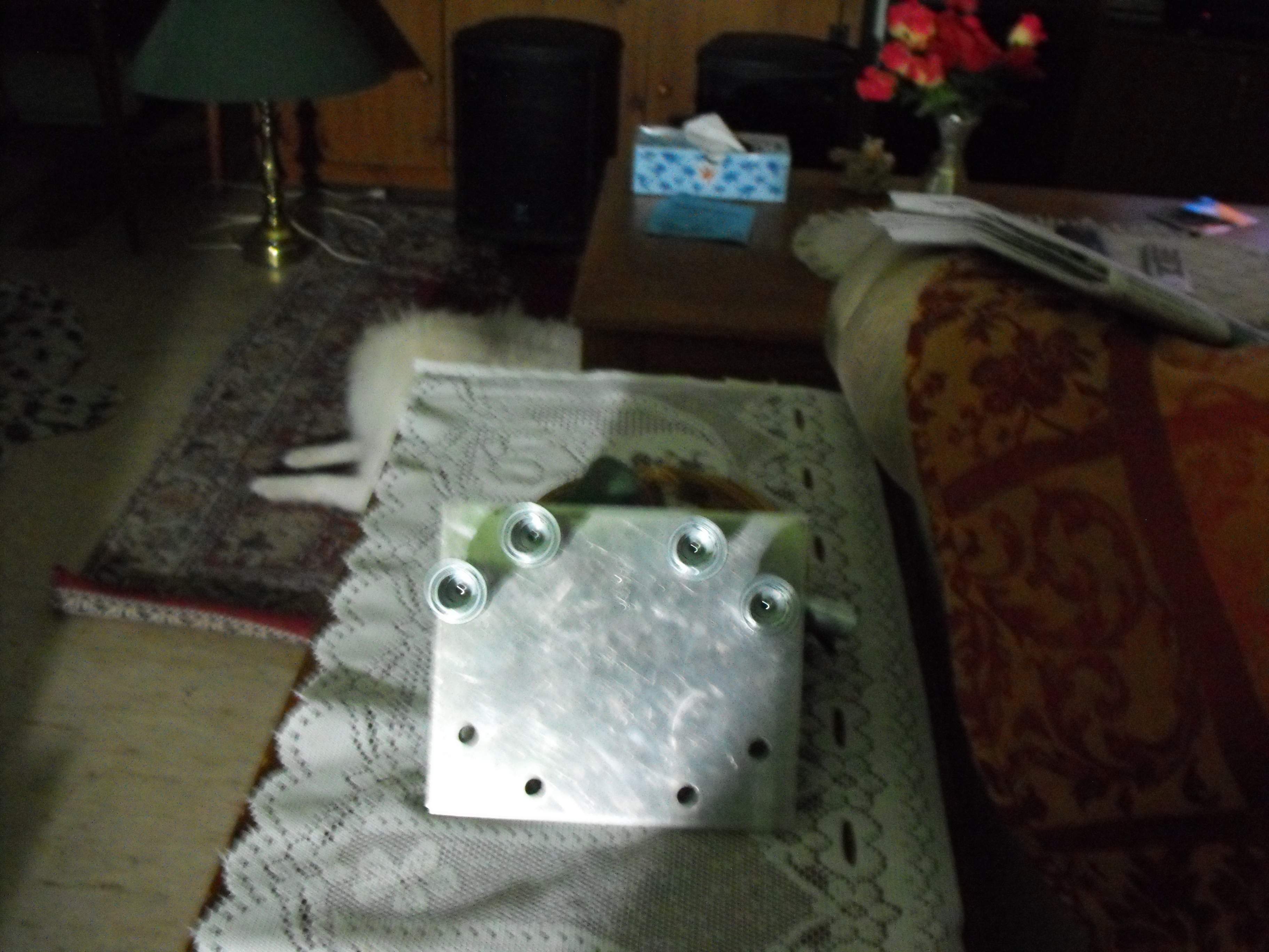

I picked up my 3 QD today also on sale.... both the male and female ends....I'll need some help on where to install these.
maybe bring the rubber HP hose to the front of the tractor and add short hoes to the two rams/cylinders I guess....I'm wonderin' if there is a bracket available to mount to the side of the tractor 3 or 4 QD.....if not I have a 1/4" piece of aluminum I could make up my own bracket..... first I'll check if one is available.

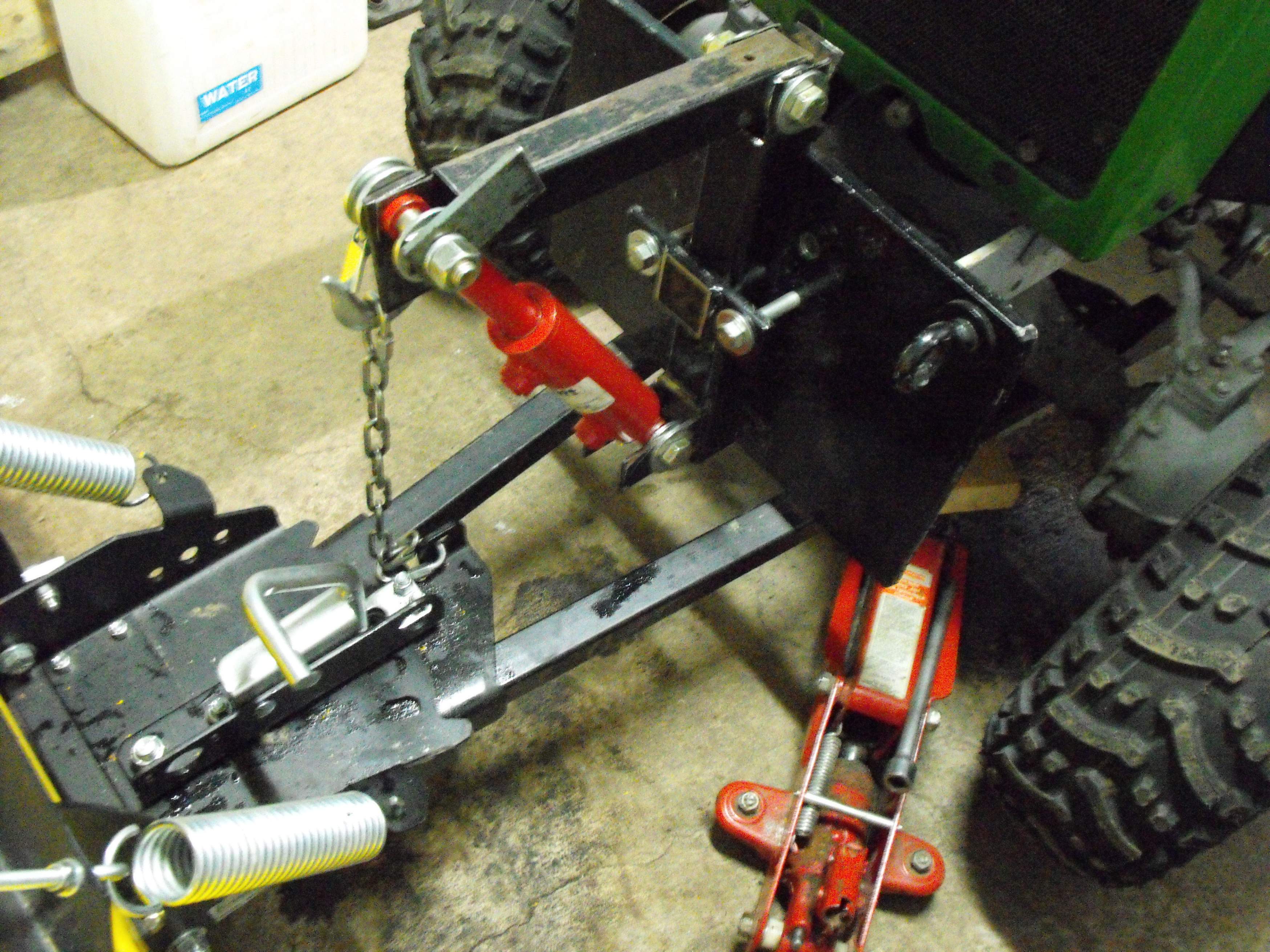

I don't knowif this good news or bad news on my part !....stat the bad news first....which is.... the Myers ram/cylinder I bought is for a 1/4 " or more heavy gauge steel 7'-8' snowblade designed for a heavy duty 4x4 pickup truck....
My little ATV 4' made from approx 1/8" gauge does not have enough weight to pull down the Ram/cylinder even with all my 145 lbs standin' on it......so back to PRINCESS AUTO and get a double actionram/cylinder.
.....now I'll be usin' two double action rams/cylinders....and usin' all 4 ports....so maybe this will remove all the confusin' thats been a sort of an issue from the start of my hydraulic setup....
I finished up cuttin' and drillin' then connectin' the hoist frame(short boom) and this is when I found out I had added problems with the Myers ram/cylinder....anyway guys I'm off to return the ram and buy another QD...cause I only bought 3.....maybe everything will come together now with the new changes....
just posted two Pics of the new double action ram/cylinder plus the completed chain lift (short boom setup) ( as you can see I still need to weld the side brackets....plus 2 pic's of the 4 fitting QD bracket..... first QD fitting is installed the others are just sitting on the 1/4" aluminum plate....I forgot to pick up the other 3 swivel connection fittings.....I never dreamed there were so many extra parts to buy...seems like it's never ending.....take care<<<>>>>>>Ampa
