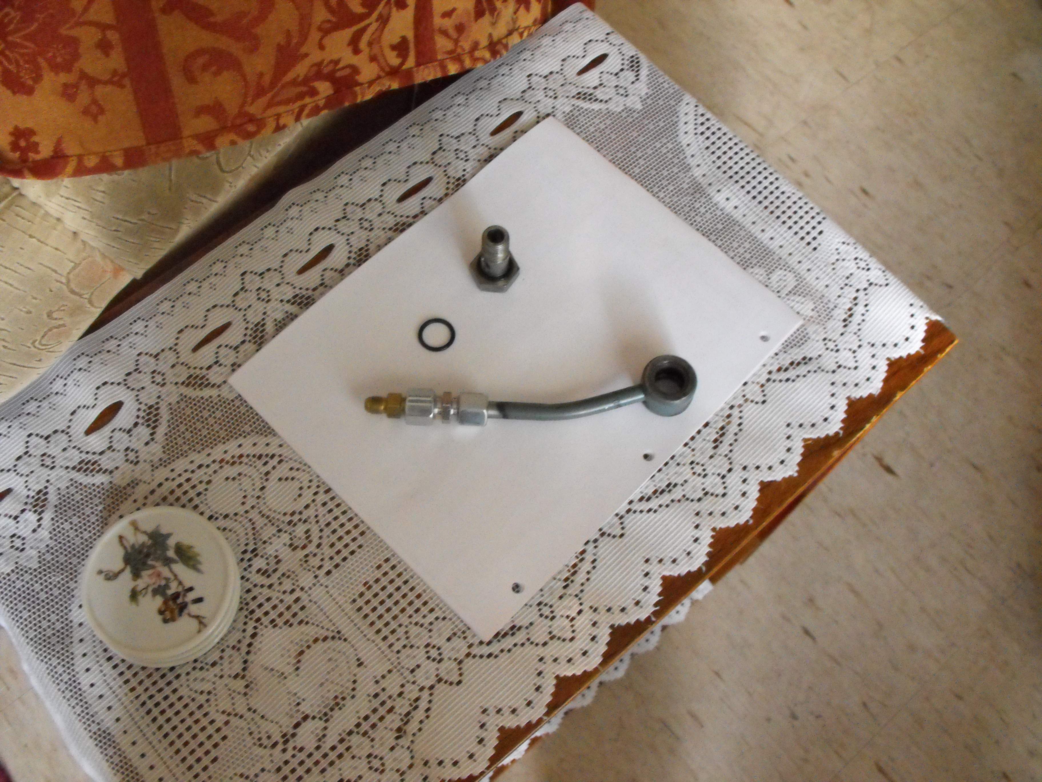

I would have thought maybe buildin' a bridge to cross.......anyhow Donnie you have sent me the complete info I was lookin' for...I've since printed this info out on my like new but new to me and only slightly used $25 brother b/w laser printer that I resently bought off Kijji free ad's.my old HP 2100 LaserJet printer only needed a new $100.00 plus tax b/w toner cartridge....anybody need or want a free HP laser printer ? :D
there are some darn good deals on this Kijji ..... if you see something at a good deal..... act fast or you lose out I nearly lost out on this one so I paid him his asking price of $25 seems someone was coming for it the next day to give him $20 for it... back to this snowblade installation issue....which seems to be coming along nicely with pics sent to me on how to do all the fabrication part of it...I will be hard copyin' this info as well.
Even though no more questions to ask....I'll still be postin' pics of my progress to the end....would love to send a video of me ploughin' snow this winter....but I have no one to run my new HDD video camera....
maybe have to settle for digital pic's of the beast doin' it's thing...as always Donnie....appreciate your sincere interest and most of all... patience.... you too J_J and anyone else I may have left out for helping me over come this hydraulic issue of mine....as always....take care <> Ampa <> :thumbsup: : :)

Checked my bank account and found some extra $$$ in my account.. went down to the gararage and cut the the one hydraulic "P" line.... went out and bought the two compression fittings. I was short a bit over $6 so they let me off this time....the tractors steel line with the large bolt/bolts to.... facing either side of the axle cast iron housing.....there's two "O" rings one one each side.....I may have to replace them........posted a pic.....Ampa
