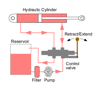

Here is my recommendations. Obtain two fittings for the small hyd line from the pump. Install the two fittings, one to put on the cut line going back to the 3pt. Cap that small line going back to the 3pt, since you will not be using it.
The other fitting should connect to the small pressure line from the pump. If you will not be using high pressure downstream, plug the PB port.
Obtain a 3000 psi pressure hose that will have fittings to connect to the pressure line fitting, and then connect the other end to the "P" port on the valve. Either add a gage to the other "P" port, or plug it. Obtain 4 hoses for the work ports of the valve to the hyd cylinders up front. Obtain a return hose, could be the same pressure of the other pressure hose. The return hose connects to the "T" port, and goes back to the tank/reservoir.
If you are going to use the 3pt for anything, do this.
Install the PB sleeve, and connect a 3000 psi hose. The other end of the hose from the PB port, will go to the fitting that you installed and will carry hyd fluid to the 3pt. Install a 3000 psi return hose from the "T" port to the tank/reservoir, this will carry the expended fluid from the cylinders.. After connecting hoses to the front cylinders , the circuit will be complete.
Just a basic circuit below.

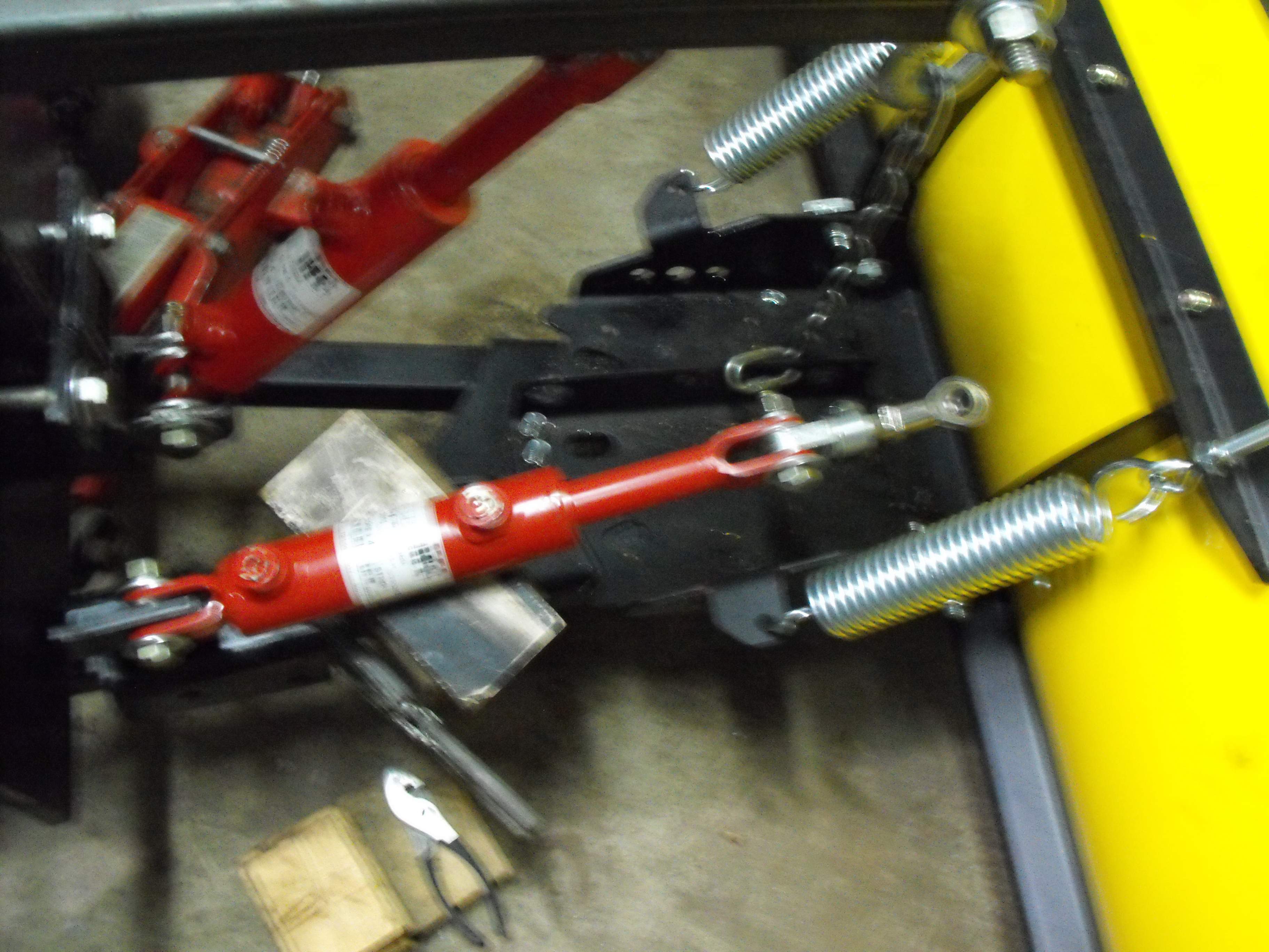

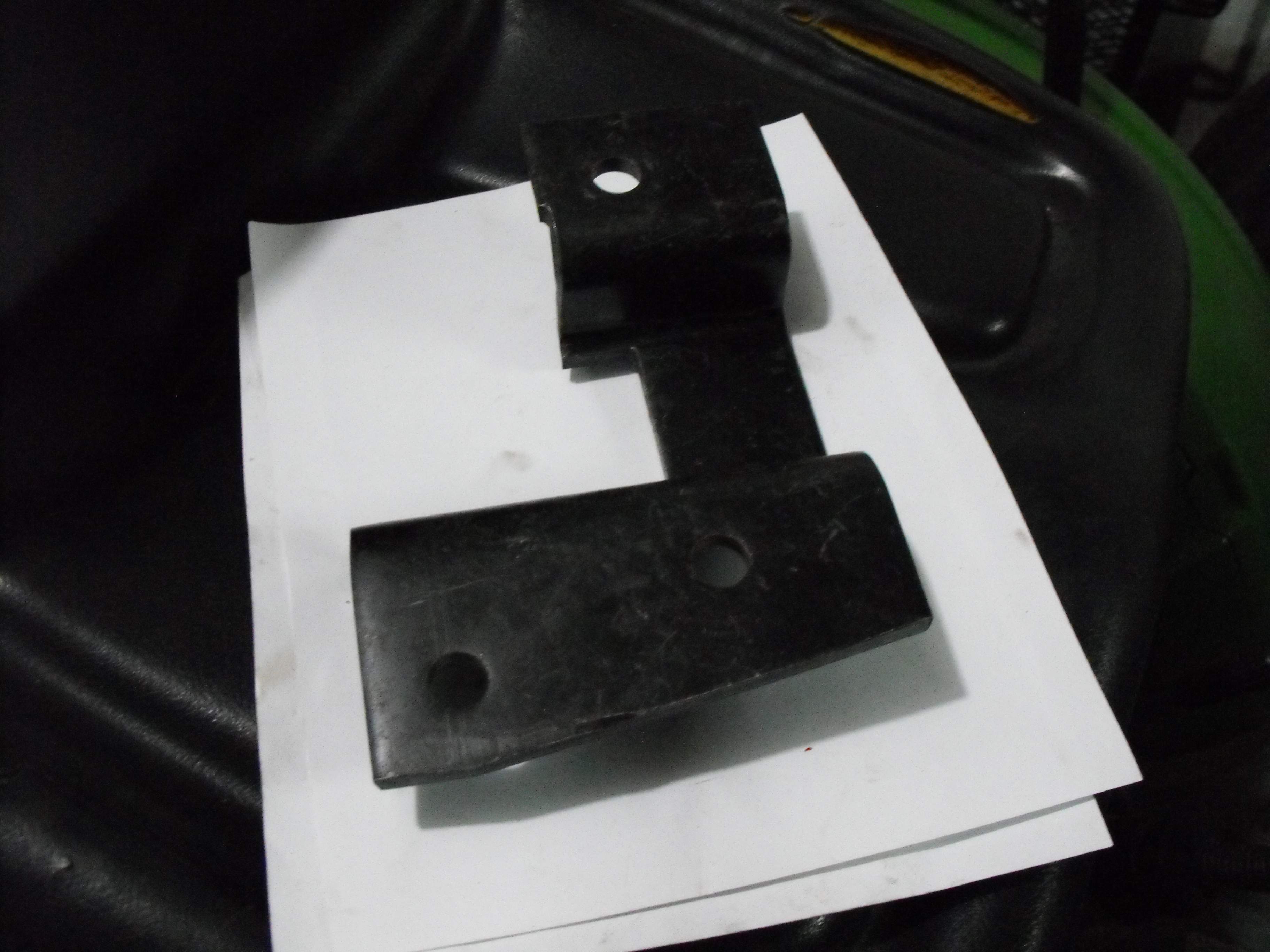

I earned some extra $$ this past weekend so I decieded I'd buy the other cylinder/ram I needed for the angle part of the blade @ PRINCESS AUTO while it was still on sale for $102 tax included....so total price of these two cylinders comes to only $204 including tax (@ only 13 % HST)...
some people refer this new HST as the Harpers Sales Tax..... I think we really get shafted with a higher rate of tax % on everything...and I do mean everything....which now applies to our services/heating/electricity etc. here in Canada.
whats the tax % cost on goods in the USA these days?... anyhow now I can go ahead and completely connect the whole system up rather than wait till later.. now there be no need to install plugs and maybe eleminate some or most of the confusion I've created on this hydraulic issue....I'll post some pic's installing this second cylinder/ram...Thank you David.......take care<> Ampa

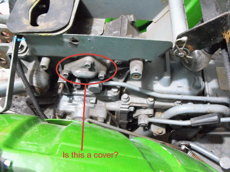

Ampa, I'm going throw another curve ball at you. Looking at the picture you posted, there looks to be a plate with a channel under it. On my Kubota to install the FEL, you remove a plate like this and replace it with one that has two threaded holes drilled into it, one for pressure and one for return. I've seen tractors that when you remove the plate, the ports in the side of the tractor are threaded and you screw the fittings into these and throw the cover plate away.
Donnie
