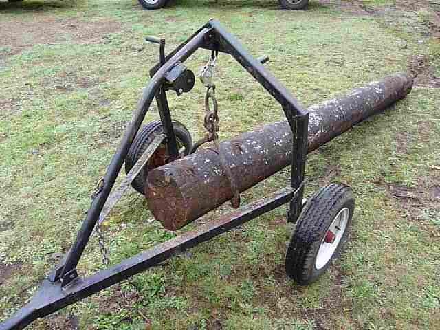

Most log arches don't have axles or springs, just a spindle welded to a vertical frame.
Here's one from the internet.
More:
small logging arch at DuckDuckGo
Bruce

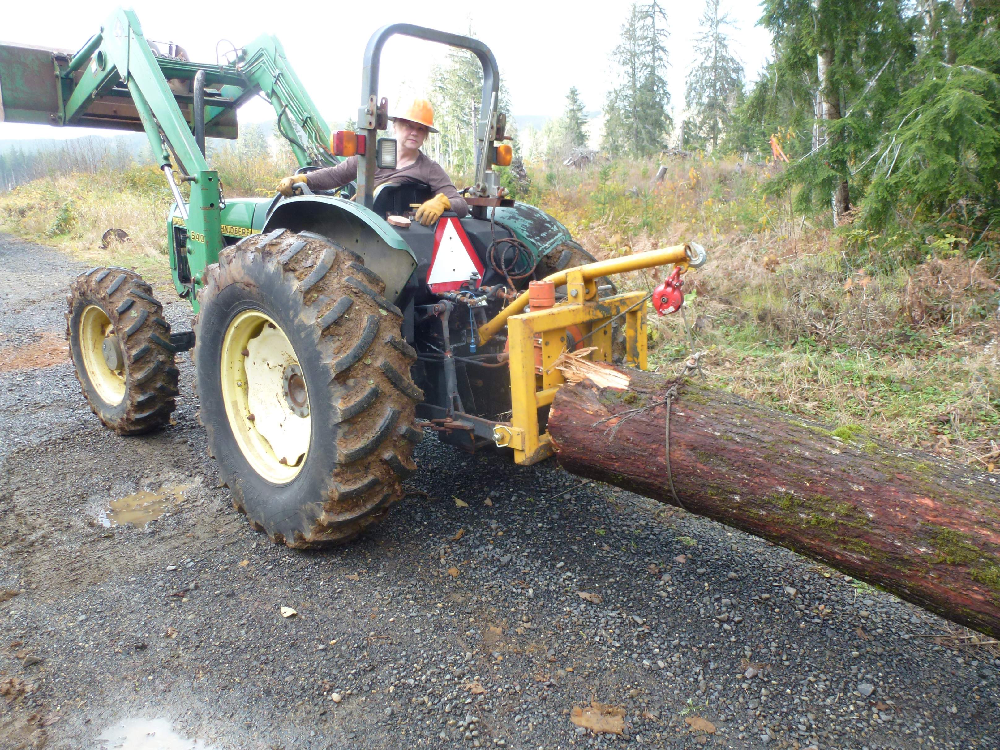

Here is mine at work.
Yes, mine will be similar to that. I saw a Youtube build of one where the guy left the axle in while building it to keep the wheels straight and then after it was welded up, he cut the axle out of the middle. I was going to do something similar but didn't know if the springs would help or would make the log bounce too much.

If you can enlarge the photo you will see there is also a hook on the end of the boom. I use that to hang a set of tongs on. With this arrangement I can hit the ground with the tongs and still pick them up over 4ft as the boom pivots on top of the winch frame.
Arches do not need springs. having the frame extended back behind the tires will create an issue in tight turns. Besides, logs don't need a cushy ride out of the woods.

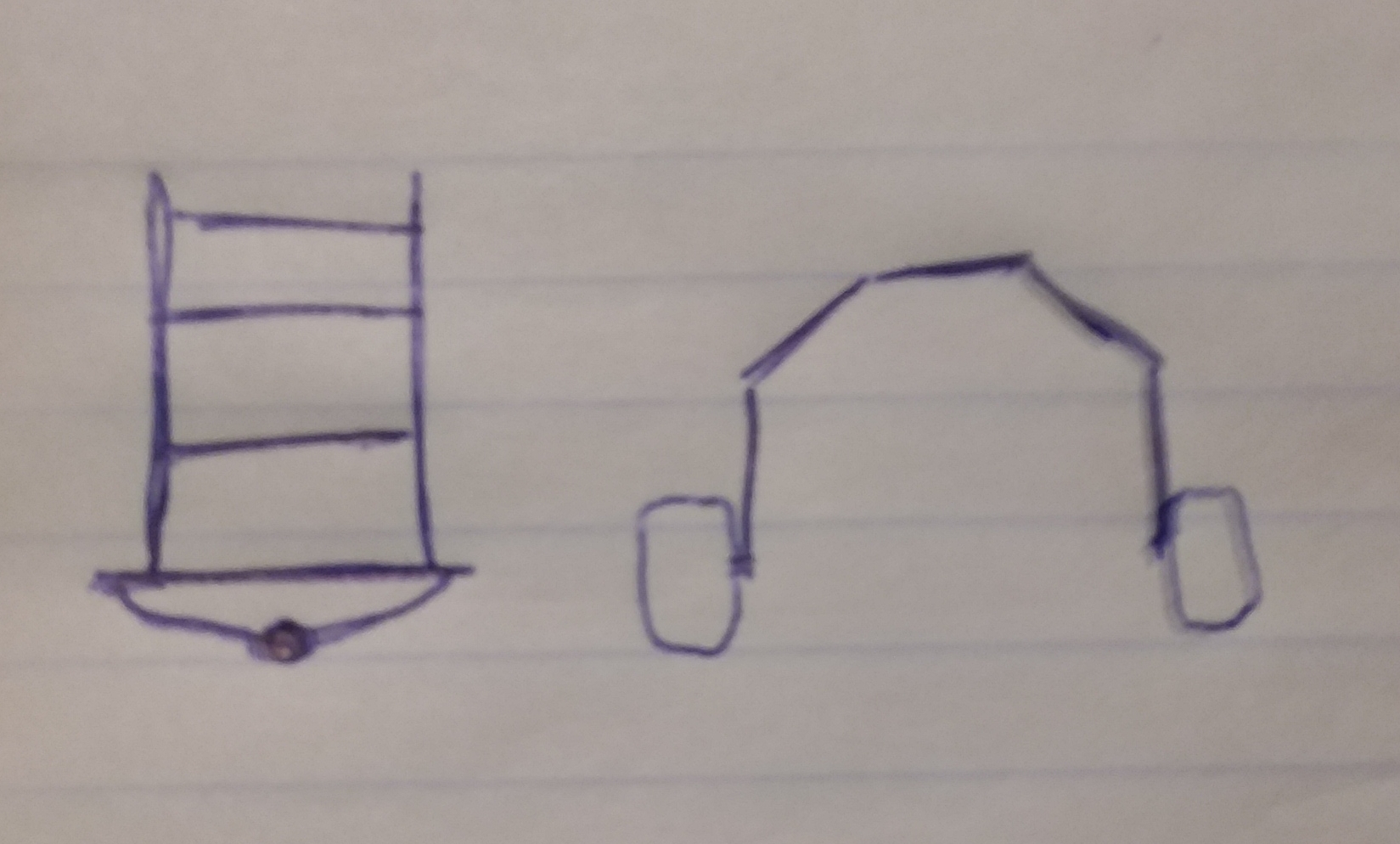

I like the boom pole idea, that's what I was thinking on the tractor end with tongs to pick up the log there. I didn't see the hook Plumbstraight..... that looks like a versatile way to go. What I've scrounged to build this out of is some type of ladder material..... I think it was an old scaffold. I'm going out of town, but I'll try to post a picture after I get back in a few days. But attached is a crude drawing. I was going to weld a piece of C channel across the bottom of that, then weld the spring tabs onto the channel. I forgot about the twist of the wheels, though after I cut the axle out. So I'd need a plate on the end of the cut axle tube welded to the channel along with a gusset, or something to that effect. Which renders the spring useless anyway. So I guess I can get rid of the springs. :)

Do not put springs on your arch, they serve no purpose at all. Your arch needs to be rigid.
