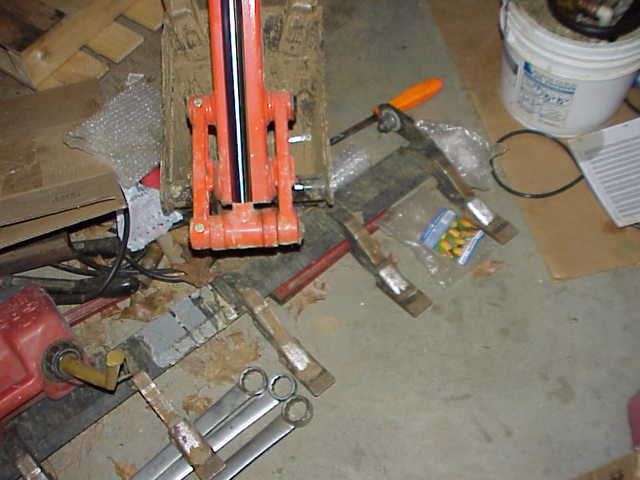

I have a tooth-bar for my BX22 LA210 (virtually identical to the LA211 that is used on the BX1800/2200) loader and it is presently located in the garage on the floor. Haven't put it on the tractor yet this season, because there is nothing that I have found that I need it for. I have standing piles of loam that I purchase a few years ago. I buy them from a local farm that mixes manure into the piles, so I let them ferment for a while before use. My loader has no trouble digging in these piles that have been in place for 2 or 3 years. I can tell you that if I try to dig a pile with a shovel, that I will tire long before I get a wheel barrow full. The Kubota has no problem digging at all. In the morning I will post a picture of one of the piles that I dug in last week. The walls of the pile are still vertical from where I took out material with the bucket indicating that density of the pile. Don't underestimate the power of these little dynamo's of a tractor.. /forums/images/graemlins/wink.gif

If you want to dig out sod and reuse it, the tooth-bar will destroy it. If you don't care, then the tooth-bar will be great and make the job quick. Part of the trick of digging with the bucket is technique. This is something that you learn, but can't be explained or taught by reading a post. I have filled bar tires and they make digging a lot easier also. I have also filed a sharp edge on my bucket by doing snow removal with it this winter. It digs better this spring than when it was new. I believe that it is the sharp edge on the bucket that has made that difference for me. It also might be a senior moment not being able to remember last fall by comparison. Either way, you will love your new tractor and will rapidly learn to use it to its full potential. I had to go out to the garage for another picture, so I snapped one of the tooth-bar. If it wasn't so large, it might have gotten lost on the floor.... /forums/images/graemlins/frown.gif Cleaning that garage floor is on the list for the next rainy day. /forums/images/graemlins/crazy.gif
