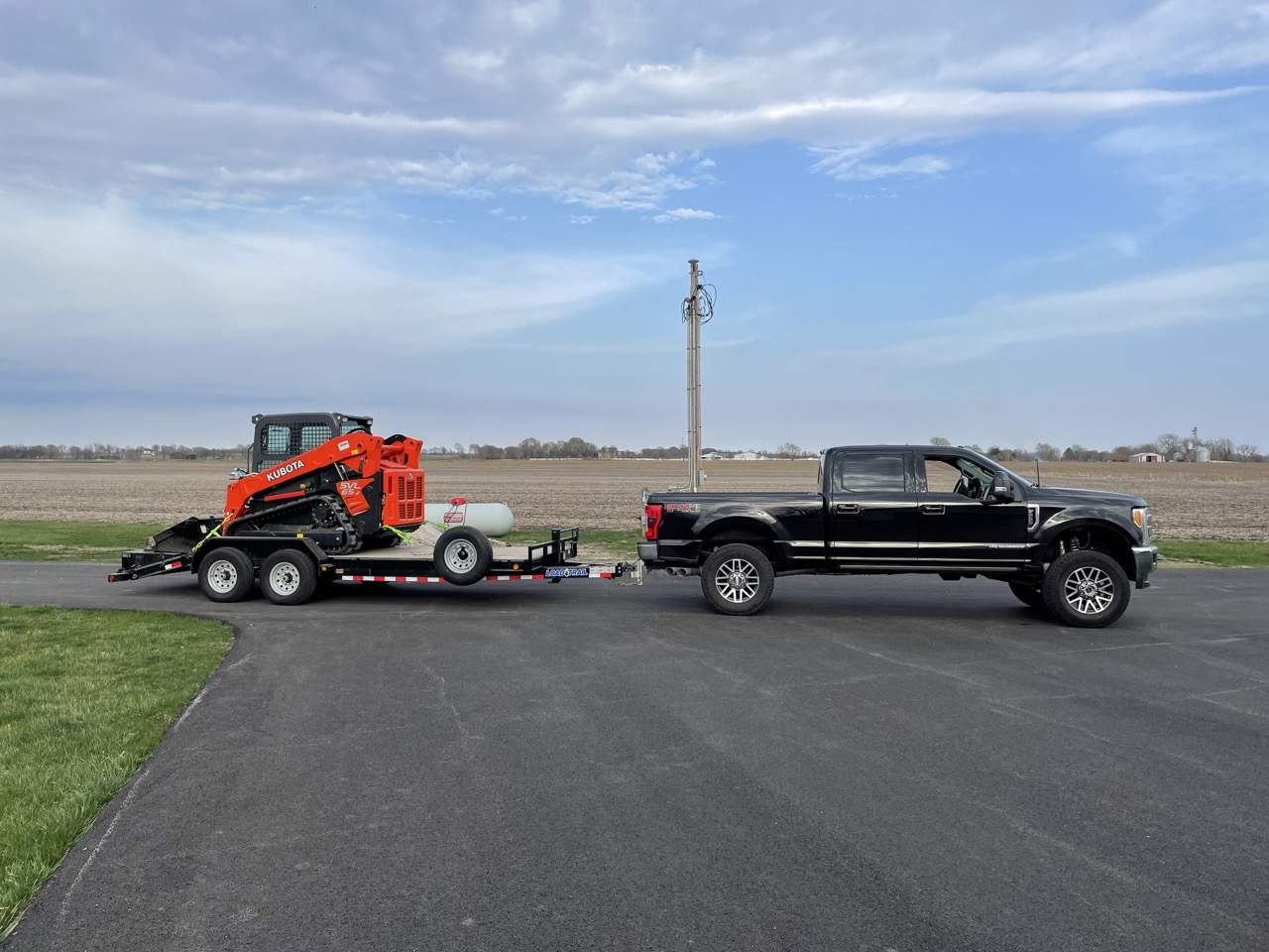

The original poster stated a 7500lb weight limit on his trailer. That basically limits you to a smaller wheeled skid or tractor. Not positive but pretty sure l47 or svl75 would put you over that weight once actually loaded with a bucket. If a trailer upgrade was needed would that also mean a bigger truck? In my opinion track loaders are meant to get in and get to work, not the easiest to be in and out of. I think some of those newer compact articulated wheel loaders would be worth looking into. A lot of tree guys in my area use them when handling logs.

A 75 weighs about 10k pounds and a 65 is still exceeding 7500 pounds. I think Takeuchi makes a smaller tracked machine in that weight class.

Yes, both truck and trailer are limited to 10k which means smaller CTL like a Bobcat T450 or T180. L47 would be the max for a TLB. Lots of reasonably priced 10k pound skid steers but buying a new truck and trailer isn’t in my budget.

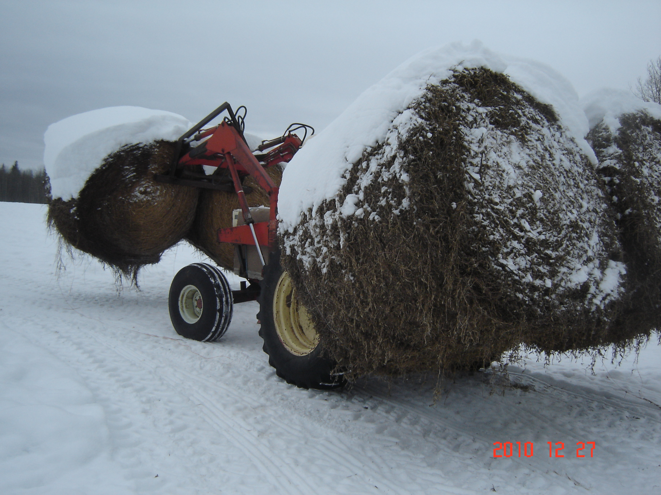

Moving a few thousand bales over 35 years isn’t that much. What if you were stacking a thousand bales a day. Would the tractor still hold up to the job? It’s no question that the tractor loader is built a lot lighter duty than a true industrial loader would be.
I didn't think we were discussing a big commercial operation here but regardless.
Loading and stacking and feeding 4 bales at a time up to 1000 bales a year over 35 years is a bit more than a few thousand bales me thinks.I bought this old 75 hp 2wh dr clonker used with well over 5000 hrs on it. At the time it was my only tractor, it did the baling and all loader chores as well Today it has well over 17000 hrs on it with hardly ever a breakdown save for a few starters and tires.It is my back up tractor today.
Did you ever see another 40+ year old tractor regardless of make do that?
