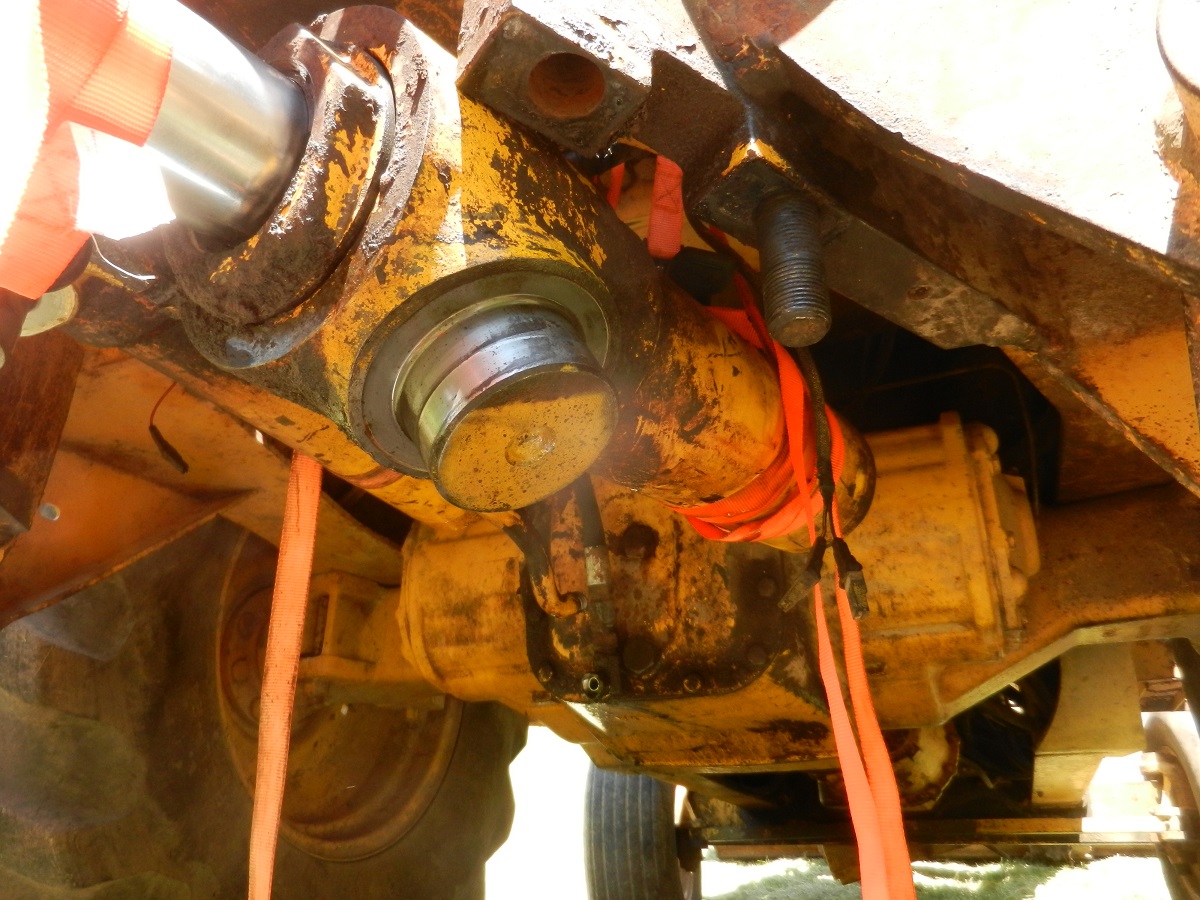

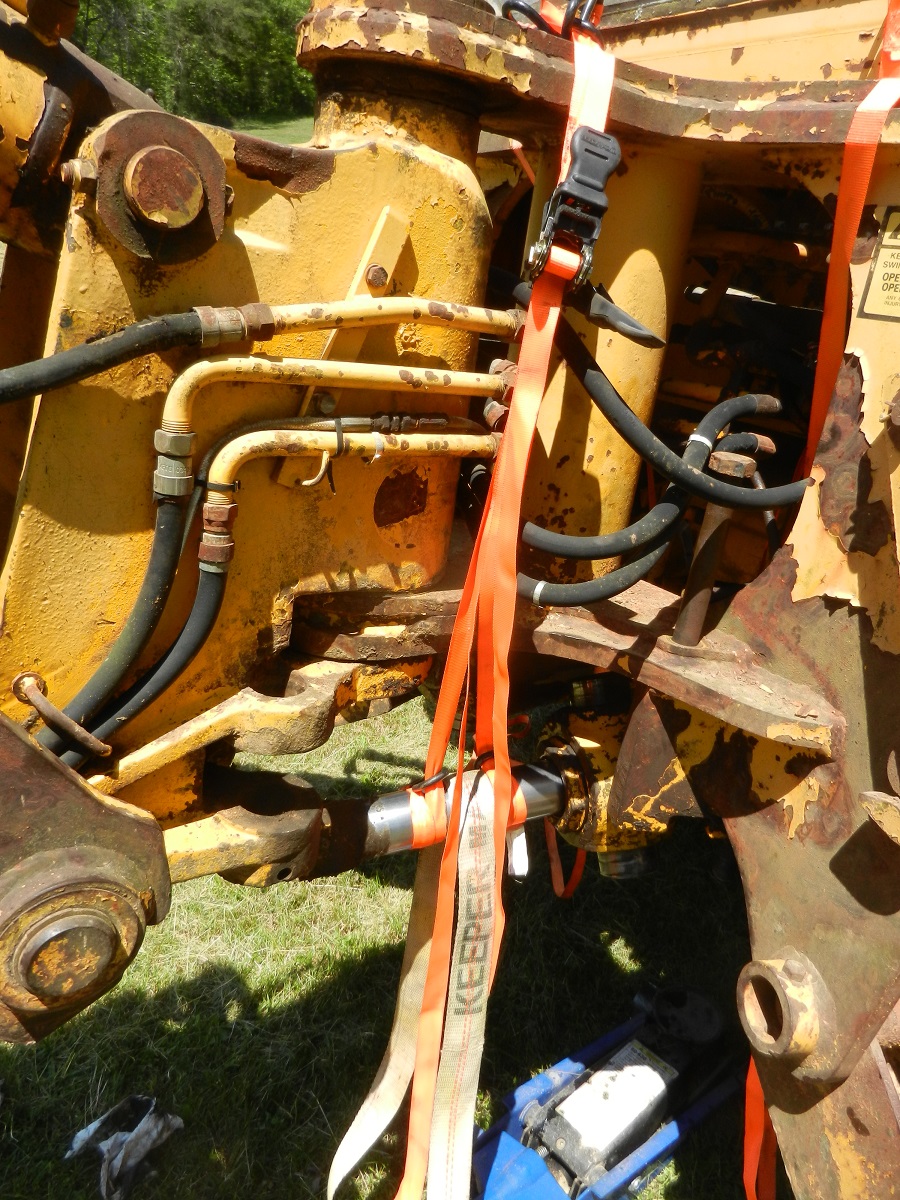

Ok, so the buggers are off.
Put 4 straps around them....2 in front....2 in rear.... used the straps to sort of 'ratchet' them down, one at a time.
Found out that with the ram in the hoe socket (even if not pinned) that helped act like a lock with the trunnion in place. Had to do some twisting & turning to get them out. I think it will be much easier to put them back up collapsed and then used the hydraulics to align with the pins (after they're fully mounted)
Here's some pictures of how I took them down (alone, without any help I might add)
Right now, I'm looking to try to do the same thing in reverse when I put them back.

   / Question on JCB swing cylinders
#42
Ohhh... I meant to add... there are the four bolts that hold the bottom plate in place. I'm sure I could reuse three of them with zero issues. I "think" I could use the fourth but truth be told.... it was a bugger to get out. I'm guessing there was some crossed threads in there but they were minor. My impact wrench was able to handle three of the four (it's pretty heavy duty).
I had to use the pipe wrench with cheater bar to take the last nut 90% off, then the impact would get it.
I might replace all four of them just to have peace of mind.
   / Question on JCB swing cylinders #43
Well, I don't see any extra body parts in the pix so I'd say it went OK :D
Also didn't see a board for the jack to roll on, or is it just not in the pic?
Those 4 bolts are technically called studs - as in, no head, threads on both ends - a LOT of those have different threads on one end than the other - typically coarse on one end and fine on the other. IF you can find direct replacements, I would also replace them all, and if the new ones have more than 1 thread protruding past the nut I would still double nut them.
No way would I re-assemble that part without anti-seize on the outer threads, and at least loctite blue on the ends of the studs that go into the main frame. Best way to re-install studs is to double nut the end that's NOT screwed into the plate, lock the nuts together HARD, then use a wrench on the OUTER nut to run the stud into its socket tightly. (It helps if you have a bottoming tap of the right size to clean out the holes first.)
Then you can hold the inner nut with one wrench and back out the outer one first, repeat all that til all 4 are back in place.
Hopefully all I saw on the surfaces of the rods was removable crud, and NOT rust pits - ANYTHING but smooth chrome on those rods and you'll soon be REALLY well-versed on this job :confused: - because your brand new gland seals will last maybe 8-10 hours of use and start leaking again, especially if any roughness PROTRUDES from the smooth surface.
If you're good on that condition, great - otherwise you may wanna ask your hydraulic shop about rechroming.
Getting there - if your wife is as addicted to what these beasts can do as much as MINE is, she'll nag you to get it back together :D... Steve
#44
Actually, those 4 are indeed bolts. Though I didn't measure, they're about 12/14" long and about an inch in thickness. (though I'm sure they are in MM's)
In the first picture above, you can actually see where I raised the bolt to get it out of the way from the cylinders under it. I didn't want to hit it and bugger a cylinder or the threads. I was thinking the two were bolts and the rear two are studs.... until I tapped on them and got one of the rears to raise up a bit (lots of dried mud holding it in)
I have one of the bolts in my trunk and will find out about replacing them tomorrow. Also have the lower trunnion "cap" (or whatever it's called) in the trunk. Going to see if the dealer can tack weld one of those caps on for me. I noticed that the side with the cap had held some grease in it while the other one.....
I'm certainly no expert in grading rod chrome.... that said.... all the rods on this machine look to be in good condition. I always try to park it with as many of them covered (retracted) as I can. If the issues are on the microscopic side then it could be toast for all I know.
I'll ask the shop tomorrow for their opinion. I guess they'll know way more about that than me. (ha)

I actually did use the floor jack. It was too small (short) to reach since I have the back end raised. I cut a 24" piece of plywood and cut a "V" in one end.
I set it vertically on the jack and put the "V" onto the cylinder end of the cylinder. Used it to jack it up a bit when I was trying to loosen them from their mounted position. I tried first to get on my back, use my foot to raise the back end of the cylinder while messing with the ram end. Realizing this was a bit precarious.... I decided to be more rational.
