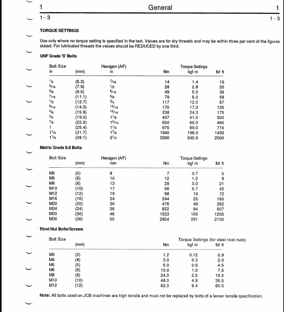

Picked up the two rebuilt cylinders yesterday. They had to load them as I can't lift one by myself. My neighbor (wifes cousin) is out of town for a week.....so nobody to help me lift them out of my trunk until he gets back. (we live very rural so not like I can just to to next neighbor)
Regardless:
1. Cylinders are back in my hands
2. Lower mounting plate has new grease cap welded on
3. Ordered a torque multiplier, it's on way
4. Replacement bolts are here, waiting assembly
5. Ordered a second 1 1/2" socket so I can hold the bolts while using my other 1 1/2" socket to tighten them
Several things in motion. I'm at a standstill right now with no extra muscle to pull cylinders out of trunk and some of the assembly parts aren't here yet (socket & torque multiplier)
Question.... I've not measured the bolt but it looks like it's about 1". The absolute size of it isn't relevant to my question.
Here's their torque chart.
If it is the 1" bolt, it calls for 715 lb/ft torque or, "for lubricated threads, REDUCED by one third"
What would be best used to lubricate them?
I've read things online stating that motor oil might be the best (which I found intersting....then again, "I read it on the internet")

I read the entire page, and I would still use anti-sieze, just lower torque values - especially with the size fasteners you're talking about - in 35 years of heavy industrial maintenance I only saw a handful of problems using anti-sieze, and most could be attributed to ham-handed macho crap.
On the other side of that coin, I rarely saw NON anti-siezed fasteners come apart without damage requiring replacement - although to be fair, mine was a pretty toxic atmosphere - various acids and gases that (in many cases) required face shields, respirators, etc...
On my own equipment (the list on my profile is a small drop in the bucket) I always use anti-sieze except on hydraulic fittings, and have never had a problem with fastener damage that could be attributed to it - I do tend to under-torque somewhat, but not much. Being able to take something apart and put it back together without either a trip to town or ordering parts online is more important to me, sounds like it would be that way for you also.

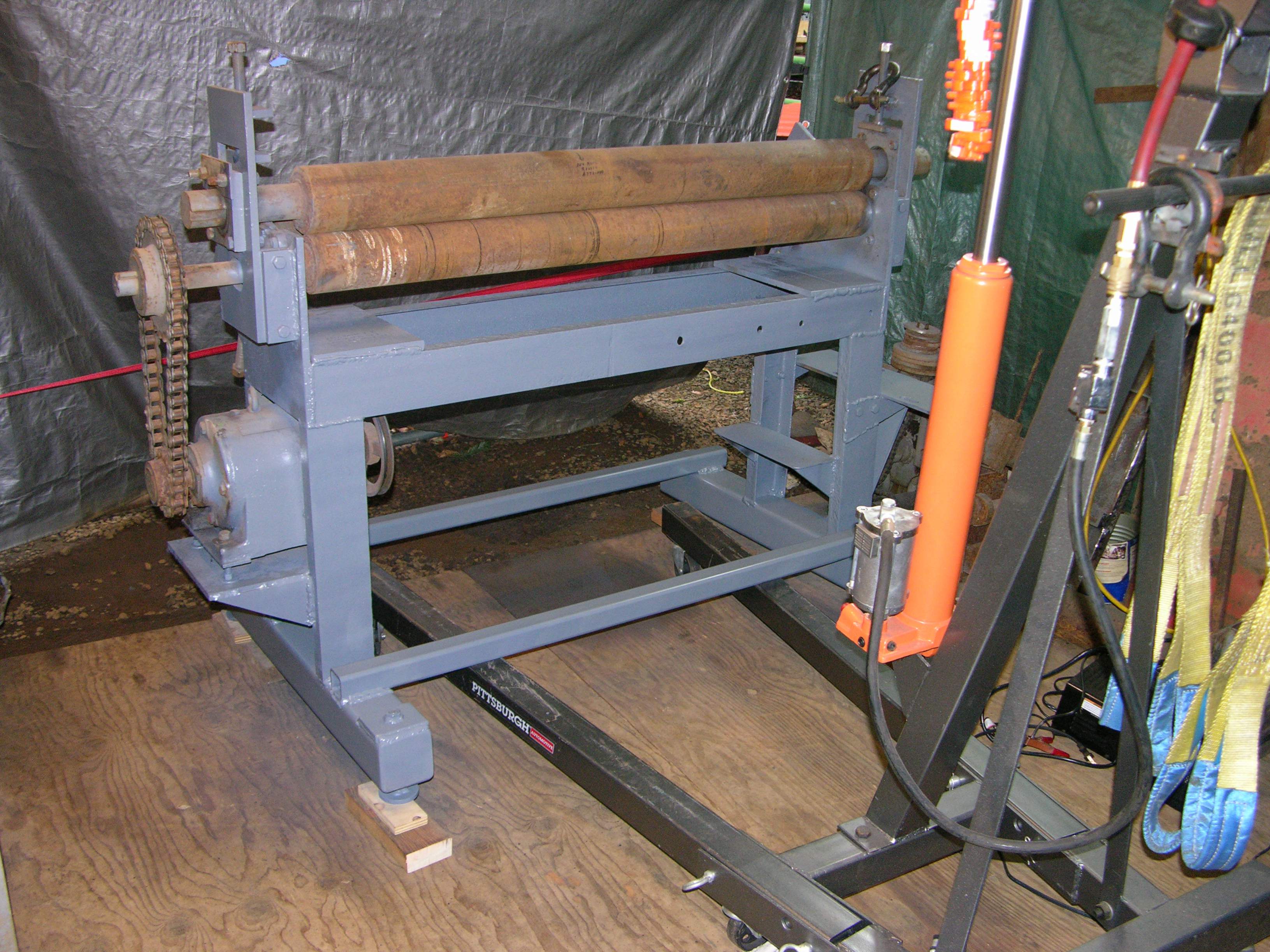

Here's a pic of the cherry picker helping me to fab a better base for a CL find - this slip roll will handle 1/4" plate without a grunt, and will roll 1" steel up to at least a foot wide. Note the replacement air/hydraulic jack on the cherry picker - DSCN1243.jpg
