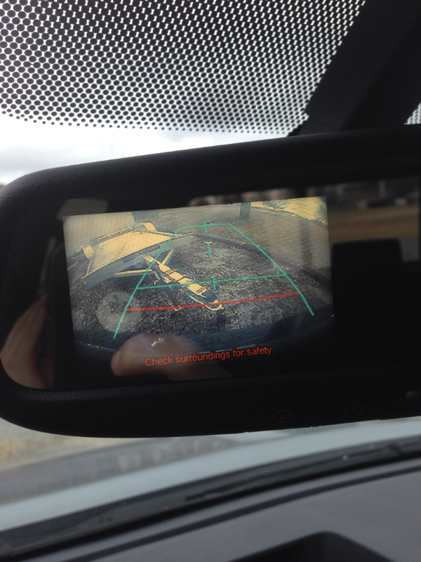

Is the back up camera in the rear view mirror any good?

I prefer the backup camera to be on the dash which has a larger screen, but the mirror screens are pretty decent.
/ Questions on 2016 F250 #3
Rearview mirror backup cameras are better than no backup camera at all, and are great for hooking up trailers,3.73 should be more than enough axle for the described uses, and hep you get slightly better fuel economy than 4.30s. If you plan to do much offroading, i would consider the fx4 package. Tailgate step is also nice if you get in and out of the bed much. Also i would get a gn hitch with it. Post pics when you get it.

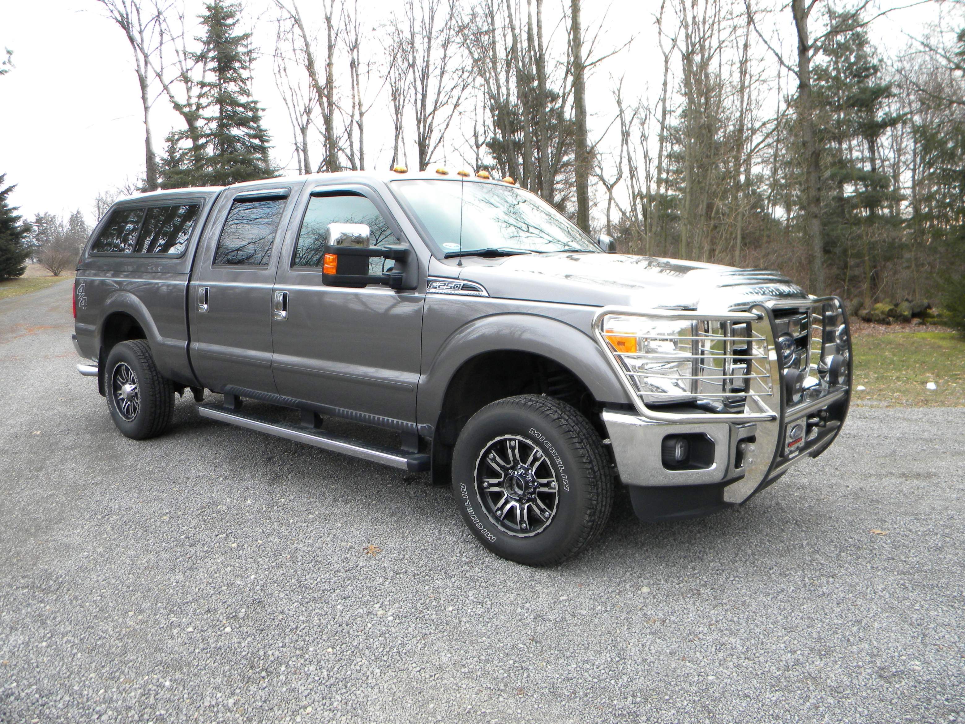

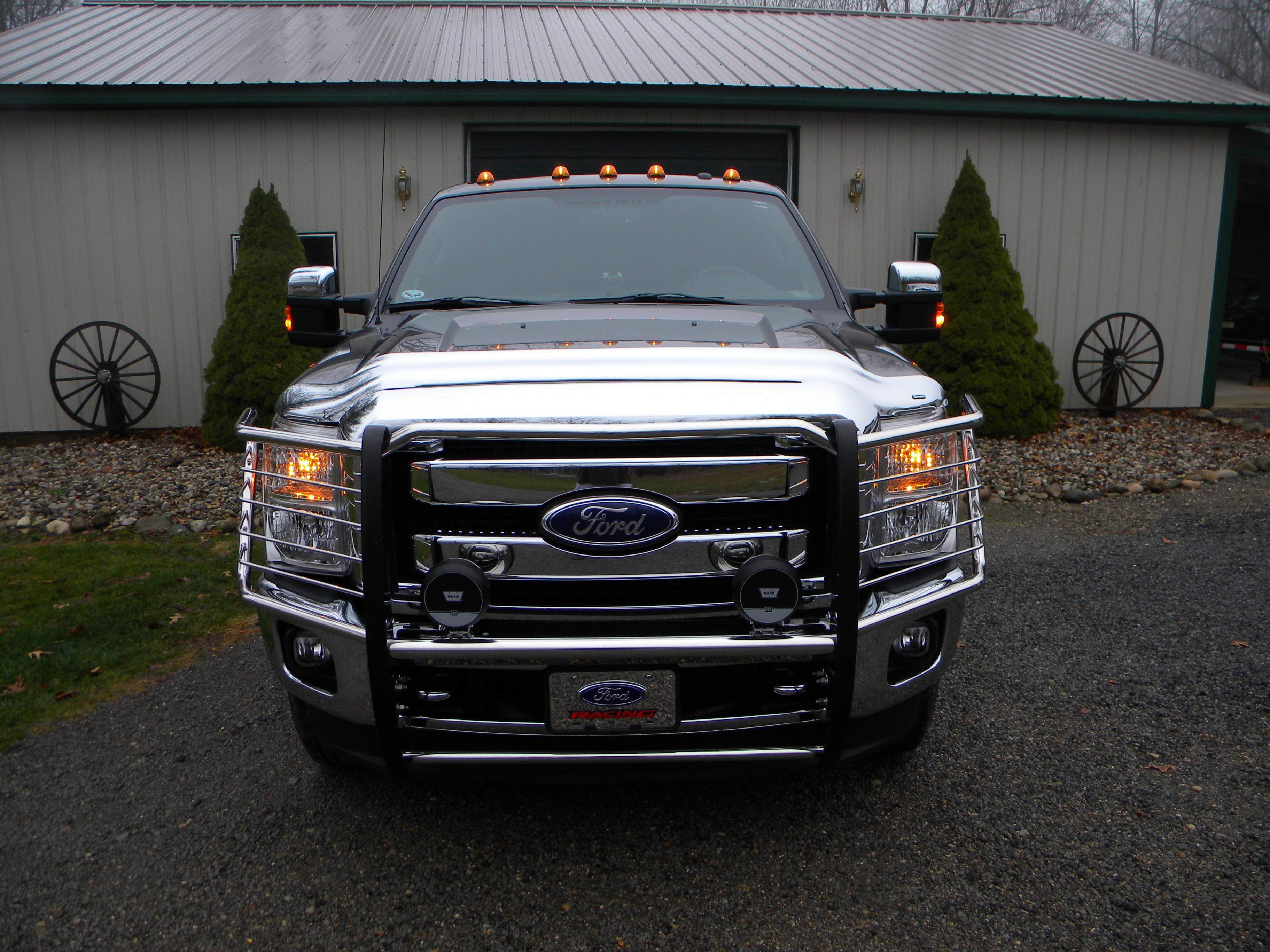

Do yourself a favor and buy the F350 it will not sag in the rear as much when you hook onto a trailer.I loved my 2011 Ford F-250 but hated the way the rear sagged when I hooked up to my 20 ft. bumper pull trailer with a heavy load.I would go with a 3.73 or 4.30 gear and tow package.My mileage with the 6.2 engine and 3.73 gear was around 14mpg,s city/highway driving

Great looking truck
