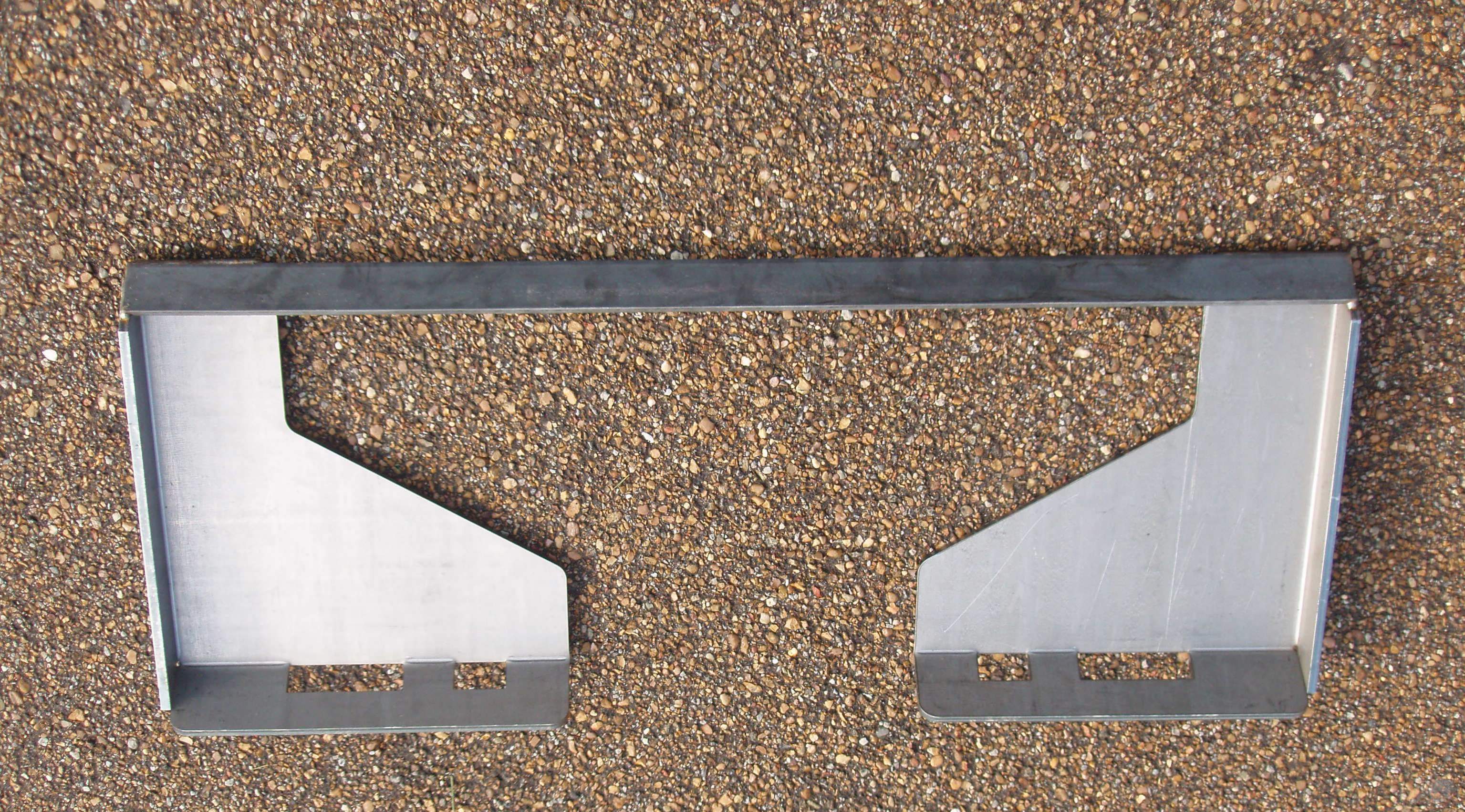

We just finished making a new Quick Tach Conversion kit to convert pin on style loaders to the skid steer/tractor style universal quick tach hookup. The cost for the kit will be $259(free shipping) and it includes a mounting plate and both quick tach brackets.
We need step by step photos of an install of this kit for our ads. If you have the ability to cut, weld and email good photos we will sell you the kit for $100 in return for some good photos. Inbox us for details or email us at info@palletforks.com.

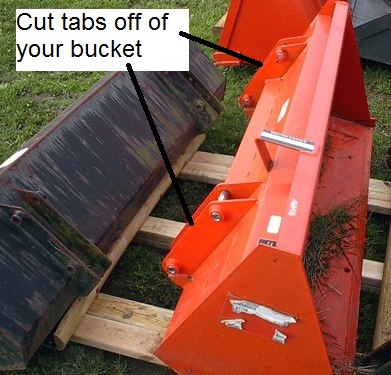

Maybe this was covered in a earlier post.
I used your latch plates for my build and they work great but you cant just cut off your brackets and weld directly to the plate like the picture in post #1 shows , even if the width allows it the kickouts where the pins latch in hit the loader arms and prevented the bucket from pivoting to full dump. Just want folks to check there clearance ahead of time when fabbing things up. I ended up with a 2" piece of square tube as a spacer under my pin boxes which was perfect.
If I was to do it over i would just cut the pin boxes "out" of the bucket and not "try" to cut them "off" of the bucket then use the 2 rectangle holes in the bucket for some extra weld on the backing plate.
