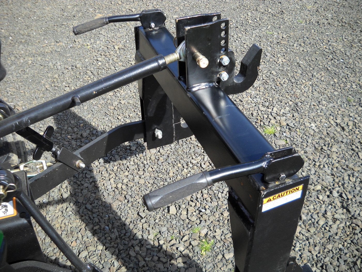

I have Speeco Quick Hitches on both of my tractors with one in use for 10 years now. I have modified the handles to point to the front of the tractor so I can just turnaround in the seat and open or close the latches. In cases where I don't have a PTO shaft I can attach or drop an implement with out getting off the tractor.
