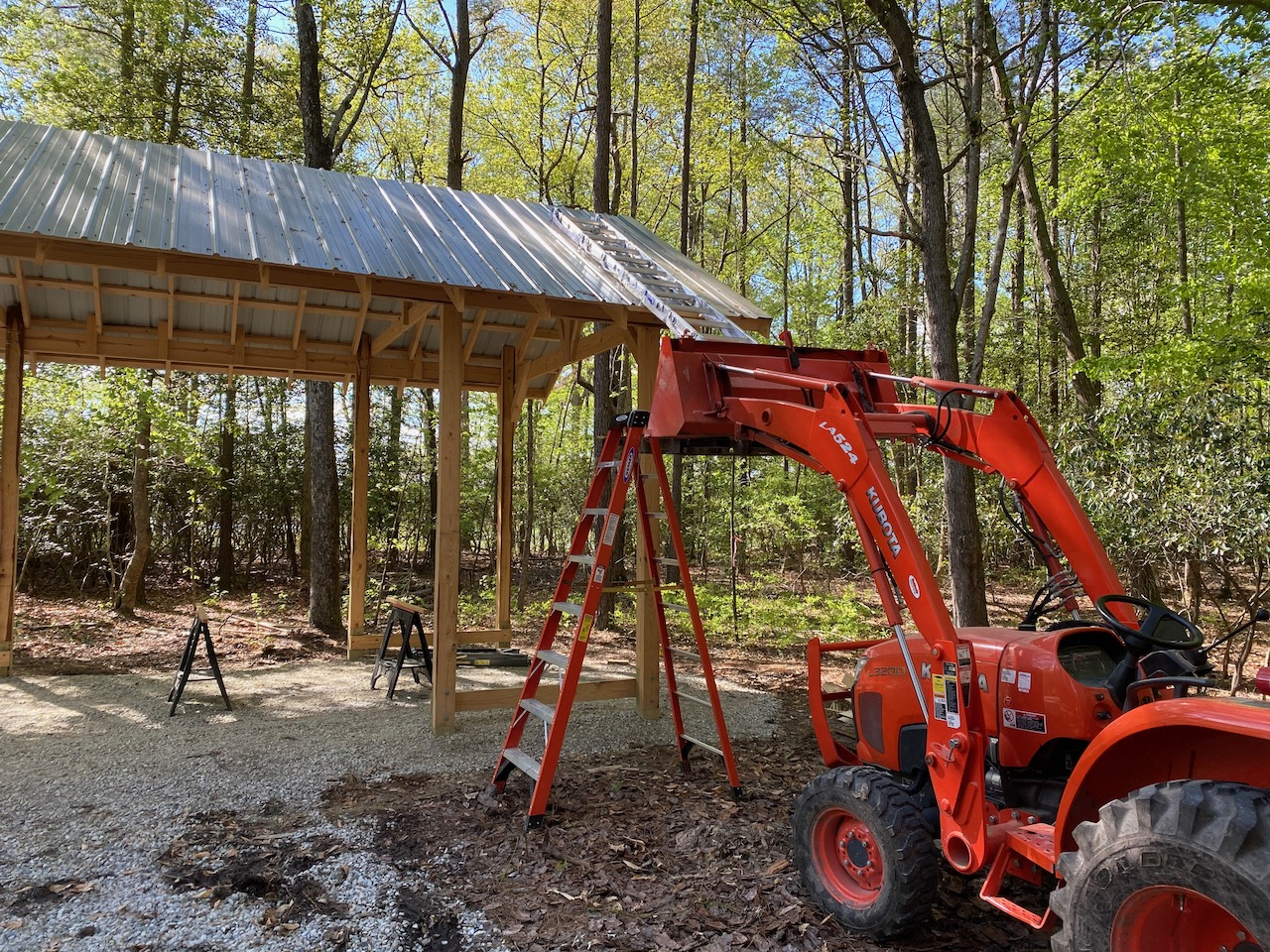

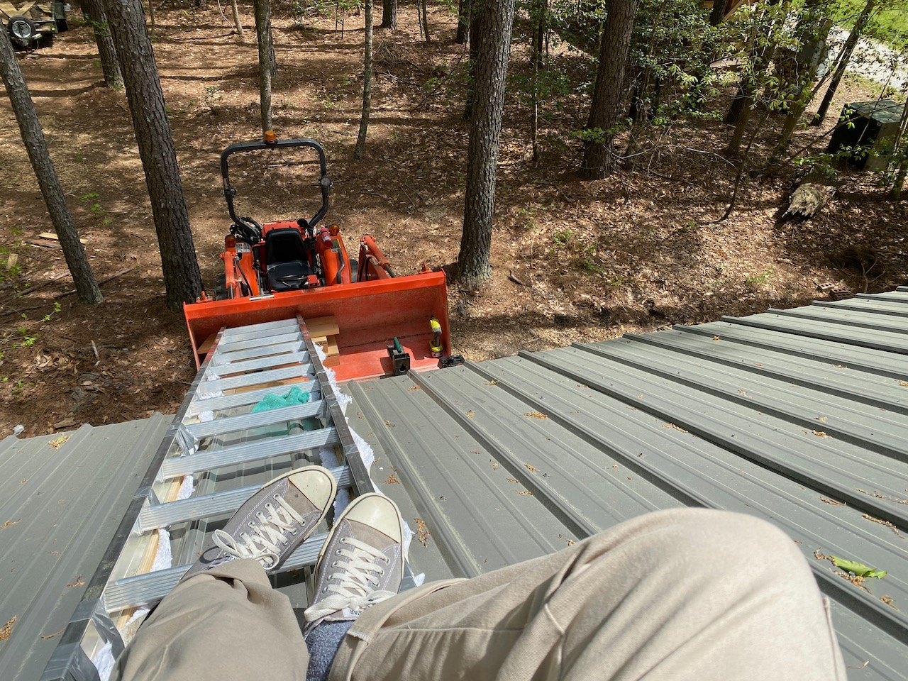

Just did this today to work on a metal roof. Felt very stable and safe even though it looks like a real rig job. No other good way to get up to the ridge in this case.
That looks scary.
I would have started to panic looking g down to take that picture!!!

   / Raising an extension ladder #24
   / Raising an extension ladder #25
By the way, I used a couple timbers to brace under the bucket to avoid leak down. My loader will drop 1-2" after about 20 minutes, which isn't bad, but I didn't want to be worrying about that while up there on the roof.
Looks worse in the first picture than in the second.
There, you have the weight of the ladder on the roof and are just using the bucket to foot it. Not the same as I understand the OP to be asking about where it seems the ladder would be supported only by the bucket and leaned against a wall.
