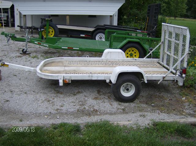

Maybe this is just because I don't have any flat ground but you did what? Half the time the truck and trailer will take off while unloading with them hitched together (tongue lifts rear truck tires off ground) never mind unhitched!
Hinged "loading legs" that drop down to a couple of inches off the ground are a good option!

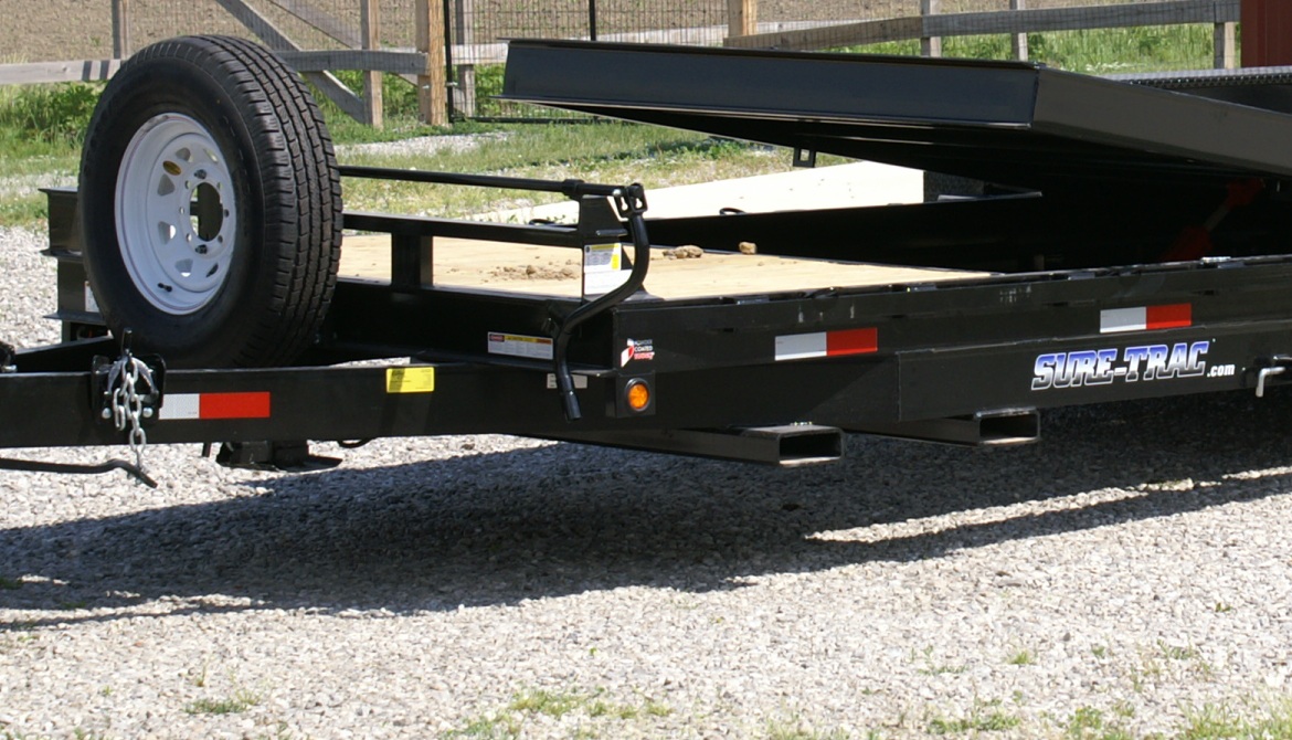

It's a matter of personal preference! I really don't care for tilt beds, I've had them in different sizes, didn't like them very well. Two of my three flatbeds have ramp gates. The third uses ramps, alum for most loads, steel for heavy loads. ~~ grnspot
