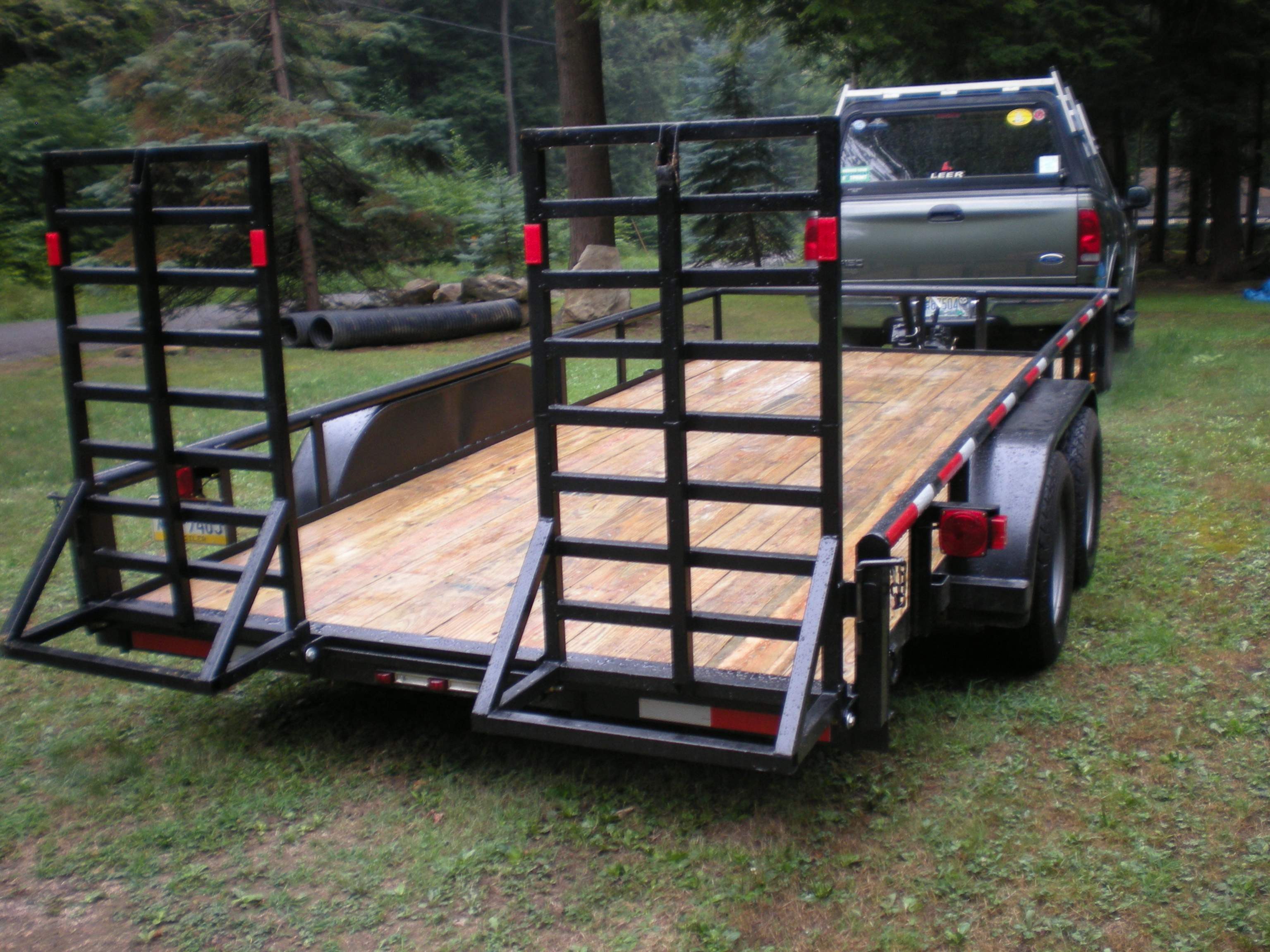

Fold up ramps work well for me.:thumbsup: BTW Chris a guy I work with has an 18' tilt with wood deck.
