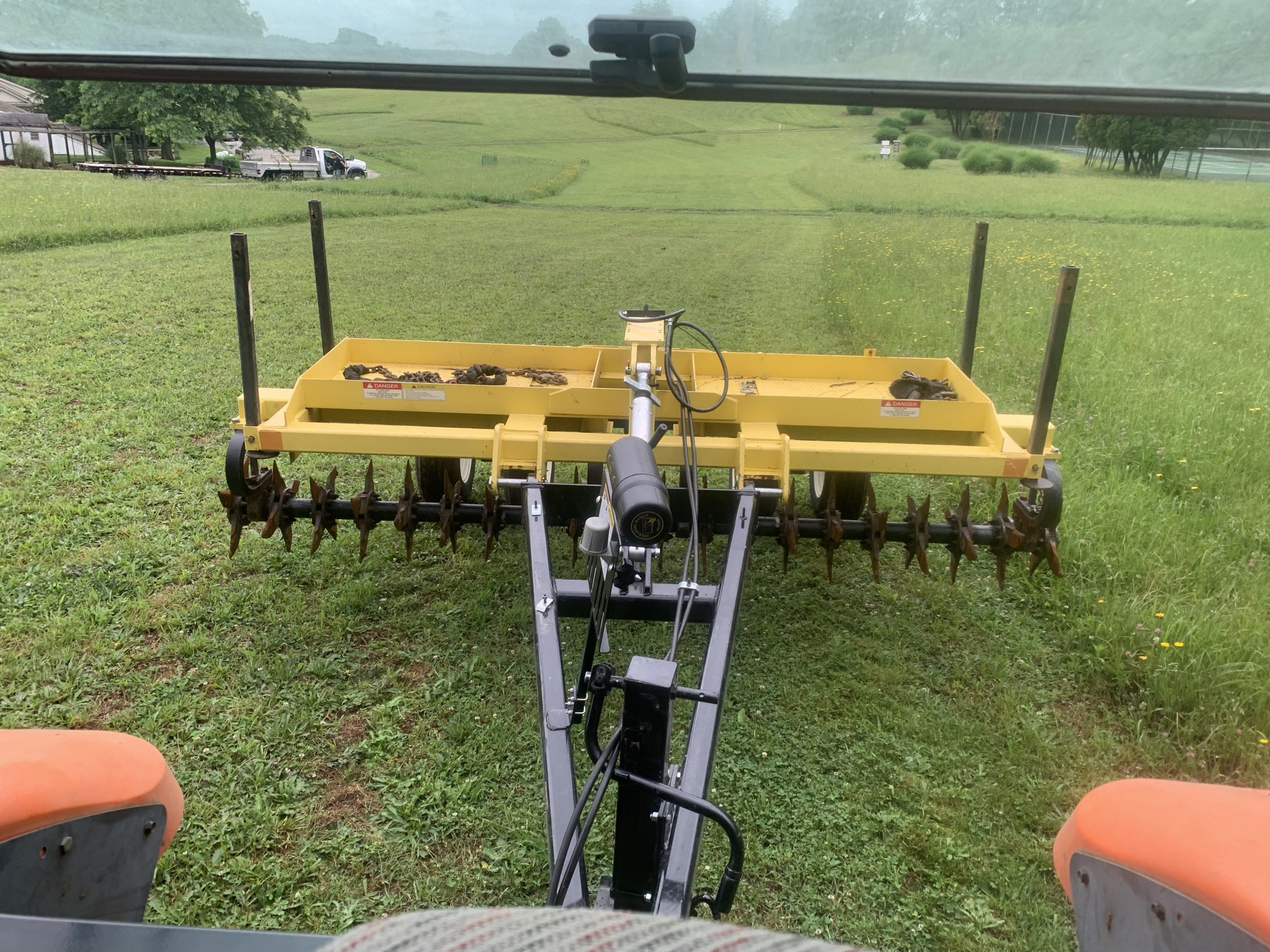

Have you thought about running an aereator over the field or possibly burning it off prior to spring growth.
   / re-seeding information wanted #7
You can usually rent an aerator
They are helpful on compacted soI’ll and help cut older root-bound clump grasses.
An aerator. Interesting. I have spoken w/our county agent, he never suggested that. I have a call in to the local U.S. D. A., even stopped by. They are not returning calls as they are so busy, a woman I briefly spoke w/at the office said they are at least a year behind doing farm visits. All I am looking for is options. Attended a seminar about growing hemp(ruled that out), the county agent suggested raising cattle(my horse vet just shook his head NO when I told him that), so for now re-energizing the existing pastures/hayfields is on my plate. The people on this site are always helpful and informative.
   / re-seeding information wanted #9
Nancy, I quote the below from Google search, and add comments below
"After a summer that yielded little hay and pasture forage due to the drought, many hay producers are asking if aeration would be helpful. ... In fact, aeration is unlikely to be of economic benefit in the vast majority of cases."
In a lawn environment, with lots of foot traffic or cars driving on the lawn, aeration is likely to help the lawn by penetrating the compacted earth. In a pasture, aeration will help cow trails, around feeding and watering areas, but is not likely to help the pasture enough to justify the time spent to do the whole thing. Several years ago, I spent 4 days aerating, and could not detect any difference in the pasture thereafter.
If you do aerate, you want a core, or plug aerator. You want a very heavy and strong unit, able to strongly hold all the concrete blocks that it is designed to hold. Aerate the 2nd day after a good rain. You want the soil moist and soft, not wet and muddy.
"In fact, aeration is unlikely to be of economic benefit in the vast majority of cases." "I spent 4 days aerating, and could not detect any difference in the pasture thereafter" Thanks for your experience. Hard to know what will or will not be productive. Sounded good.
