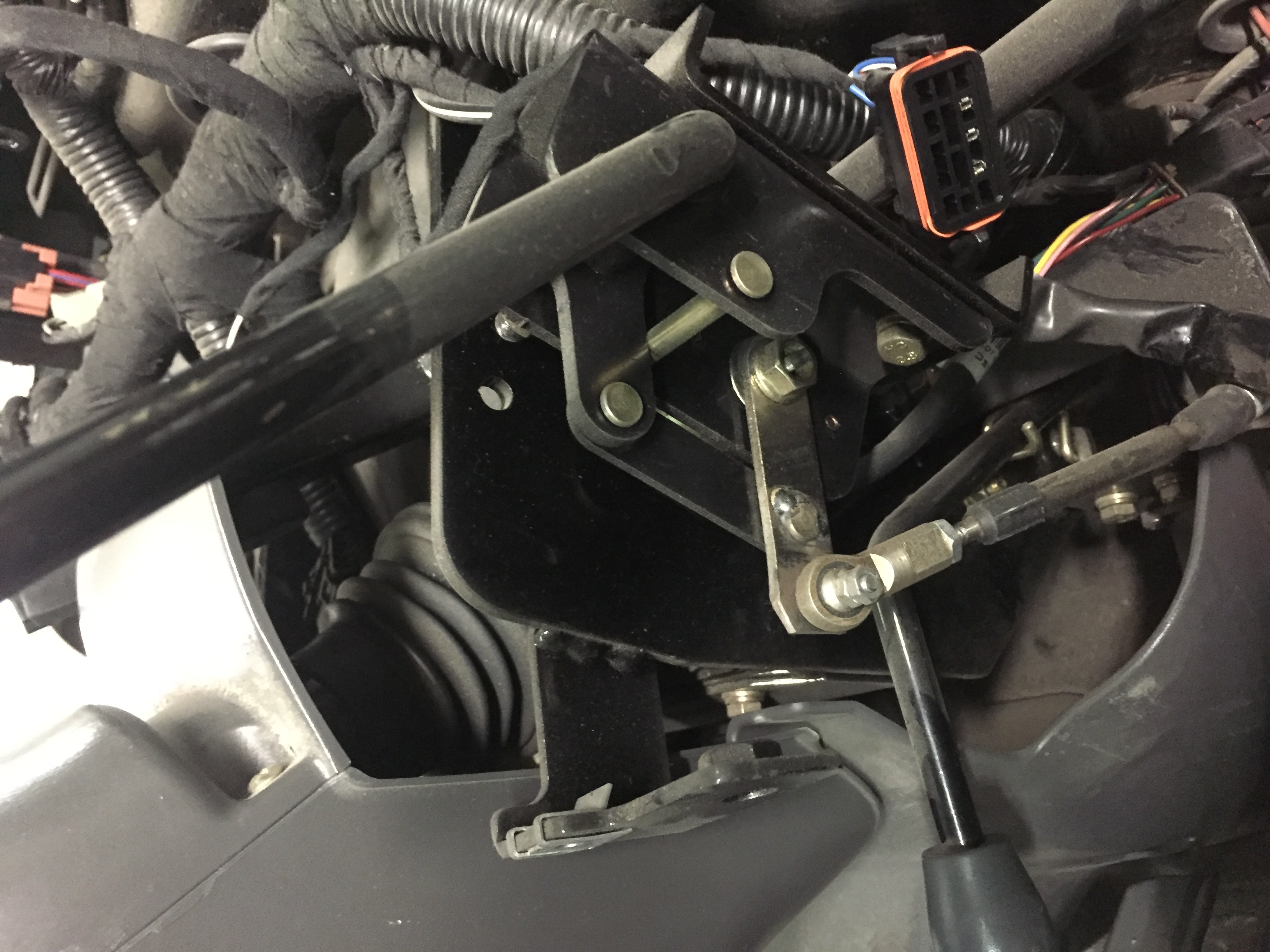

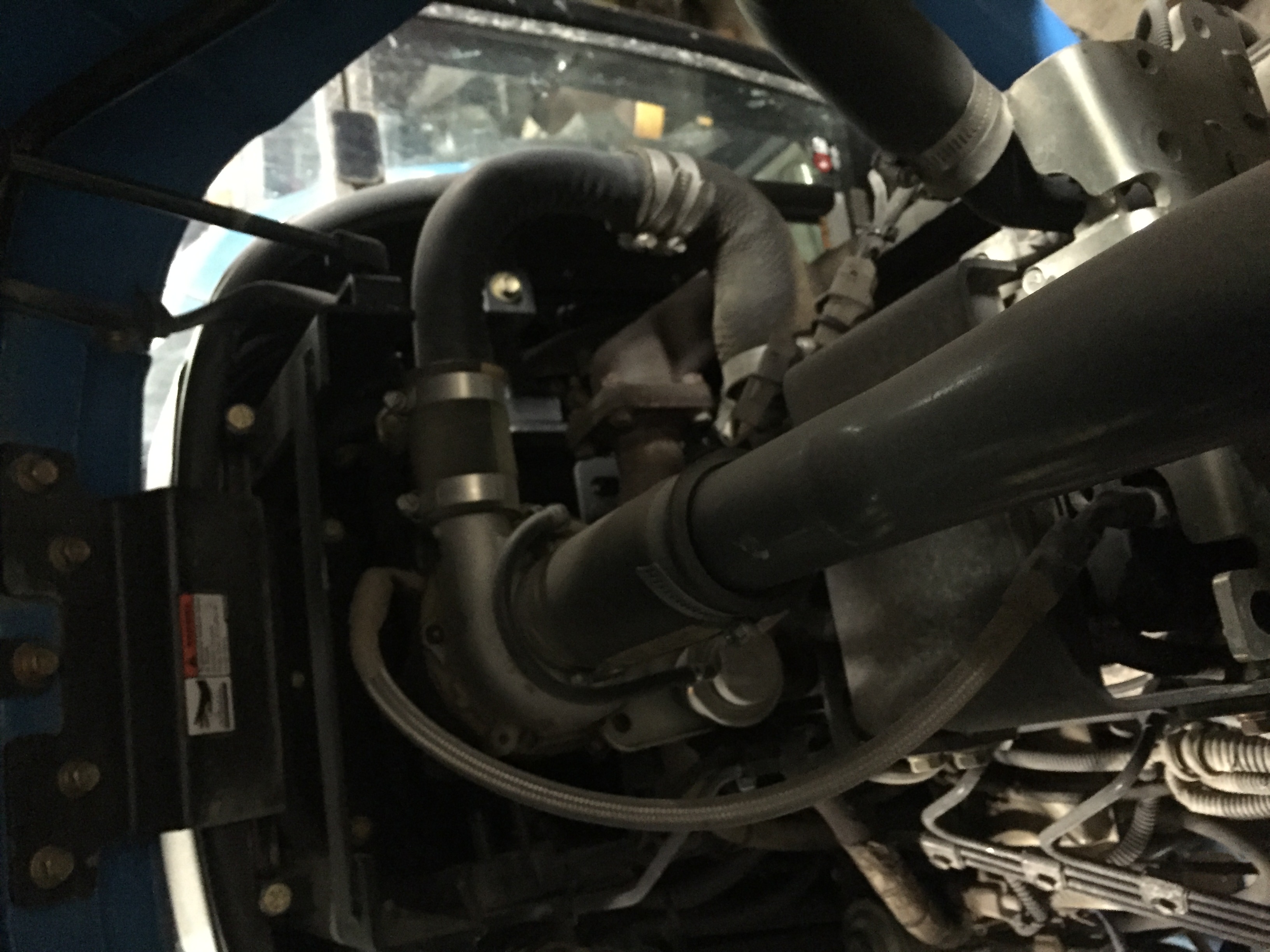

Yeah we are around 21-2200ft here. I figured around a 5-10hp gain between loosing the restriction of the dpf and giving it some boost. I've been meaning to get a boost guage on it to see where it's at. I run a 7ft snowblower with it and it has no problem at all. The rise in torque is quite impressive.

I dpf deleted and turboed my XR4040. Best thing ive done to it yet. Goes twice the amount of time on a tank of fuel and runs how I want it to and when I want it to!

Mine is hydrostatic. Tractor will run without the dpf but it stays in limp mode which limits your throttle. It would take a little bit of rigging to get it done, but it's worth it!

I can understand how disappointed you are but if you run the manual throttle cables it wouldn't matter if the DPF was in or out because the computer would no longer be able to cut the fuel. Mechanical Diesel engines just need fuel and air to run and taking the computer out of the picture would be the best bet. You could test this buy opening the hood while its running and manually moving the throttle linkage on the pump. You will still have blinky lights but rigging it up like Redlinecummins did would be what I would do. Just having blinky lights all the time isnt going to F'up the computer either... Just need to find out where to get custom cables made in your area. I am certainly not a fan of computerized utilitarian machines
   / READY TO BURN THIS THING TO THE GROUND!!! #48
The most reliable way is to get rid of the burner and filter like I did. There are places around that sell custom length of cables that you can rig up for the throttle, spend some decent money and get a good quality one that's low friction. On the injection pump all you have to do is adjust the set screws on the mechanical linkage to give you the correct idle rpm and max rpm. As for the warning lights on the dash I pulled my cluster apart and put tape over the bulb ports so there's no more light. Oh, and only other thing that needs to be done is feed keyed 12v power to the fuel shut off/throttle actuator. One other issue I had is the glowplug timer doesn't stay on long with the ecu showing errors. So to take care of that I wired in a manual push button switch to the glowplug relay (its actually better than it was from day one because I find up here in the cold winters it needs far more preheat to start). The dealer would look at this thing and be like WTF??? because its a frankentractor but I find when **** ain't done right from the factory you always gotta improvise and dial it in to your needs.
