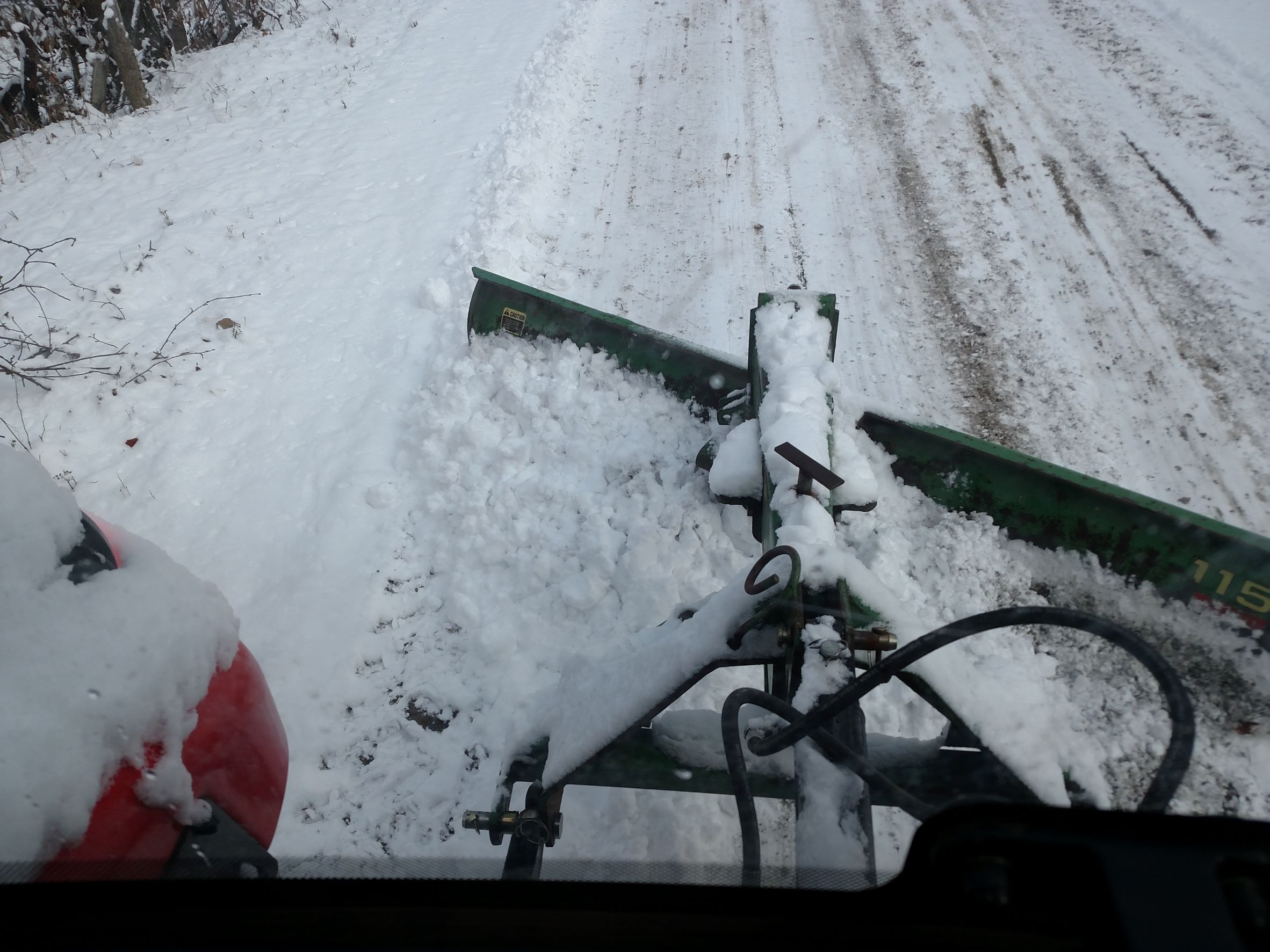

Our drive is irregular in angle and surface. Keeping it in shape is a challenge not much helped by wintertime plowing.
I like the idea of putting a pipe onto the cutting edge of the back blade. It might work on the FEL as well.
Wondering about how to attach it, and also wondering if there is some sort of heavy two two inch rubber hose that would work. Maybe a used fire engine hose?
Has anyone tried that?

I made shoes for my 7' rear blade to prevent dig-in. Like other's said, most times I just run the blade backwards.

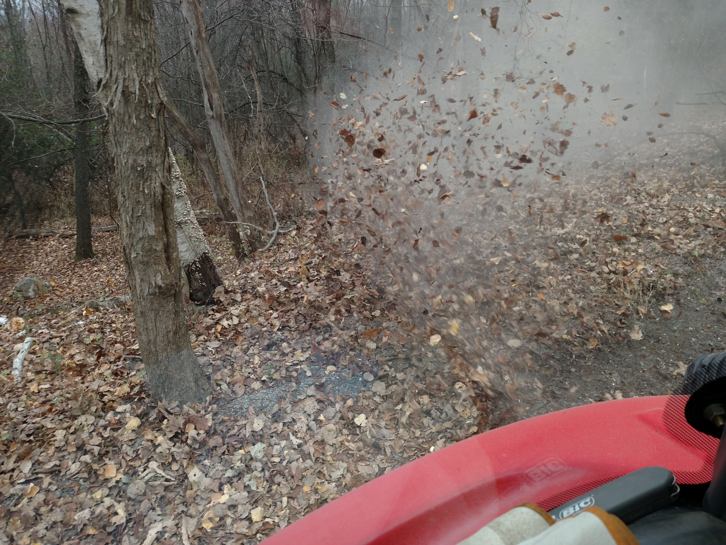

Even with no snow 90% of the hillside, curvy driveway maintenance was with the blade backwards till I got a land plane. North facing and thru the woods what little snow or ice we get sticks around. Sometimes have to grade a little in the heat of the day to expose a little gravel when it refreezes at night to allow enough vehicle traction. Rain at 20* is as common as snow.
Leaf load in the fall is as slick as any snow. Use mowers to mulch and blow to keep road clear for drainage. Often thought of modifying an old bush hog with extra lift wings welded to the blades and baffle(s) for side discharge. Increase suction and airflow. Would it work clearing moderate snow too? Requires a little more hillbilly contemplation.

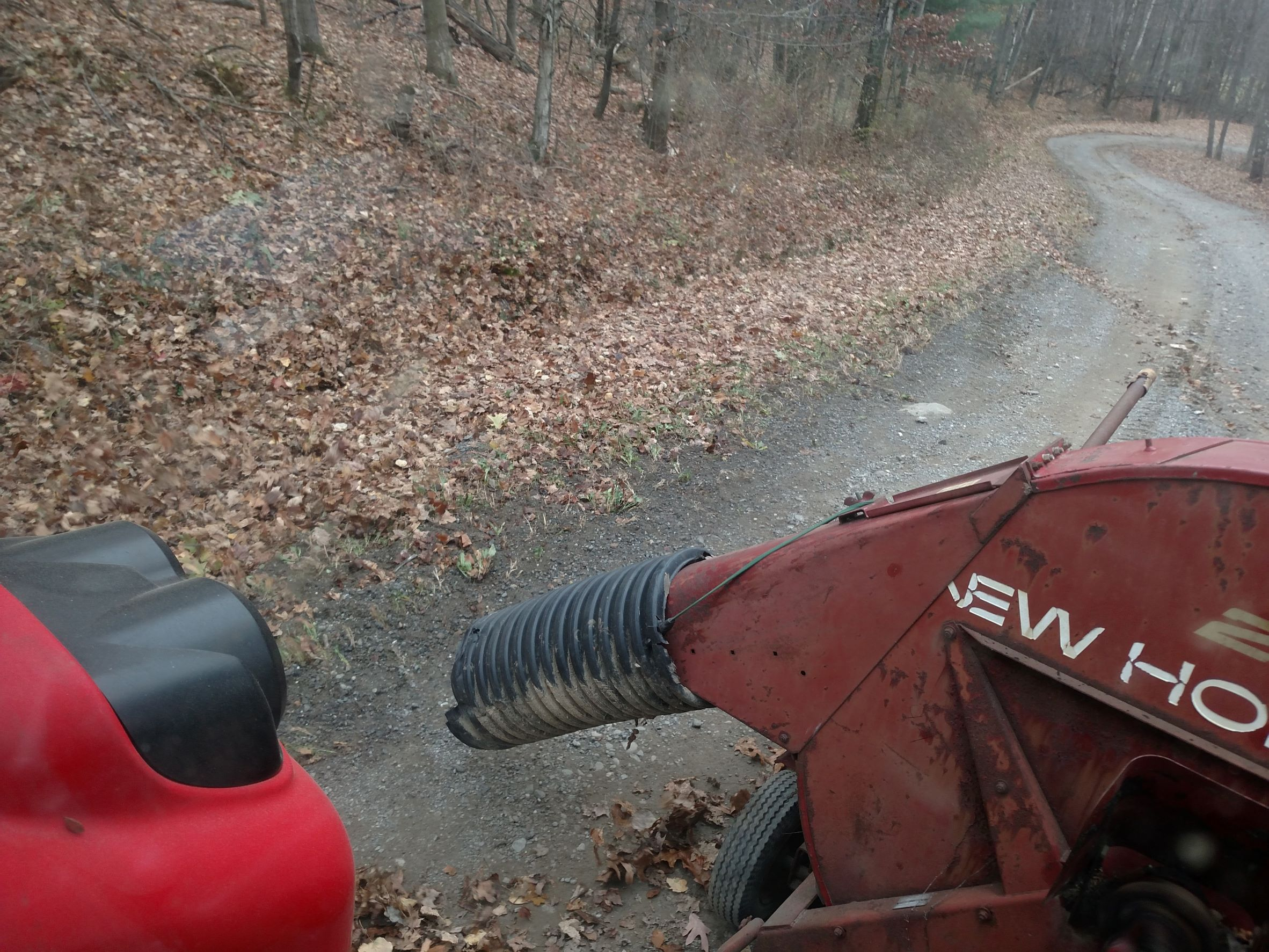

I use an old silage blower

Yep.....my hand held blower can blow loose gravel wherever it is pointed....just not as efficient as the silage blower.
