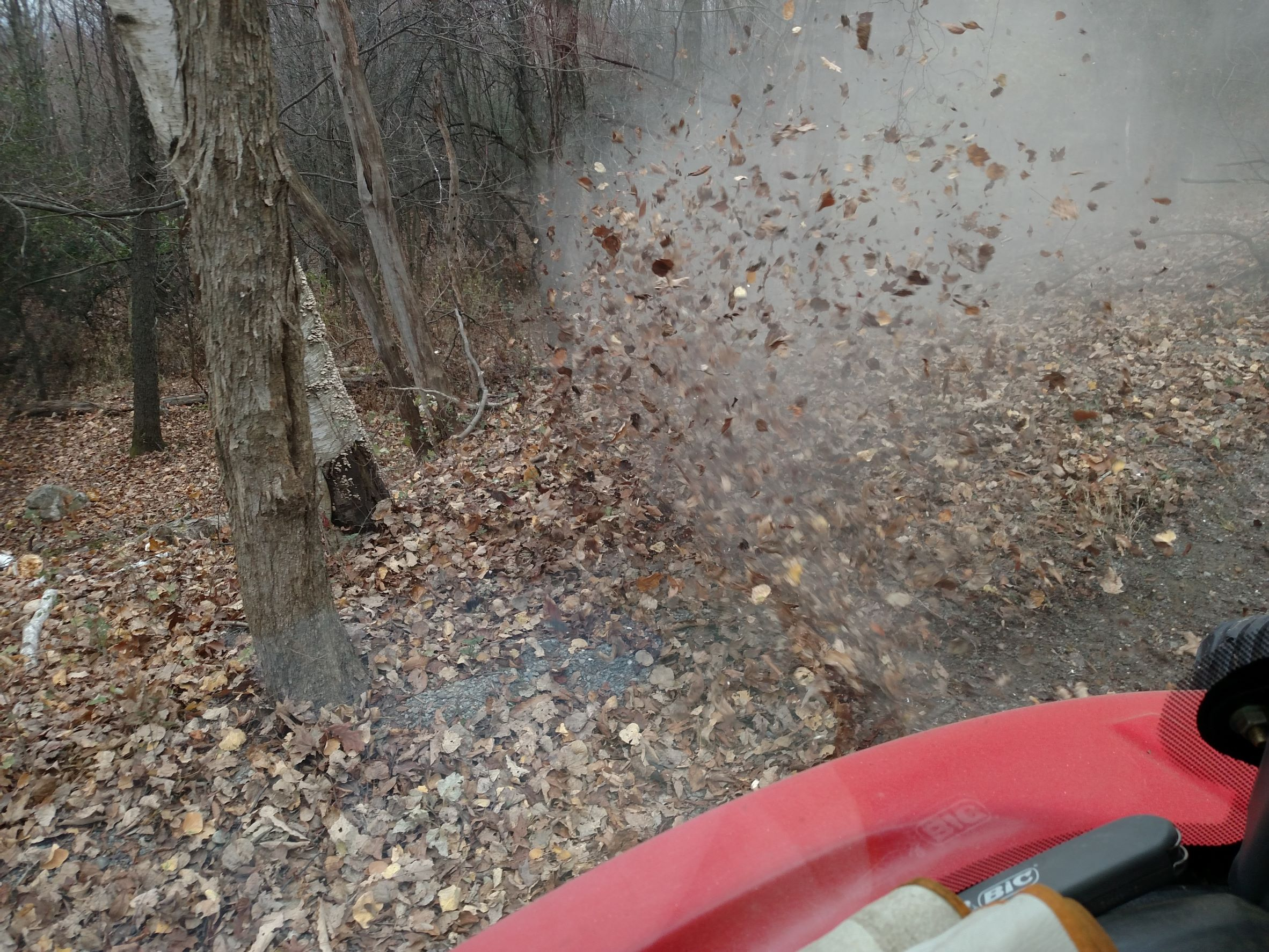

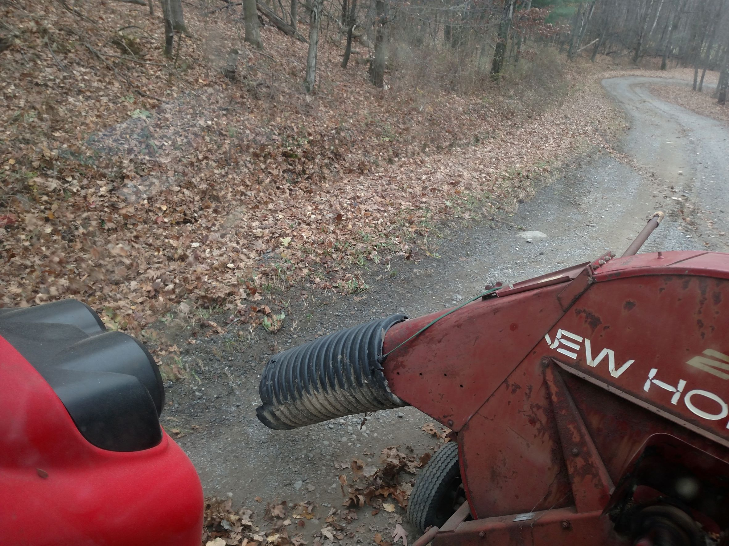

I use an old silage blower

Yep.....my hand held blower can blow loose gravel wherever it is pointed....just not as efficient as the silage blower.
