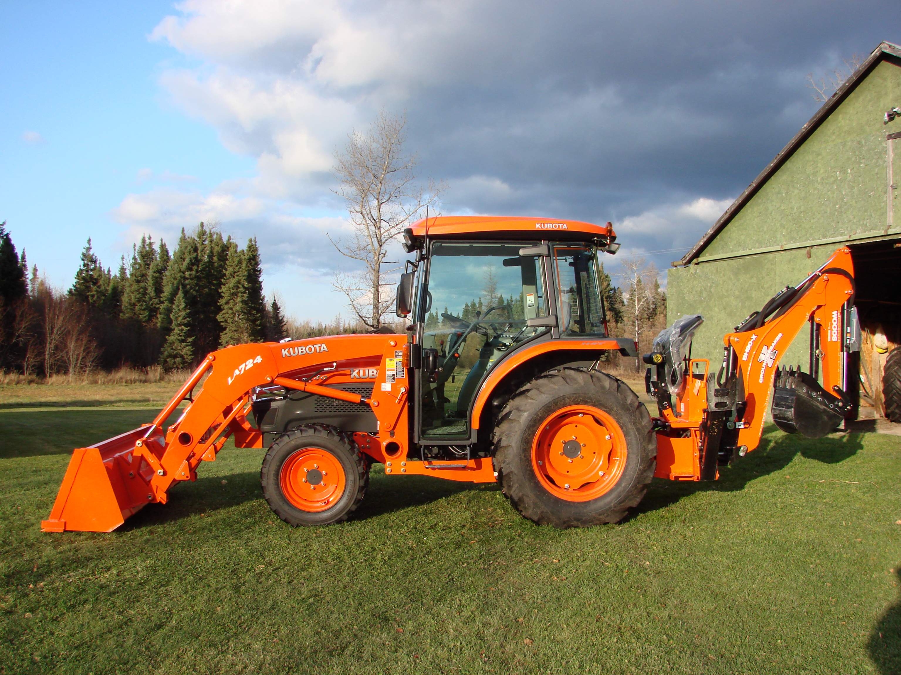

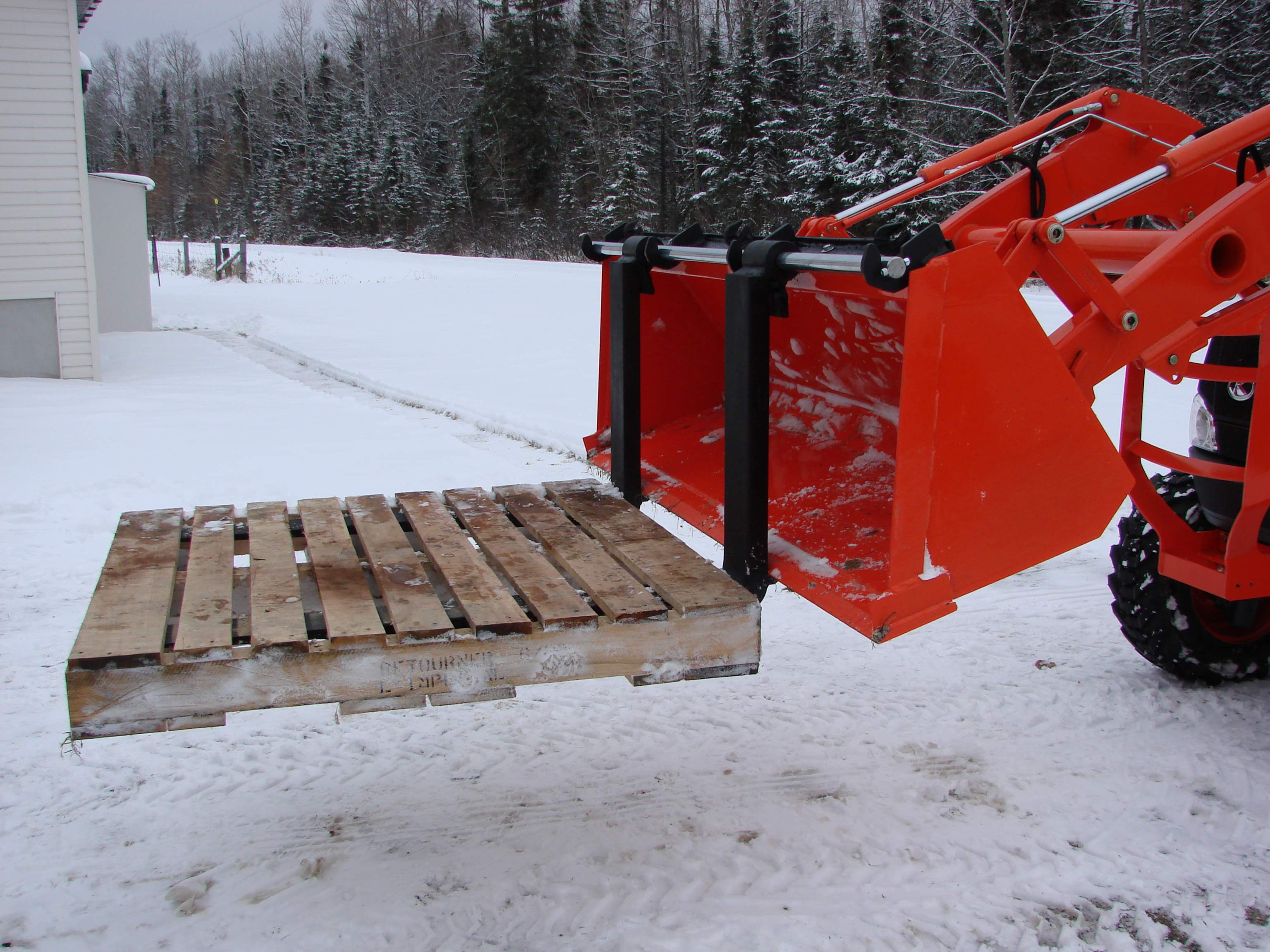

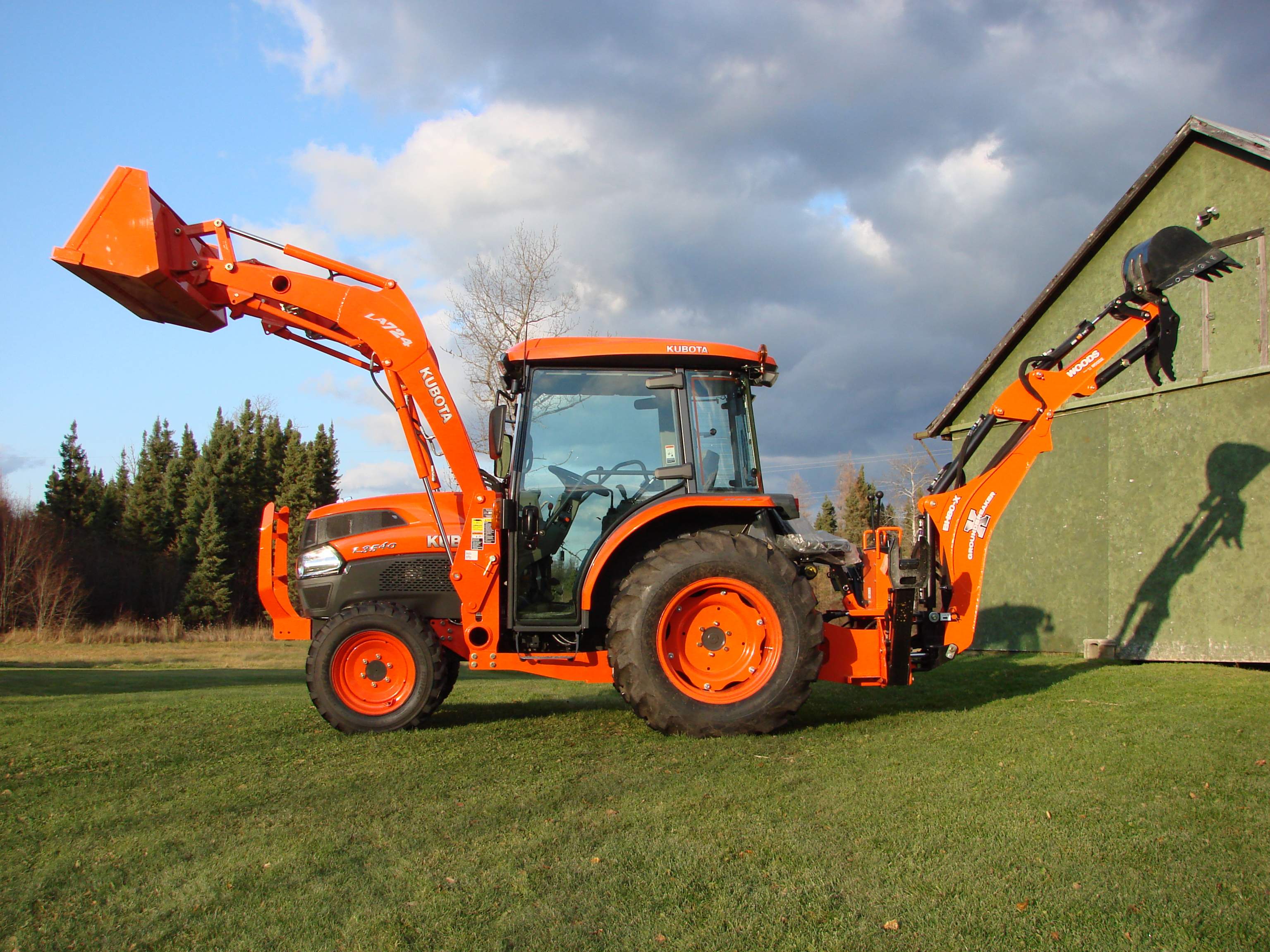

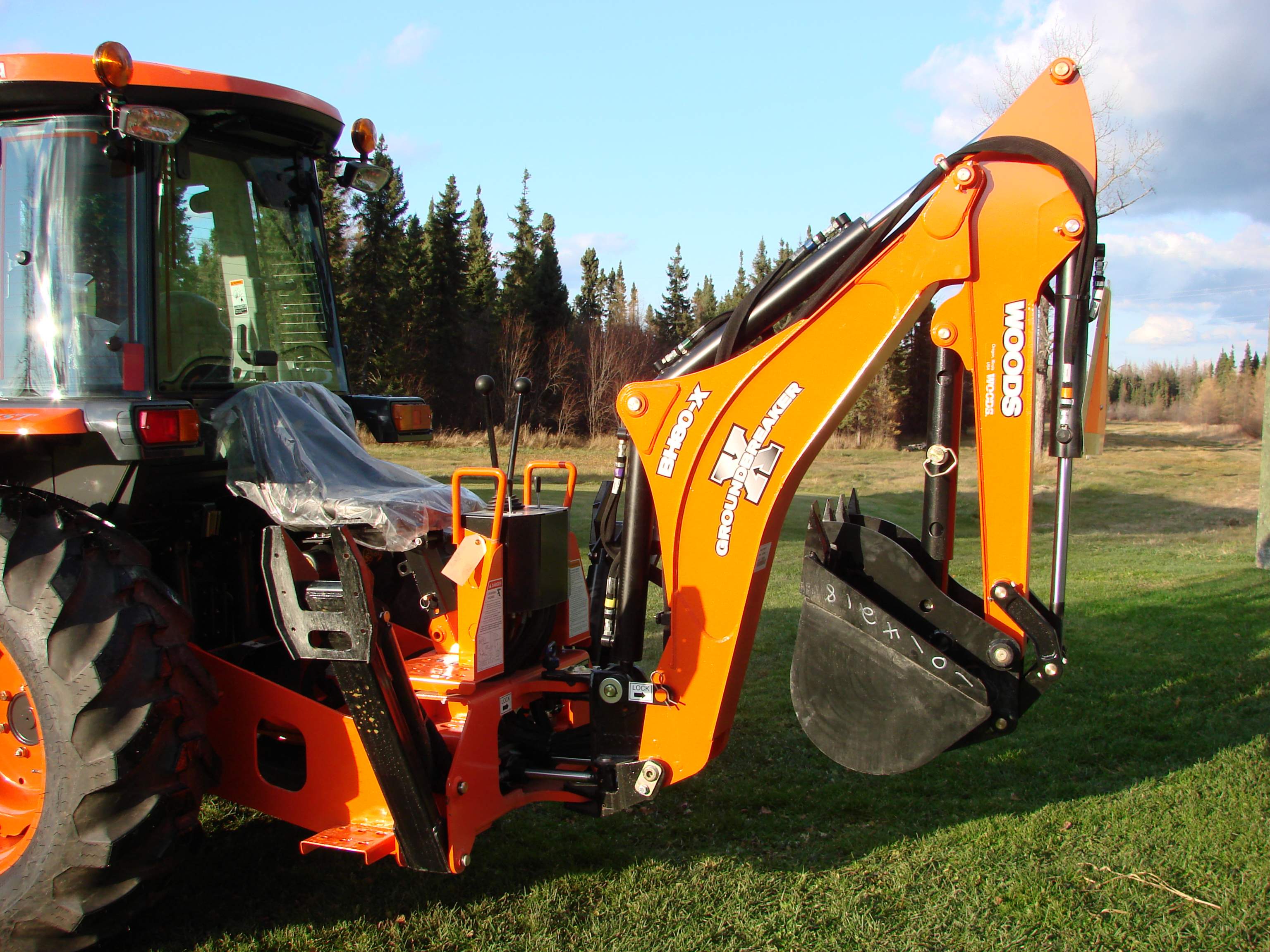

The BH80-X backhoe I purchased for my L3540 HSTC needed specific subframe kit(5" longer for cab tractor) about $600.. well worth it . I'll try to post pics.. and my fork attach I made...

That is a really NICE looking setup. Some day I hope to have a tractor with a cab as well and if it fits that well, I think that I might as well save up and get that BH80X sooner rather than later.
