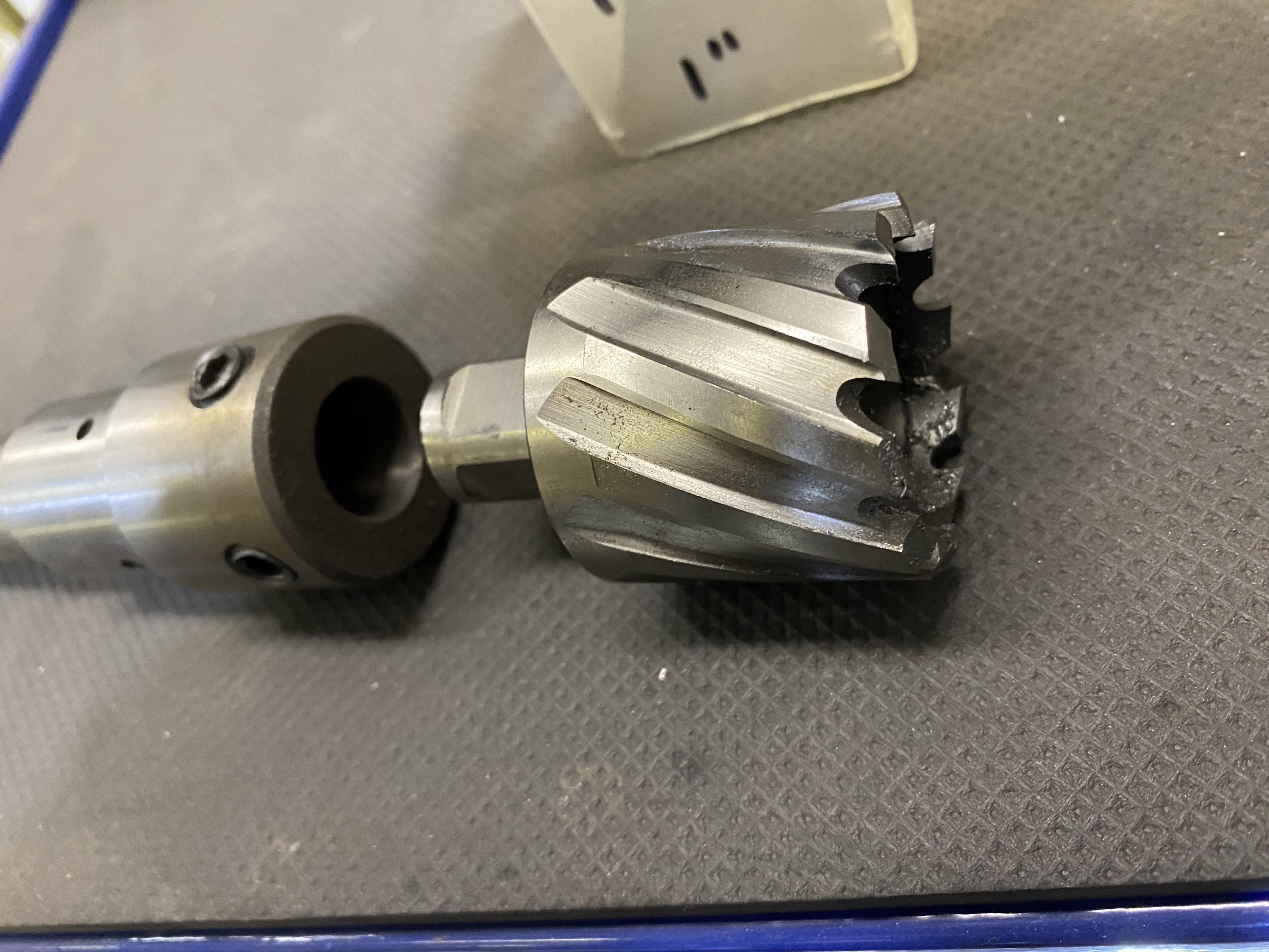

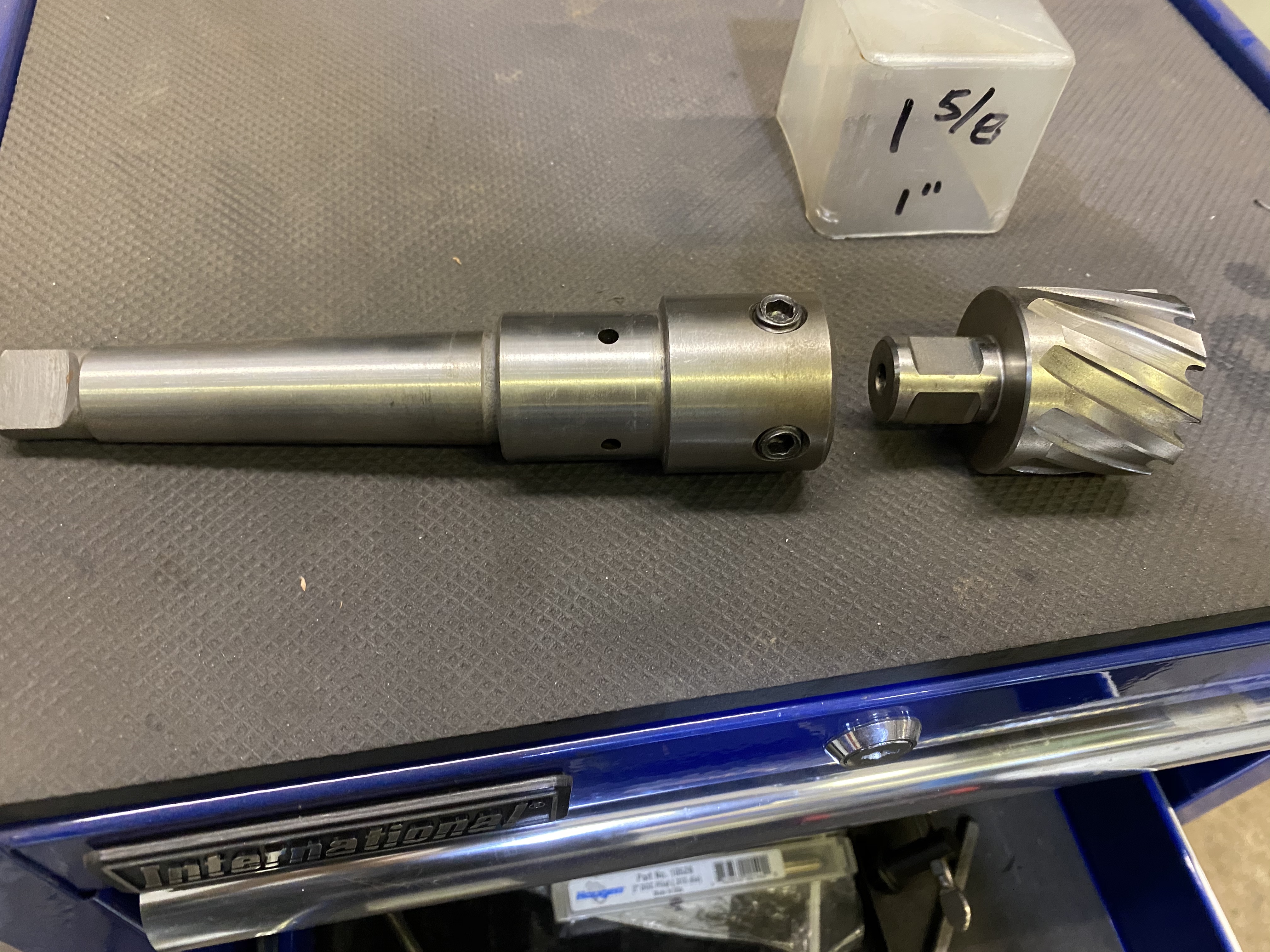

IF you wanted to use annular cutters in your drill press you will need a 3/4 Weldon adapter to fit your drill press spindle.
How does that adapter work? At first I thought it was something you put in your drill press chuck that would allow you to insert a weldon shank but after looking closer that doesn't seem to be the case. The shaft is tapered and has a square end. Do you have to remove the standard chuck from the press and swap to this? How hard is that?

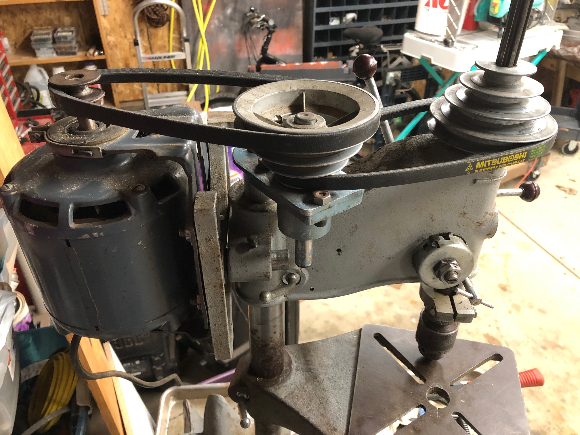

Someone added a jackshaft to this 70 year old 1/2" Duro press. Makes the chuck speed 300 rpm. I've used it to drill 1" holes with a Champion hole cutter. Slower would be better.

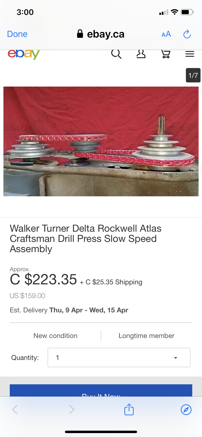

There is a seller on ebay that offers an intermediate pulley kit.
I searched for them on EBay using many different verbiages and came up with none. What are the jack shaft kits call on EB? A Link? Thanks! Here is one company offering them.

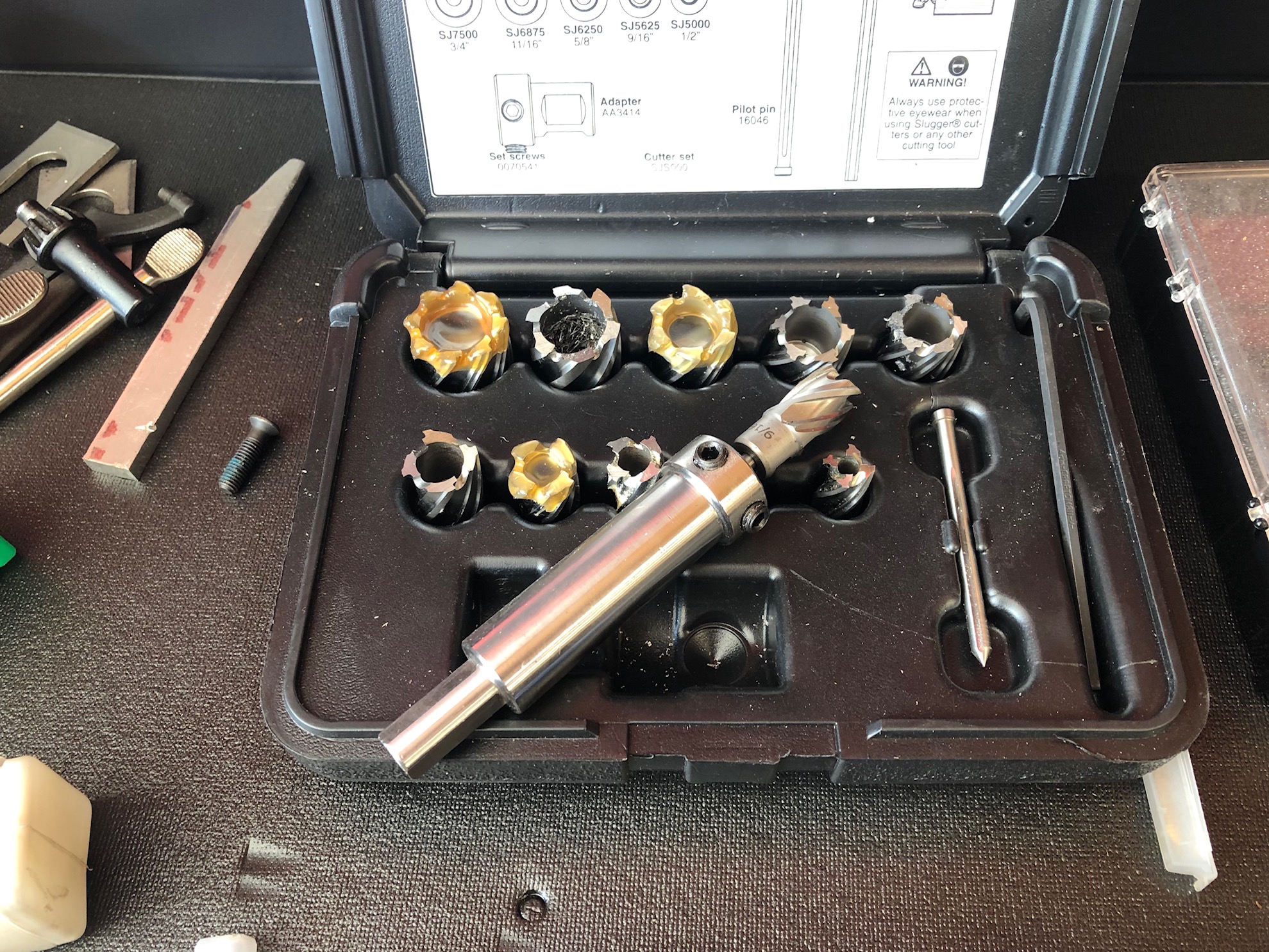

I also use this Jancy annular cutter set with a Jancy drill press adapter. 1/2" to 1-1/16". Works good but your drill press quill needs to be tight.
Rob
Rob. You will first need to know the spindle taper on your DP. And then find an adapter to match.
And yes the standard chuck is replaced.
The DP in my previous photo with my homemade reduction has a low speed of 300 RPM iirc. I have a cheap digital tachometer to check machine rpms. eBay. Numerous. Cheap. Free shipping.

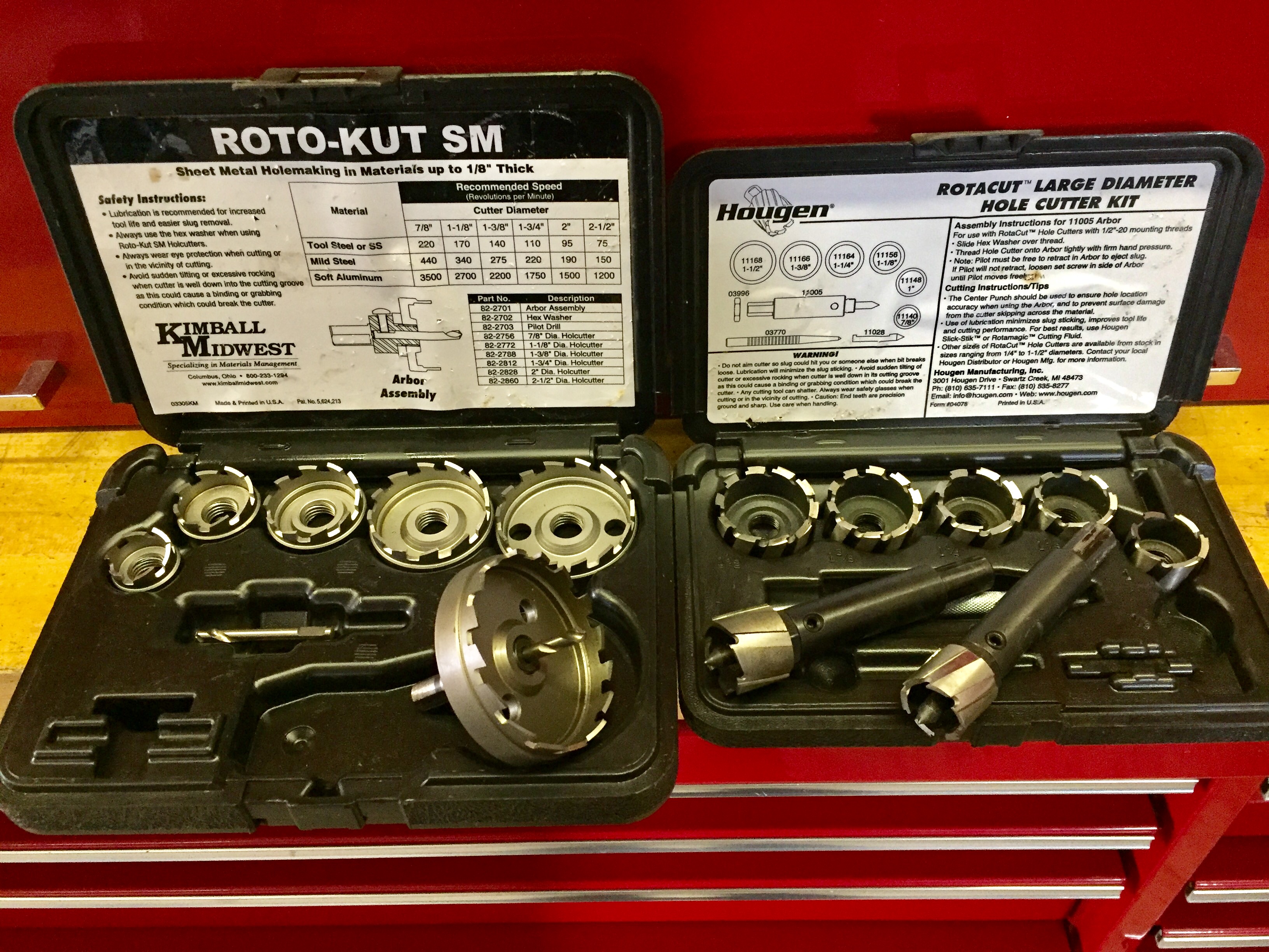

I think your best bet is to get the Champion hole cutter in the size you want. Because it has a pilot bit, it will not wander in a drill press. And like DE says it removes less metal that a equivalent twist drill so can be done with a garden variety drill press rather than a big industrial setup. Buying one at a time does not hurt too much.
   / Recommend a good quality large size drill bit set #40
Cutters like these are especially designed for drill press capabilities.
As downsized mentioned a rigid setup is paramount for using these cutters.
