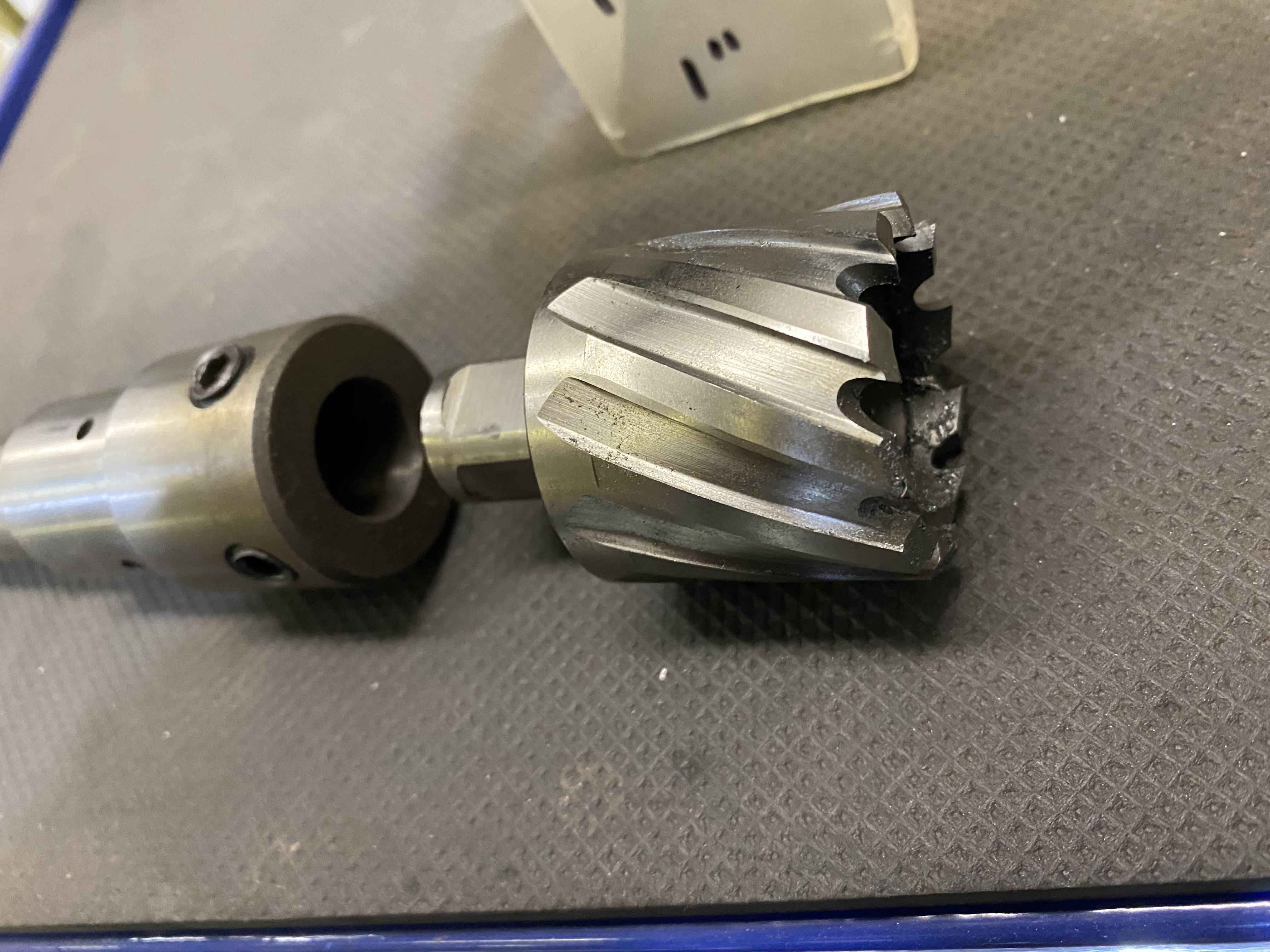

I have had good luck with annular cutters in that size range. Amazon for $200 Steel Dragon Tools 13pc. Tungsten Carbide Tipped Annular Cutter Kit 1-3/8" Depth and 1/2 in. to 1-1/16 in.

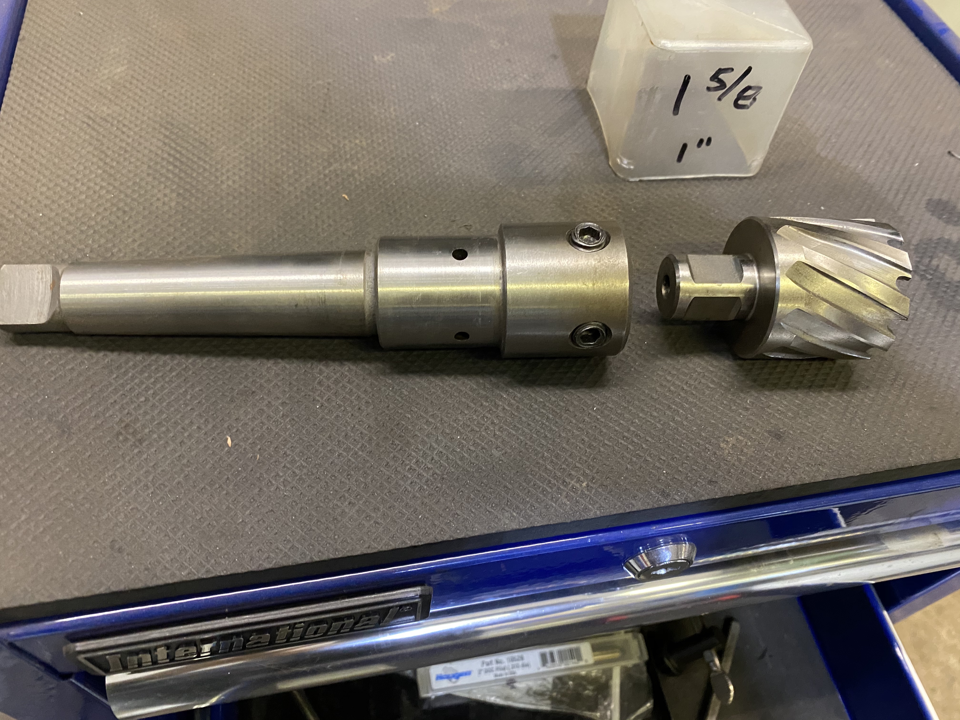

Does your drill press accommodate the 3/4" shafts on those annular cutters? Or do you have a mill or something else? My drill press arbor maxes out at 5/8" I think.

IF you wanted to use annular cutters in your drill press you will need a 3/4” Weldon adapter to fit your drill press spindle.

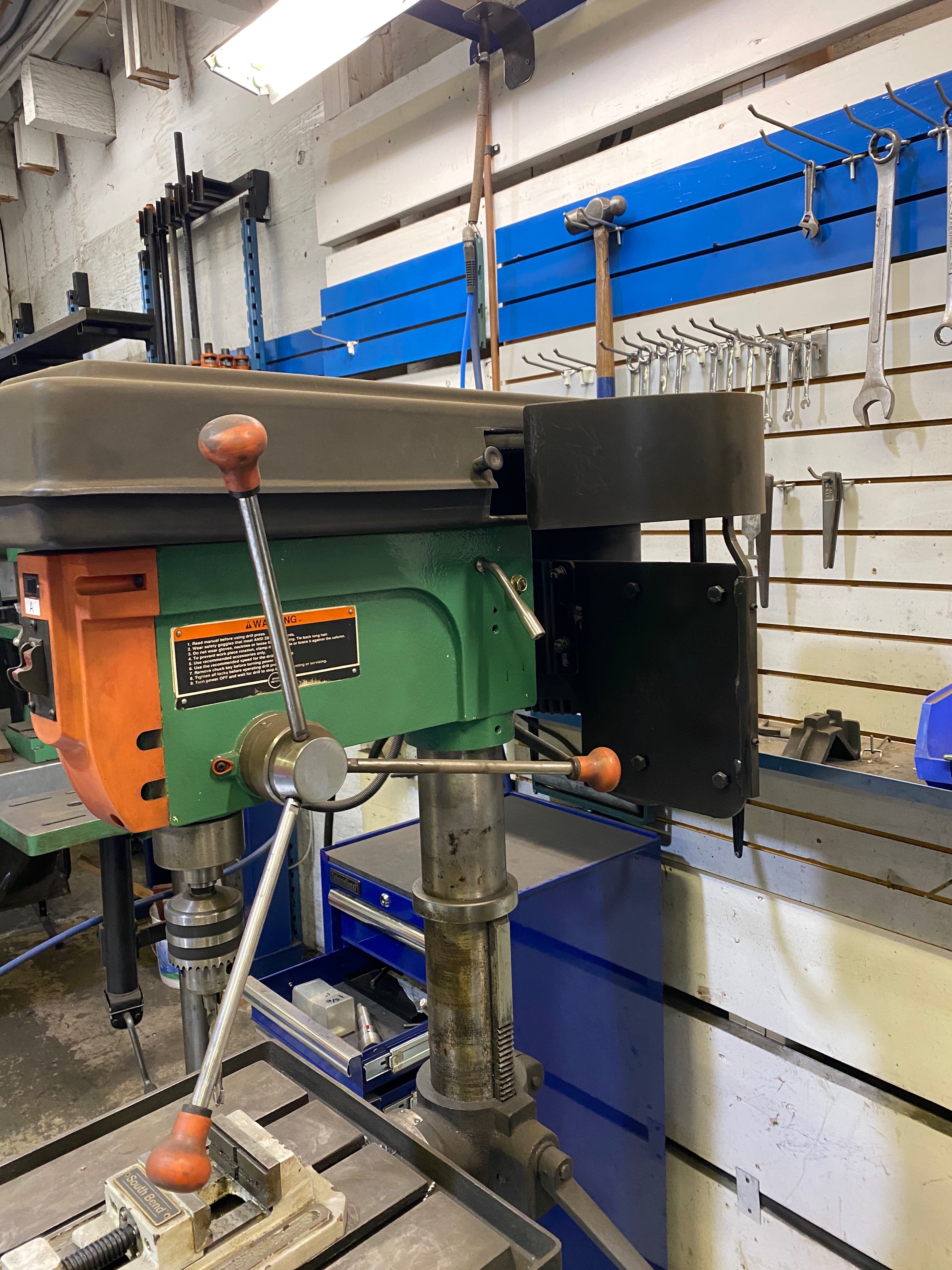

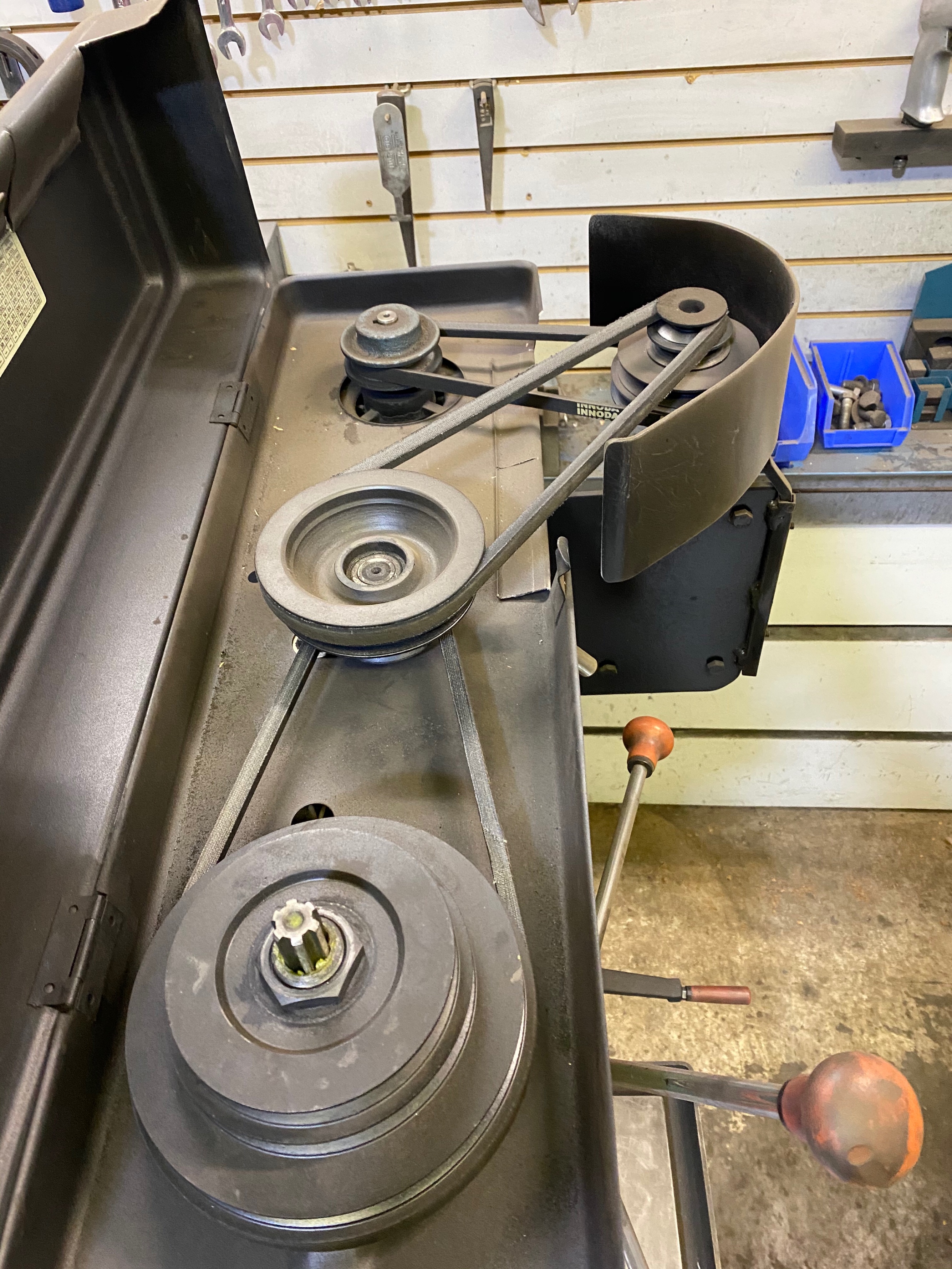

If necessary your DP RPMs could be reduced by adding a jackshaft assembly.

If necessary your DP RPMs could be reduced by adding a jackshaft assembly. .
There was a company in the US who built kits so we could add a jackshaft to our lame HS drill presses. Seems they are now gone and my drill is still to fast. :laughing:
   / Recommend a good quality large size drill bit set #29
At the time I would have purchased it from the eBay seller but as usual with shipping to Canada, the horrible exchange rate PLUS the Provincial sales tax and GST that customs dings me when it crosses the border... I decided to buy the parts and make it myself.
