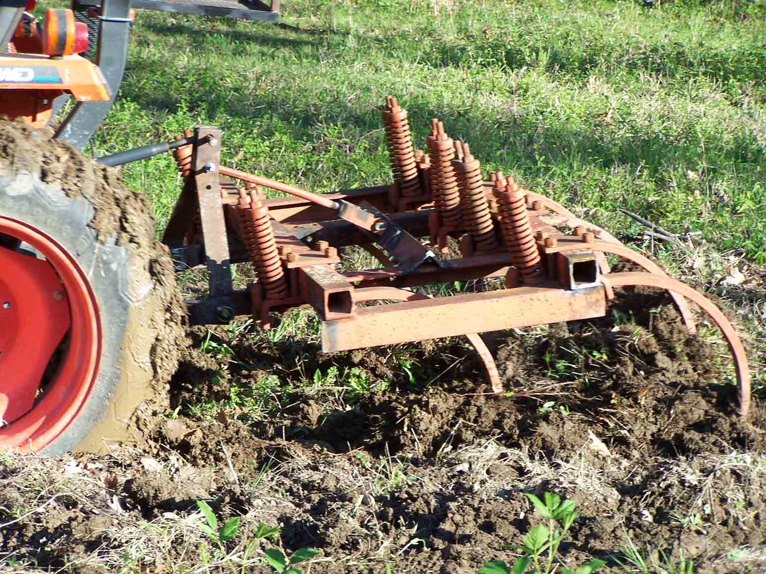

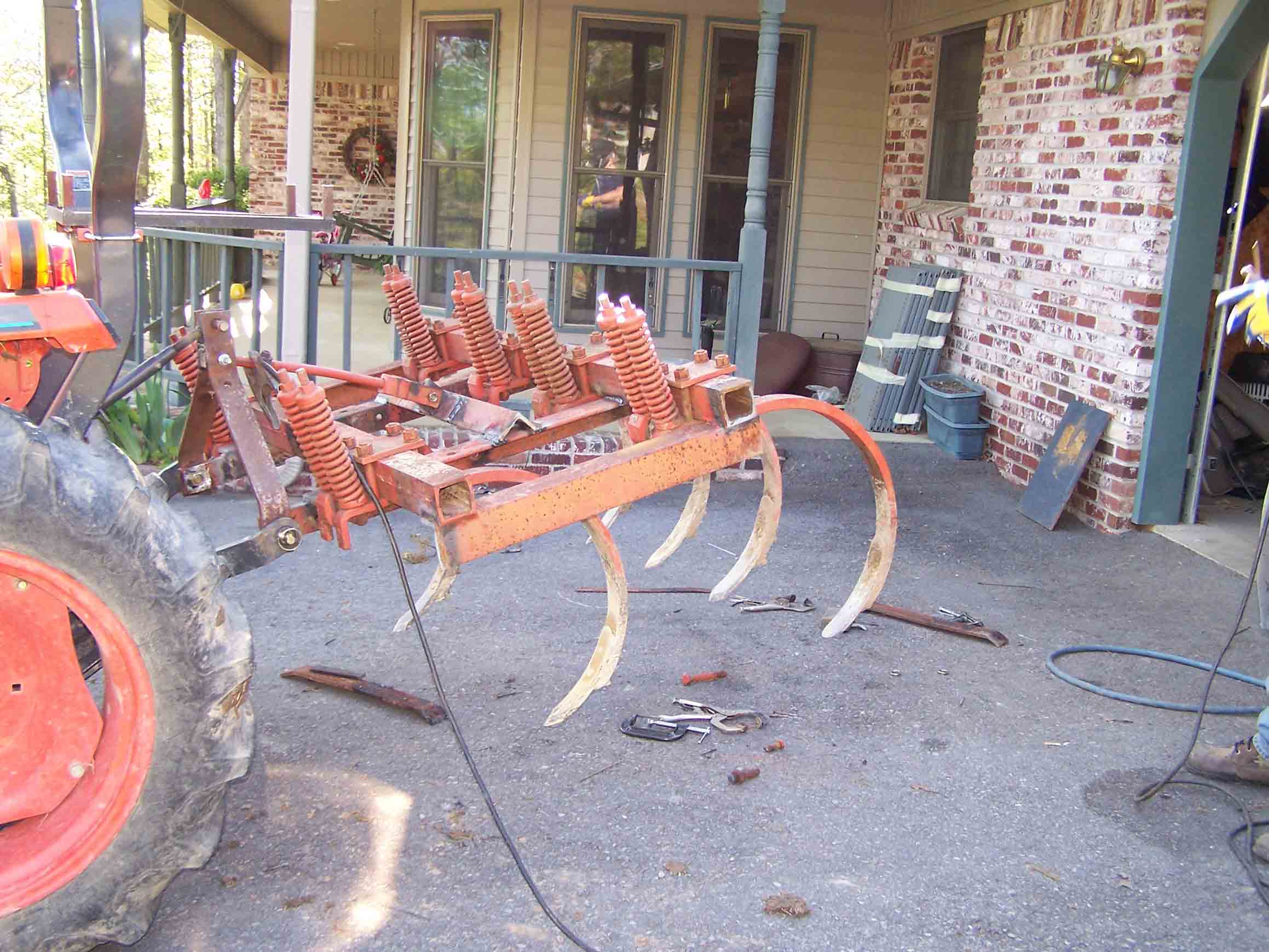

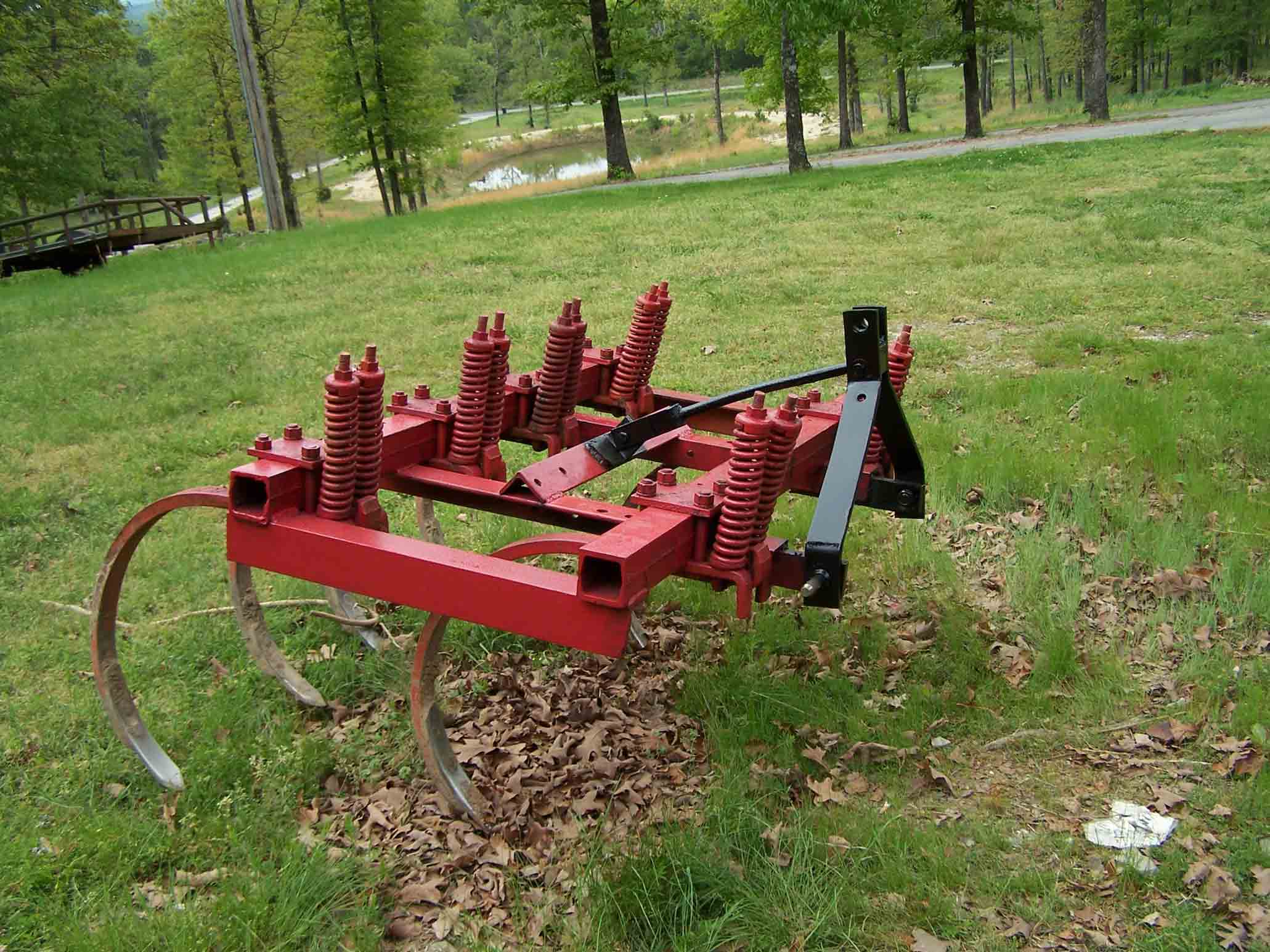

Here a spring tooth harrow I built from an old pull type harrow that was sitting in the woods of an old farm I hunt. It had small trees growing through it and I had to pull it out with my tractor.
The landowner said please haul it off saying it was trash!
So my son and I had to cut it into pieces with a oxy/acy torch and haul it off. I took part of the original frame and made it a new frame. The three point top part is from an old brush hog that also was rusting away.
I have very little money in it and it works great. So far my Kubota has had no trouble pulling it and if it does I can just remove a tooth or two.
One persons junk is anothers treasure!

That ground hole plow is now a chisel plow.That is a nice plow.If the ground is dry it will make it like power.
/ recycled plow #9
That is a spring tooth cultivator. It was used to till between crop rows to control weeds, got a few hours experience on them. You did a real nice job on the rebuild and it should be a handy implement.

You are right JerryG, that is a chisel plow, Being a boy who really did not want to be cultivating and 45 + years ago tends to make the memory fade . Thinking back our cultivator had shovels but was similar in build. Thanks for straightening me out!

I just got home from playing with it this weekend. I will say the thing will tear up some ground and it's my faster than my moldboard. I believe now I am going to remove at least one tooth, maybe two. The two rear middle want to clog up with large clumps of grass due to the spacing. also my 32hp will pull it but it tells me it doesnt like it. The weekend went so fast I just didnt have enough time!
If only I was rich and could spend more time doing fun stuff!
Next weekend?
