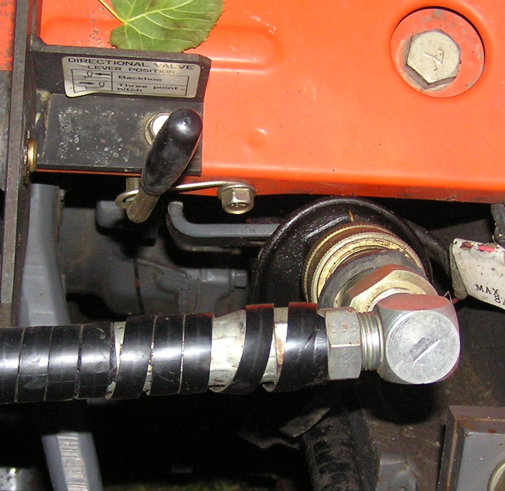

/ Remotes Spools - Power Beyond vs. Outlet? #15
DiezNutz,
I have a Kubota L-35 that came with the Factory FEL and BH. When I take the BH off I have to do 2 things.
1. I have to connect the feed and return line for the BH to each other, and
2. I have a lever/valve that I push or pull, depending on what I'm wanting to operate, BH or 3PH.
Does your tractor NOT require you to switch any valving around for proper 3PH function?
I've wanted to add rear remotes to my tractor but am not sure how this would be done with its present set up.
#16
DiezNutz,
1. I have to connect the feed and return line for the BH to each other, and Yes, that's right.
2. I have a lever/valve that I push or pull, depending on what I'm wanting to operate, BH or 3PH. You lost me at #2. :confused:
The only thing I have to do is #1 (complete the circuit) when I take the BH out of the loop. I.e.,
Pump -> FEL -> BH -> PCV/3PH becomes
Pump -> FEL -> PCV/3PH
I'm not sure either, without understanding what you mean by #2.
At this point I'm leaning toward plumbing my remotes off the rear block even though I already have existing lines I could take advantage of. Mainly because I don't want the remotes ahead of the BH. I still have a potential issue with the BH upstream of anything I add (let alone the 3PH), but I don't anticipate a scenario where I need to use remotes with BH attached, just like I don't use the 3PH when BH is attached.
[Only maybe if I converted my thumb to hydraulic, but I can't really justify the hassle vs. reward... it's pretty painless to work with the way it is. Plus I would only have to worry if I were loading the thumb with the remote, if I'm merely positioning it unloaded, should still be OK; the load checks in the remote spool would keep it in place without back pressuring the upstream BH outlet.]

/ Remotes Spools - Power Beyond vs. Outlet? #18
I hope this picture helps.
Just below the green leaf is the placard for the Directional Valve. I push it in when I'm using the BH and pull it out for 3PH use. To the right, and a little lower is one of the BH lines.
If I have remotes, I would think that I'd use this attach point and its corresponding line to power them.
Am I WAY off base with my thinking????
Thanks
It's not obvious to me how that valve is connected, unless... are *both* QDs on your tractor, or is one of them on the BH? If it's the latter, then isn't there a hose from the tractor that you must plug back into the QD shown in the pic?
Can you see any details of how this valve is plumbed? Maybe someone else with your model tractor could weigh in.
Nice leaf. Was that strategically placed over the lever as an attempt at modesty? :D
