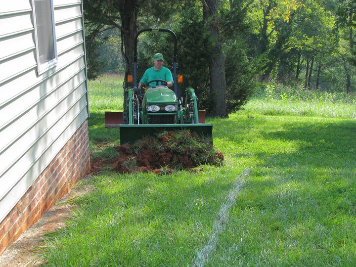

I have done it a few times with my tractor and FEL w/ tooth bar.. i used to get down on my hands and knees using a landscape shovel to 'dig' under the sod to remove it.. But if the conditions are right, (not too wet, not too dry)
here is a pic of me putting in one of our flower bed.. The toothbar is a necessity for this it seems though and as mentioned the bucket fill up quickly

You have a tiller.
If you really insist on removing the sod, till first to whatever depth you want removed.
The remove all the loose sod you just fluffed.
It will be easy to know when you get too aggressive and get into virgin ground underneath. It will be alot harder to dig.
I've put in several driveways like this. Til to the depth you want, and scoop nice loose dirt. Whole lot faster, easier, and easier on the machine than trying to dig virgin sod and ground. And a whole lot more precise at controlling depth
