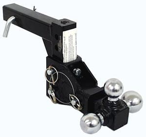

If you don't want to leave in your ball mount, or it is illegal, how about a hitch step?
Do a Google image search for
hitch step
for lots of variations. You could make one much heavier than some of the lightweight ones for more protection, and you would not be leaving your ball mount in place when not towing.
hitch step
Bruce
i've made hitch steps for both my trucks. they are real handy.. way easier than trying to climb up on a slippery bumper pad
