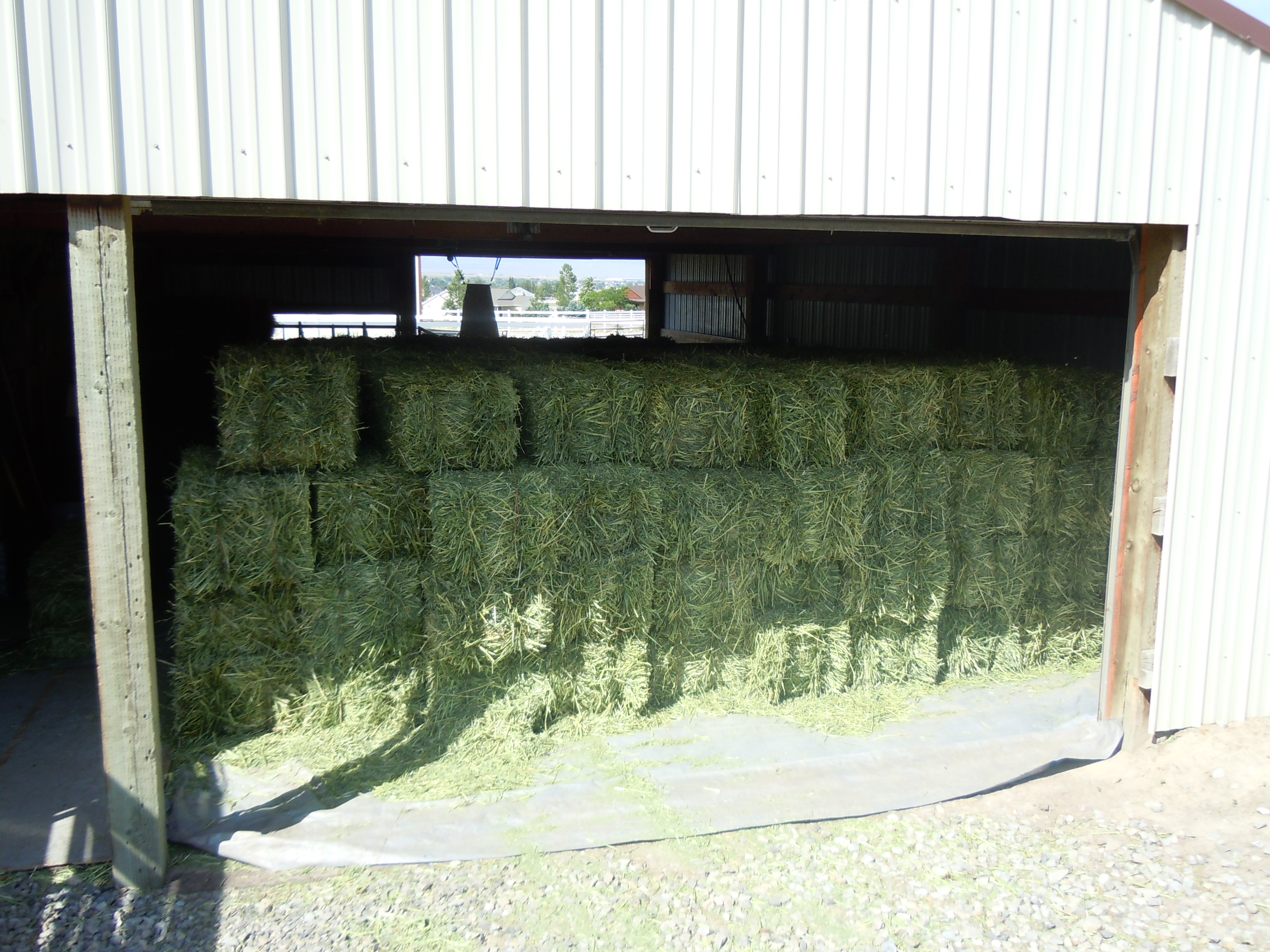

If you are going to continue to store hay take the time to throw a vapor barrier down before you pour.
I've never understood this. How does moisture in the ground turn to vapor and then penetrate concrete? Since every building should be on a pad slightly higher then the land surrounding it so rain water flows away from the building, if there was moisture in the soil under the slab, why wouldn't it travel the path of least resistance and work it's way sideways instead of against gravity and through solid concrete?
My understanding for the reason to use plastic under a slab, also called a vapor barrier, is to stop the moisture in the bottom part of the wet concrete from soaking into the ground resulting in an uneven curing process of the slab. This is only needed in soils that absorb moisture, or drain it. If you pour over gravel or on sand you would want plastic to keep the moisture in the concrete. If you are pouring on clay, there is no need for this.
Having said that, there is no harm in spending the extra money for plastic under your concrete if it makes you feel better.
Moisture seen on top of concrete is from condensation in the air.
To be blunt- the thinking is flawed. Concrete is a giant porous sponge. Between evaporation and the wicking action it has the potential to be a major issue. It's required by building code inside occupied structures.
As far as moisture escaping the concrete- that's why you wet your sand before you pour sidewalk, driveways and other non vapor barriered pours.
People assume concrete is waterproof- that's simply not the case- actually it's quite the opposite.

Eddie, The truth behind putting concrete in there is this; a year ago I was shoveling some BS (literally) out of the barn. I stepped back and my foot was on the existing concrete but hanging off and my ankle bent right over to the ground. (dirt) Nothing broken, but it was swollen for weeks and still is not as strong as it used to be. We purposely run ourselves low on hay just so we could do the concrete work. Usually there is always plenty of hay in there. I want a flat surface so I don't twist another ankle.
I'm kind of with you on the water vapor barrier thing. But it's not much at all to put down a barrier so I'll just do it. After all I've been using a tarp for 15 plus years under the hay. I have not had a problem with moisture yet. With the exception of baling with too much moisture content.

If I could have gotten the tractor in there I would have used it. Door height is 7' tractor height is 9'. Look closer at the pictures in the first post, you'll see the cab is to high to fit in. That is why I was trying to get my neighbor who has a Bobcat skidsteer. He would have been done in 1/2 hour. O well, my wife and I got some good exercise.
If it did crack it would be under this.
