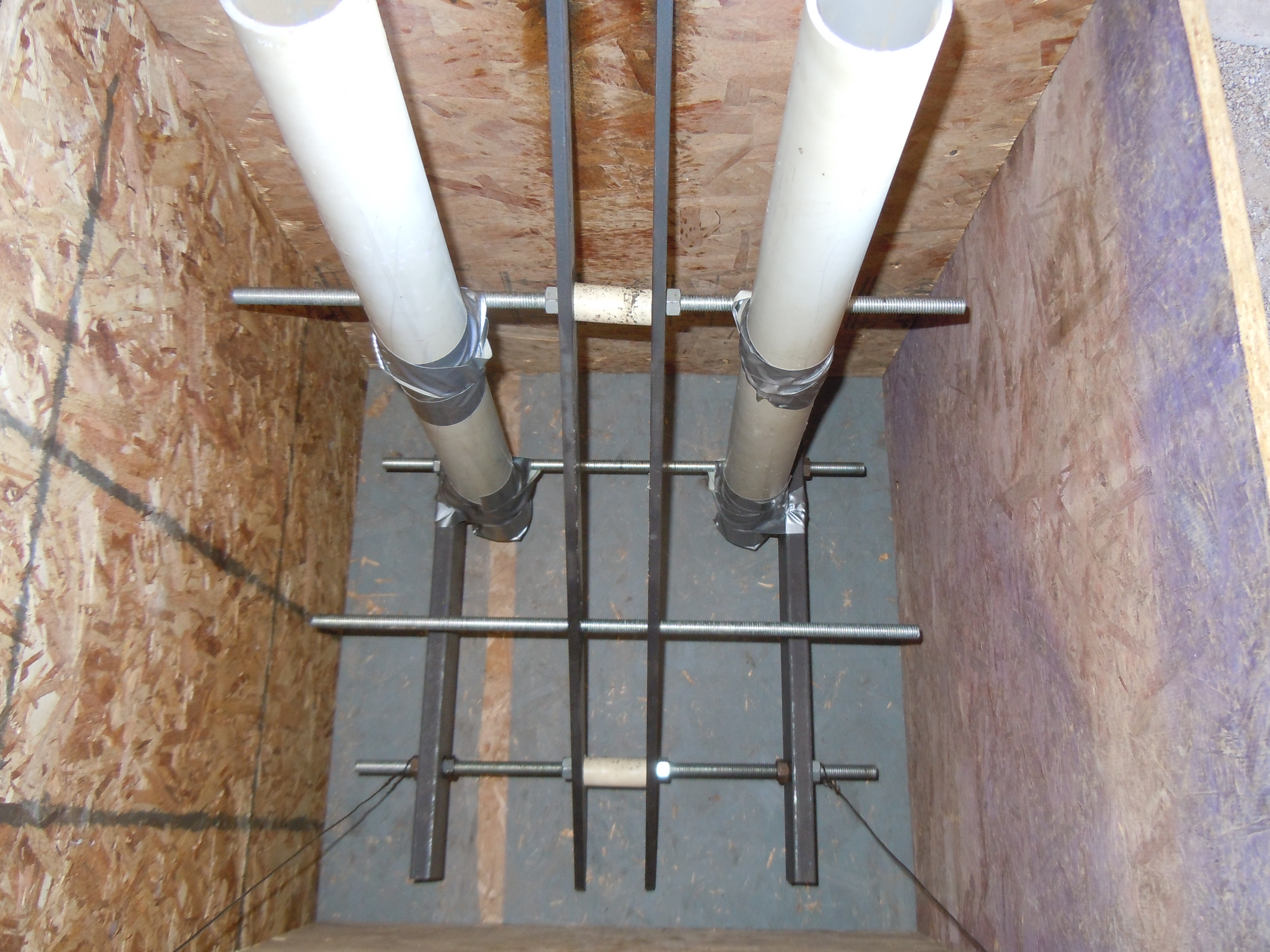

Sorry no pictures to back up my claim here, but I have been working on the ballast box. This baby is going to be impressive. I'll get pictures when I can. It will be 10 cubic feet in size, so roughly 1500 lbs. 2'x2'x30" and it will have a couple pipes for yard tools and a chain saw holder.
I'm hoping to be ready for concrete the week after next. All the dirt in the barn is leveled and ready for gravel.

I have the ballast box built and ready for concrete. It's been raining a lot so I'm waiting for the mud to dry so the concrete truck can get to the barn without tearing up my road. Here's some shots of the box. I do have a chainsaw holder that I'll stick in the concrete while pouring.
   / Removing dirt and going with concrete for barn. #30
Great idea to do it when the truck is there anyway. Looks like a great build and look forward to seeing the final product. Have been reading the thread as I plan to do something similar with our barn. One third of the area is already concrete, but hay and implement storage is currently pallets on top of dirt. Such a pain!
