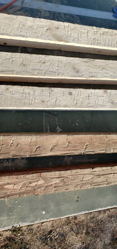

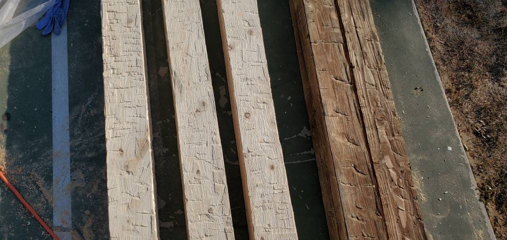

It took me four hours of solid work to treat three 20' beams today. It's exhausting work and a good portion was done while kneeling on the ground... even with knee pads, not fun. Oh and the amount of dust this produces is staggering. My sinuses are getting irritated even with the use of a carbon mask. I figure in inhaling the dust while taking breaks. But I'm more than half way done now. View attachment 671146View attachment 671147
You're using the wrong setup. Carbon cartridges are for organic vapor and solvents. You need a particulate filter for your mask. Or a particulate disposable mask.

I'll double check. Thanks for the reminder.

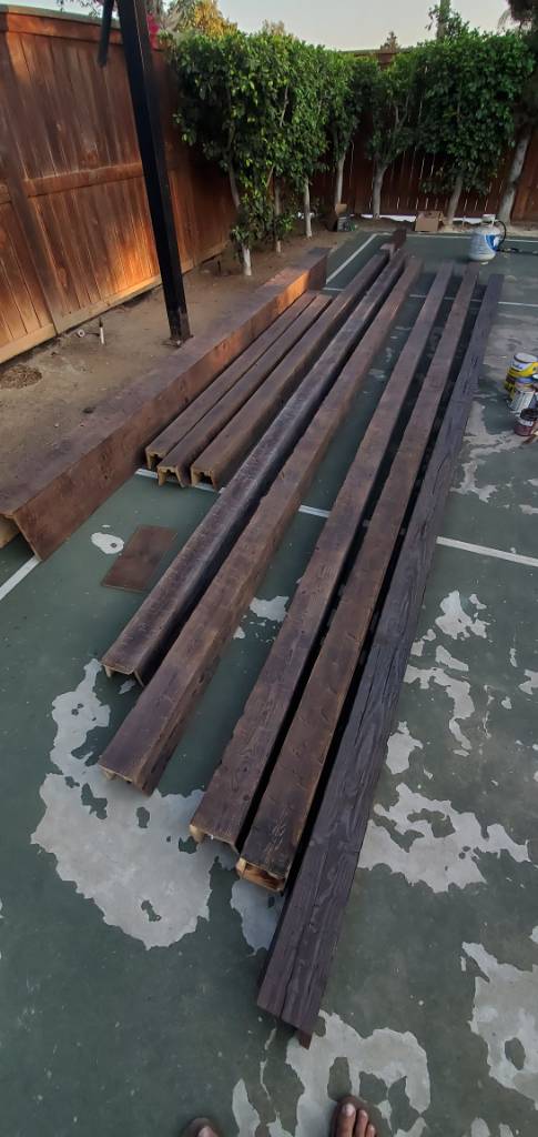

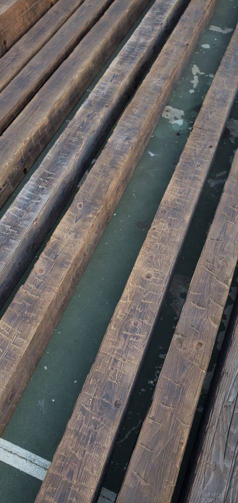

Finished the beams! I made 154 linear feet in total and will use 135 feet. Remember when I mentioned that the local places that make these charge $150 per linear foot? That would have been $20,250 for this pile.
The last update I had just finished the steps up to applying the minwax weathering agent. Let them sit in the sun for a couple days and the temps have been 95+... didn't realize how much kiln died lumber would cup. So I've got a bit of straightening to do when I install them, but nothing that will ruin the beams.
The final steps were staining and a coat of extreme flat polyurethane. I used a HVLP sprayer for both coats. I used almost a gallon of stain for all these beams but only a quart of polyurethane. I'm quite happy with the results... especially considering how much I saved (I didn't total everything up but I'm sure I'm under $1,500).

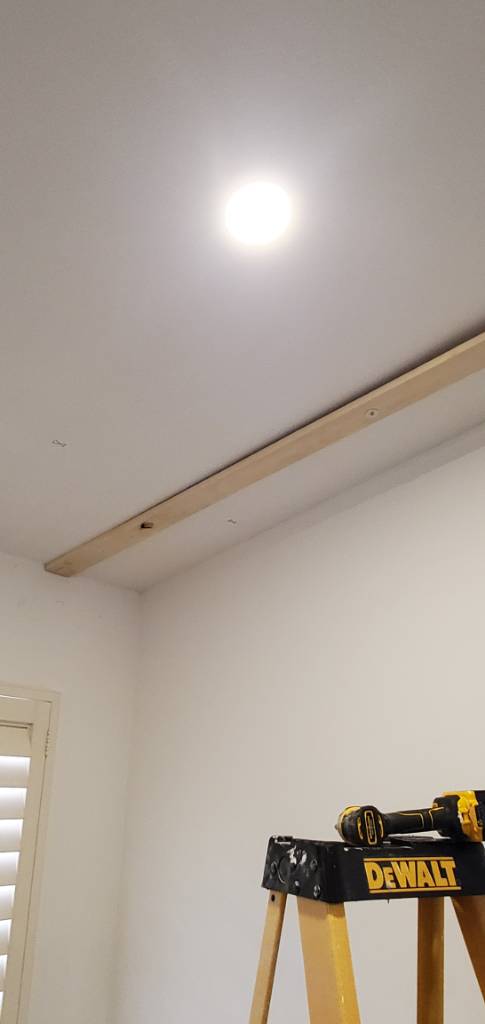

Started mounting the ceiling plates so hopefully tomorrow the project will be complete.
