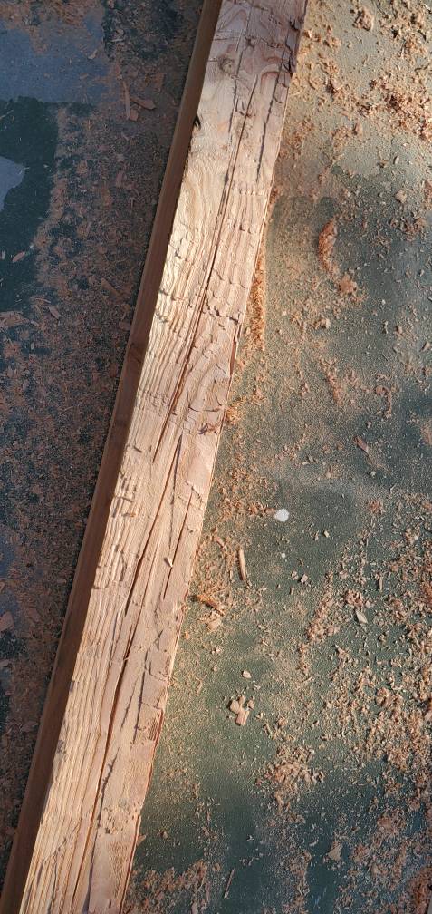

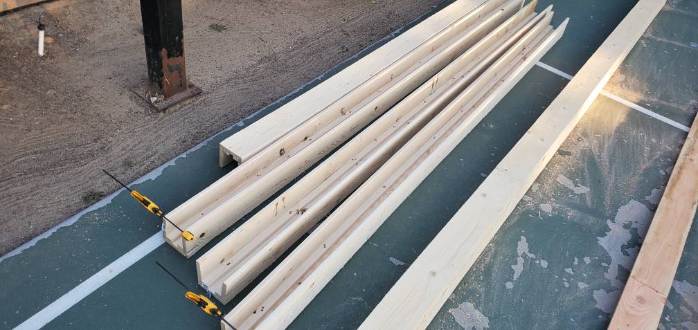

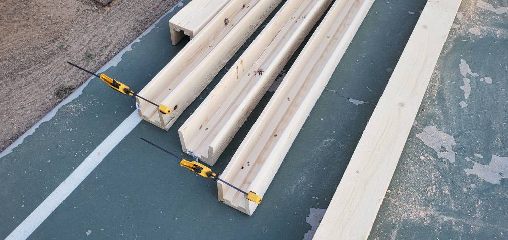

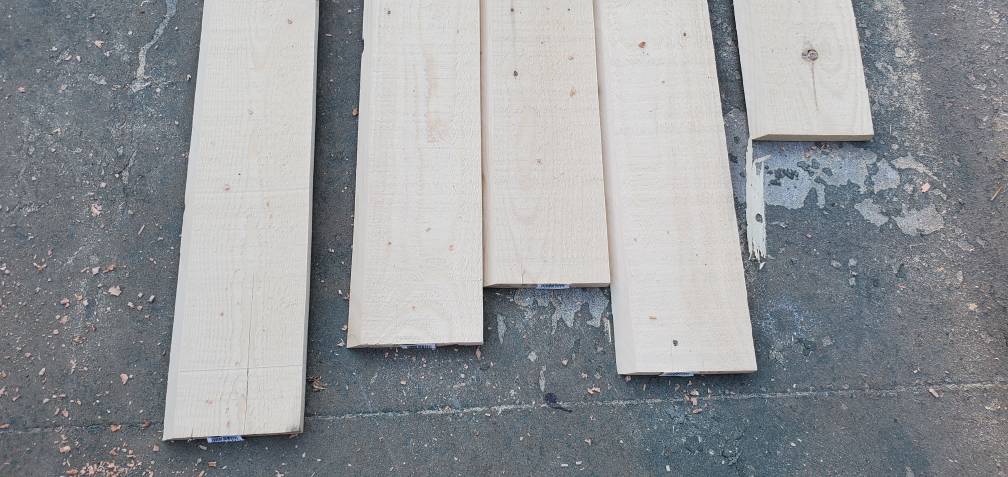

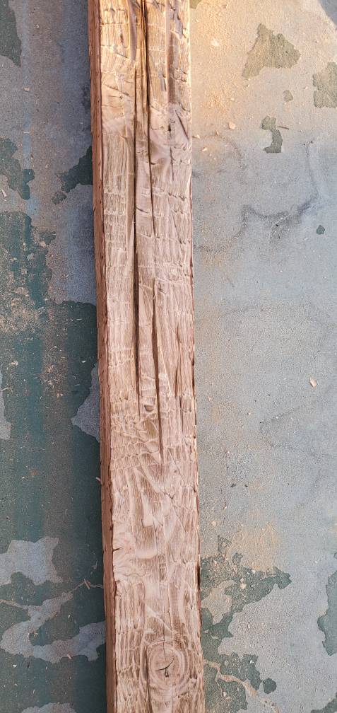

Today I picked up a planer ($45 Chicago electric), some hand tools like an awl and axe, propane torch ($35 HF) and a restorer ($99 craftsman at lowes) with wire brush wheel ($50).
I already had a Dremel ultra saw to make the faux cracks. The real game changer is the wire brushing... really starts to look distressed.

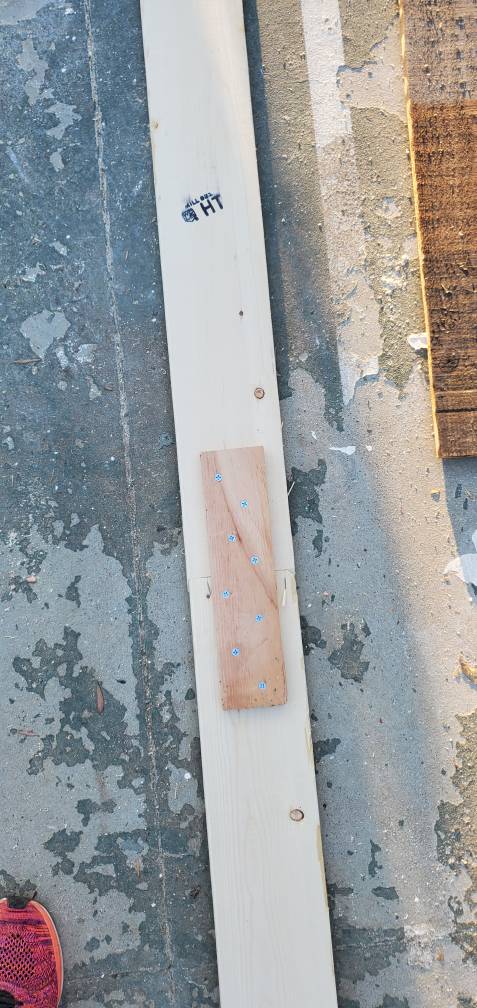

Only one box is made of doug fir which is the one I experimented with distressing first. The other boxes are pine. There was some serious cupping going on so I clamped those overnight and then resorted to adding a block to pull the cupped ends together. Gets the job done. Another photo shows the joint brace on the 20 foot sections.
The doug fir is shown before burning then after burning and a second light wire brush. Ready for stain tomorrow. 20200925_180151.jpeg20200925_180215.jpeg20200925_180211.jpeg20200925_180200.jpeg20200925_165049.jpeg20200925_175736.jpeg
