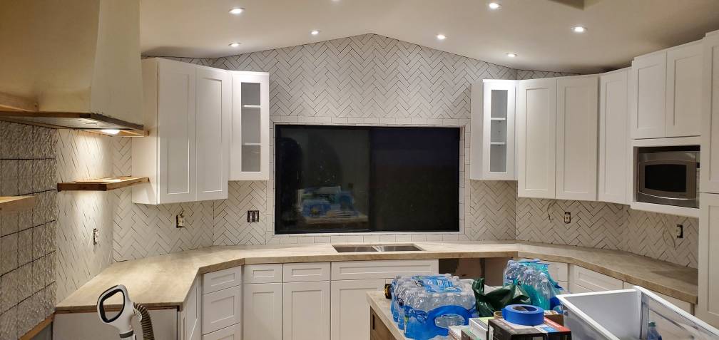

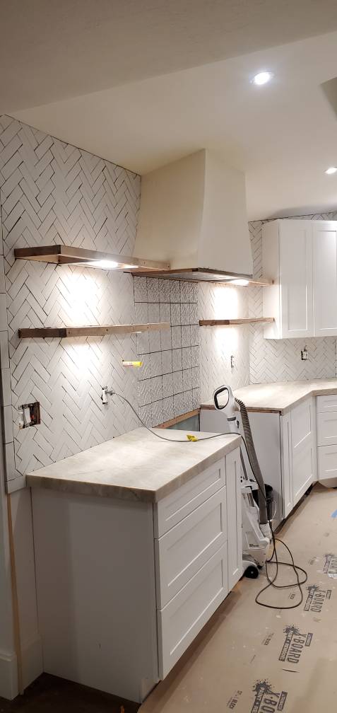

Update on the kitchen.
7 days
110 man hours
500 cuts
1200 tiles
The backsplash is set. Finally.
This was by far the most grueling part of this project. Biggest issue was the tile we used is a glazed Saltillo field tile which is made by hand in Los Angeles and the look is kind of rustic and irregular by design. You open a box and there's easily 3/8 inch size difference from the longest to shortest tiles. So when you're making a pattern that needs to come together in so many places, it basically becomes a nightmare of finding the right combination of sizes and gaps you need to get level rows and straight columns. It's suppose to look kind of hand made but a herringbone pattern can look really off if you go off. Since my kitchen has a vaulted ceiling and two 45 degree corners, plus a bunch of outlets, four shelves, and a custom curved range hood, just multiply the complexity.
I am not sure if I've used this word on this renovation yet but this was a nightmare. The third day I covered no more than three square feet in 9 hours as I worked on the areas above the cabinets.
I've been too tired to take many photos so I doubt this will illustrate the insanity but I'll get more shots when it's all done. 20201017_183059.jpeg20201017_183055.jpeg

Almost a month without updates but definitely not a month without work.
Recently completed: Everything in the kitchen except knobs and pulls (just got them in tartar yesterday). The kitchen jobs included:
Set 1,300 2x6 Saltillo tiles for the backsplash in herringbone pattern. This took, no joke, agonist 200 man hours and we had the saw setup only about 20 feet away. This backsplash was mental.
Also got the dishwasher and range installed, all cabinet trim, island posts, cabinet kick plates, sink, faucet, plumbing, garbage disposal, pot filter, under cabinet lighting... what else. I don't know. Oh, had to re-do the end caps on the island because the veneer we bought from the cabinet company bubbled. So I bought some 1/4 birch plywood and compensated by adding a step to the stain process to match the color to alder, which has more red in it.
Most of the items were uneventful, which is good. I've done appliance installation, sinks, faucets, plumbing, etc, so with enough trips to home depot it eventually gets done.
But I could probably post 5 pages about the backsplash alone. That was definitely the behemoth project for the kitchen as we chose a handmade Spanish style tile. These specifically are made in Los Angeles and are finished in matte white. We like the clean look of a white kitchen but also wanted to have the texture of these imperfect tiles ans let that along with the pattern we chose give us detail. But herringbone patterns really rely on very accurate lines and when every tile is a different size some being up to 3/8 inch longer than others it turns into a real hair pulling endeavor. Then in our kitchen, the two 45° corners and vaulted ceiling turned this into... I don't know, a nightmare?
The range, I'm excited about. At my last house I wanted one of these professional ranges but didn't want to pony up the money for one so wound up with a kind of pro-sumer kitchenaid model (which is great, actually, at about $1400 at the time). So this time around while blowing money on everything else I decided to fixate on a Bertazzoni range. These don't come cheap so I found a place that sells scratch and dent models online out of Arizona. Just so happened back in July they had the exact size and model I wanted, for 50% off and free freight. The photos looked like it was still new but it was listed as used. I took a bit of a risk and when it arrived sure enough it was brand new but had one dent on the side panel that hides behind the cabinet anyway. So I got this $4 350 model for $1,960.
My other appliances also came in at heavy discounts. Apparently covid-19 devastated the refrigerator supply chain for 2020, or at least that's what they told me. So the fridge I had bought for my last place was $900 more. That pushed me into the $2800 price point and then I got fixated on a 42" professional style fridge. I figured I'd pick one up used and indeed I found many for $2k or so. Bought one off a guy who said it came out of his kitchen... picked it up from his big expensive house, everything seemed fine. Got it home and the next day plugged it in. After 20 minutes an alarm is going off and it's not cooling. Spent $75 to get it diagnosed as beyond repair. The seller was nice enough to refund my money and not screw me over. But by then I had already set my cabinet layout for the big fridge and new these things are $10k and up. I didn't want to mess with another used one so I found a pristine model at American Freight (formally Sears Outlet) for $5500 (which was 50% off). Again, a big splurge but saved a bunch off of a new one and this was definitely a wish list item for me.20201008_173810.jpeg20201012_182110.jpeg20201013_133127.jpeg20201013_154132.jpeg20201017_183059.jpeg20201024_172145.jpeg20201028_202600.jpeg20201029_143151.jpeg20201030_181056.jpeg20201031_134316.jpeg20201030_181344.jpeg20200804_205922.jpeg
