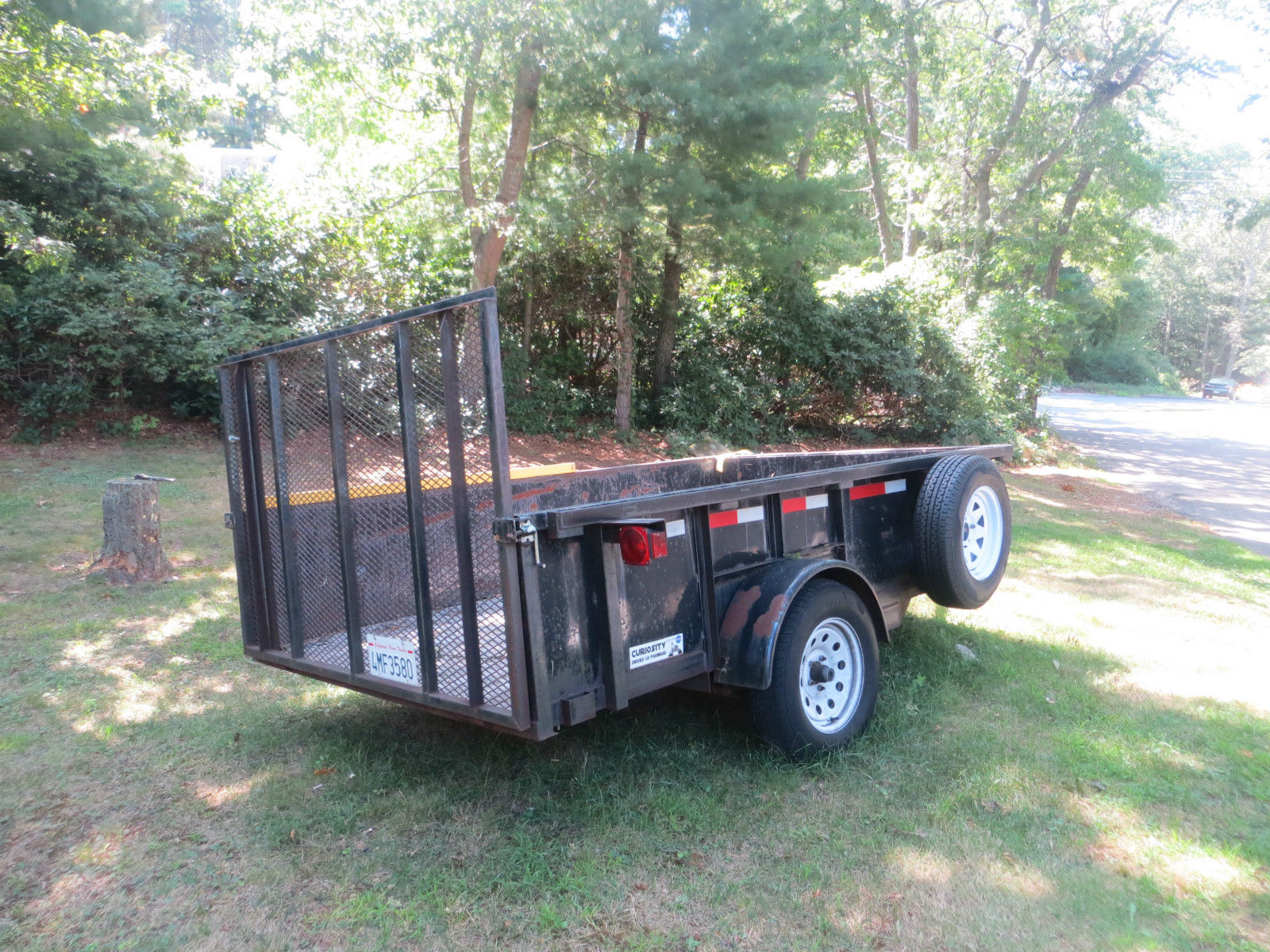

Since I am stuck at home for a while and the weather is turning nice, I've decided to repaint and replace the deck on my 6x10 trailer. My question is do I simply use 2x pressure treated wood for the deck, or would untreated douglas fir that I coat with preservative be better or something else like red or white oak? Its a single axle trailer rated at 3500 lbs, so I'm leaning towards pressure treated lumber. My other question is does it matter if I use 2x6, 2x8 or 2x10 for the deck? The current deck is 7 2x10's and one 2x6. I could do the same, or I could use 13 2x6's or a combination of any of them. Are 2x10's stronger that 2x6's or 2x8's? Or does it not matter. Using all 2x6's would cost $90. Using 2x10's with 1 2x6 would be $110. All tips or advice welcome. Thanks!
/ Repainting Trailer and Replacing Trailer Deck #2
I would use treated lumber the same size as the original wood. Then place the old board on the new one and use it as a pattern for the bolt holes. Also use new carriage bolts.

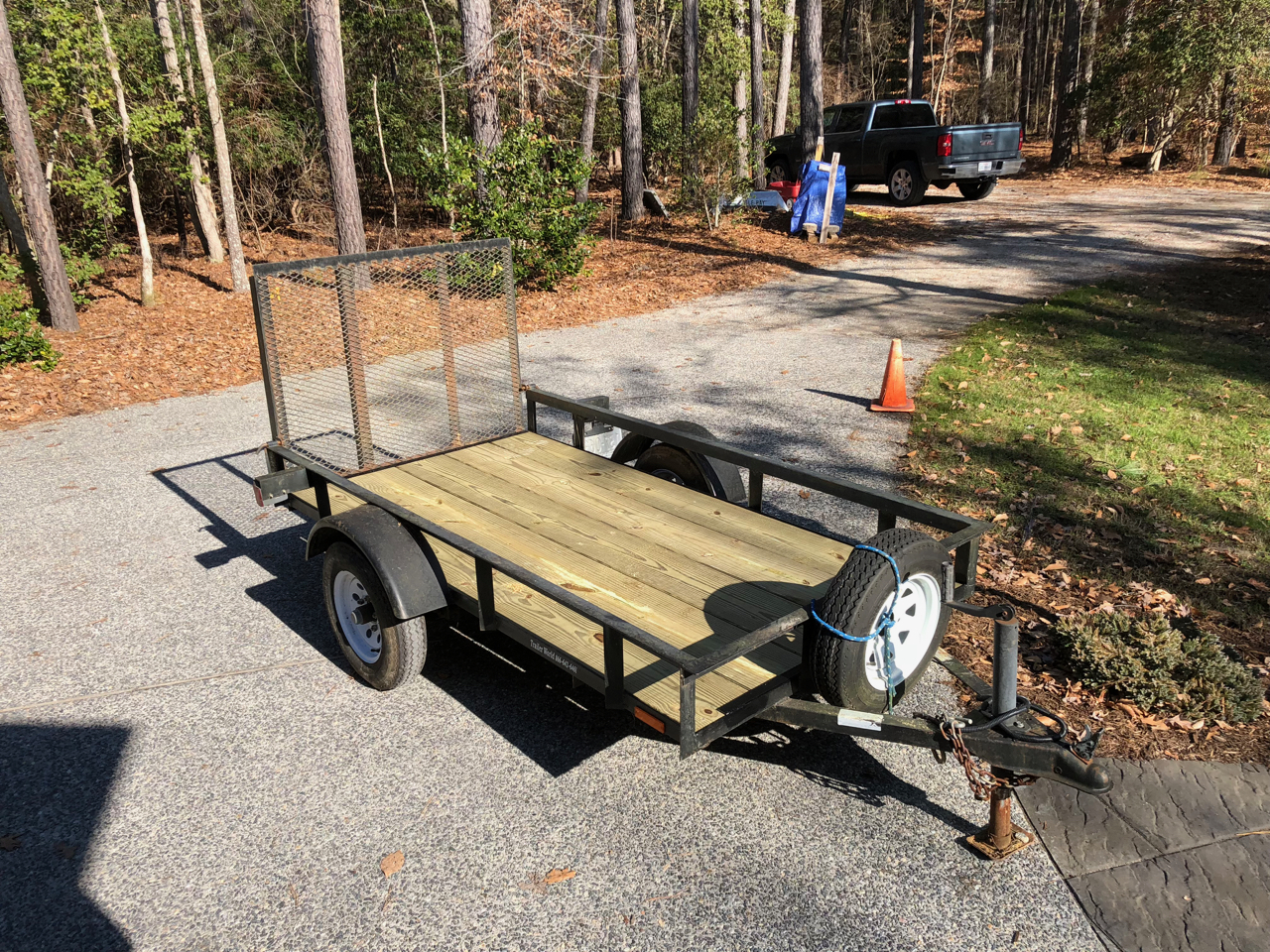

I am going a different route with my Big Tex 20 plus 5 trailer. The wooden deck has soft and rotten spots from being stored outside, and will need replacing very soon, if not before I use it again. I did some inquiring at places that I go to for tractor trailer repair and have found enough (combined with what I had already) to deck out my trailer in aluminum deck. Since I am still working 6 days a week, taking the time to strip it and replace it hasn't happened, and may not for a while but I have most of what I need. Hopefully this will be the last time I have to replace the deck! I may add a strip of wood between the aluminum for traction and occasional nailing of dunnage.
David from jax

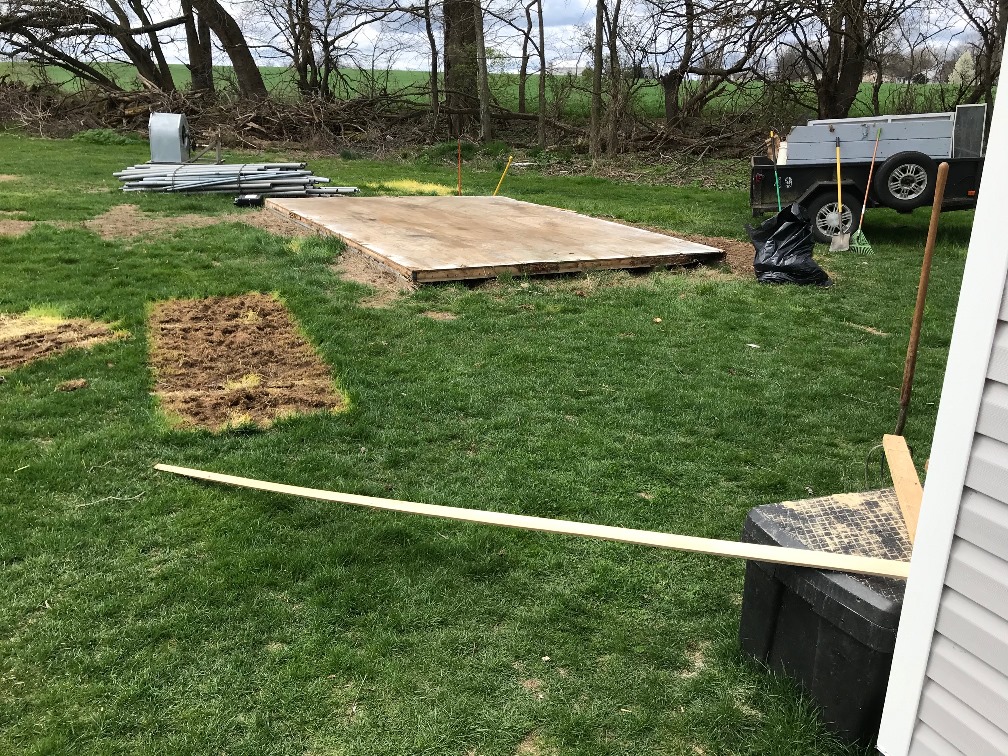

Speaking of pressure treated lumber, here are a couple pics from Saturday. I completed a new shed for the l4240 late in 2019. The wood deck pictured is from the oldest shed that we bought new in 1989. It sat there on a crushed stone pad till I pulled it out of the way to set a new shed around 2002. It's been sitting on dirt ever since. At that time I planned to burn the old shed, but came upon enough used steel to re-roof it and give it a few more years for overflow from the new shed. Last year we pulled it out of the way again. This time it was to build the newest shed that the L4240 would fit into:
https://www.tractorbynet.com/forums/projects/420084-found-piece-lawn-mower-shed.html
The unplanned vacation caused by CV-19 is giving me a great opportunity to catch up with work here. Last Friday I had all the stuff removed from the old shed and either tossed it or got it into storage. By Saturday all that remained of the oldest shed was the floor and its framing. By the end of the day even that was gone. Remarkably, the 4x4 sleepers that were under the shed looked as good as new. The closeup is the underside of one of them after a quick scrape with a flat shovel to get some mud off of it.
