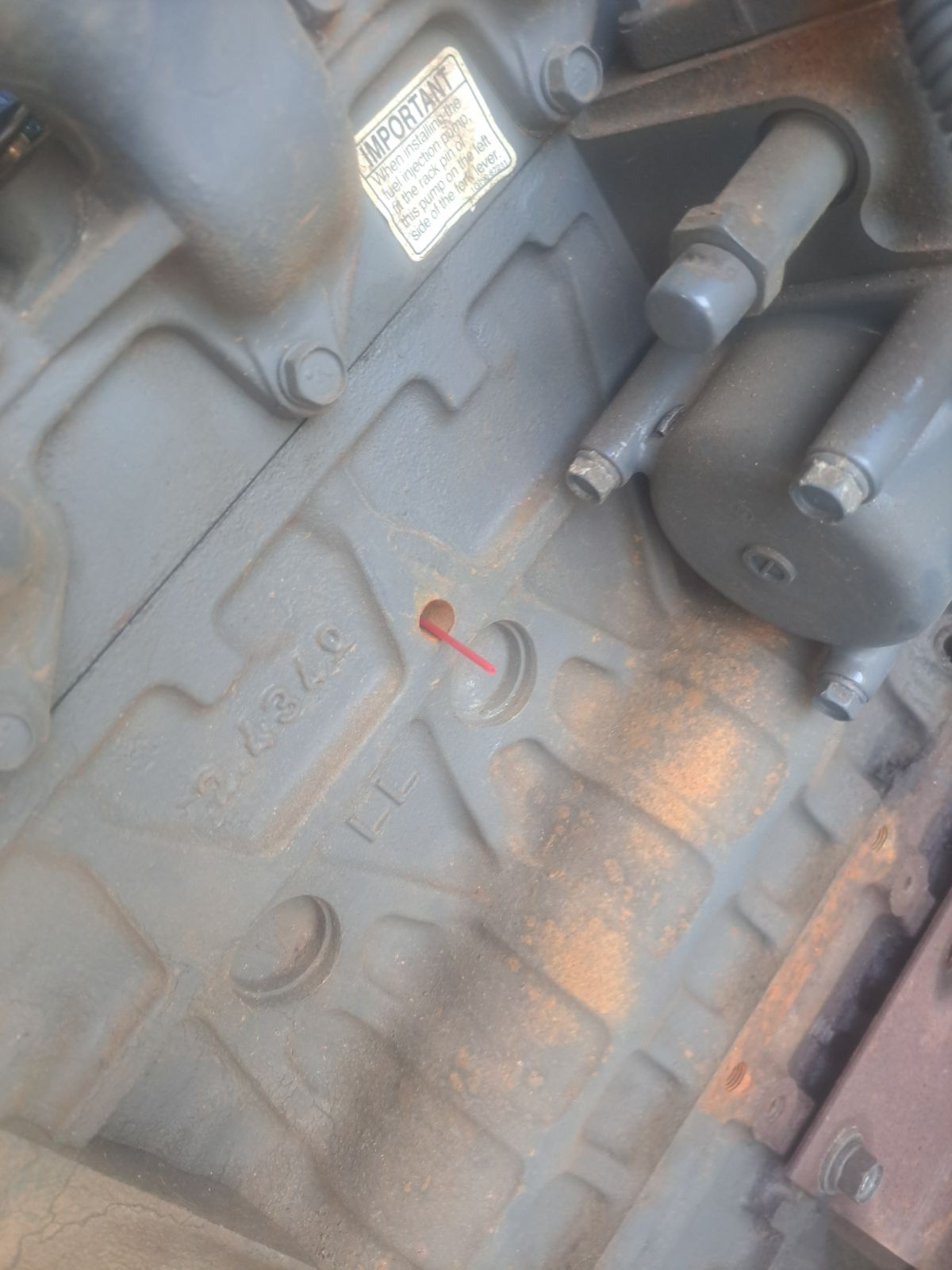

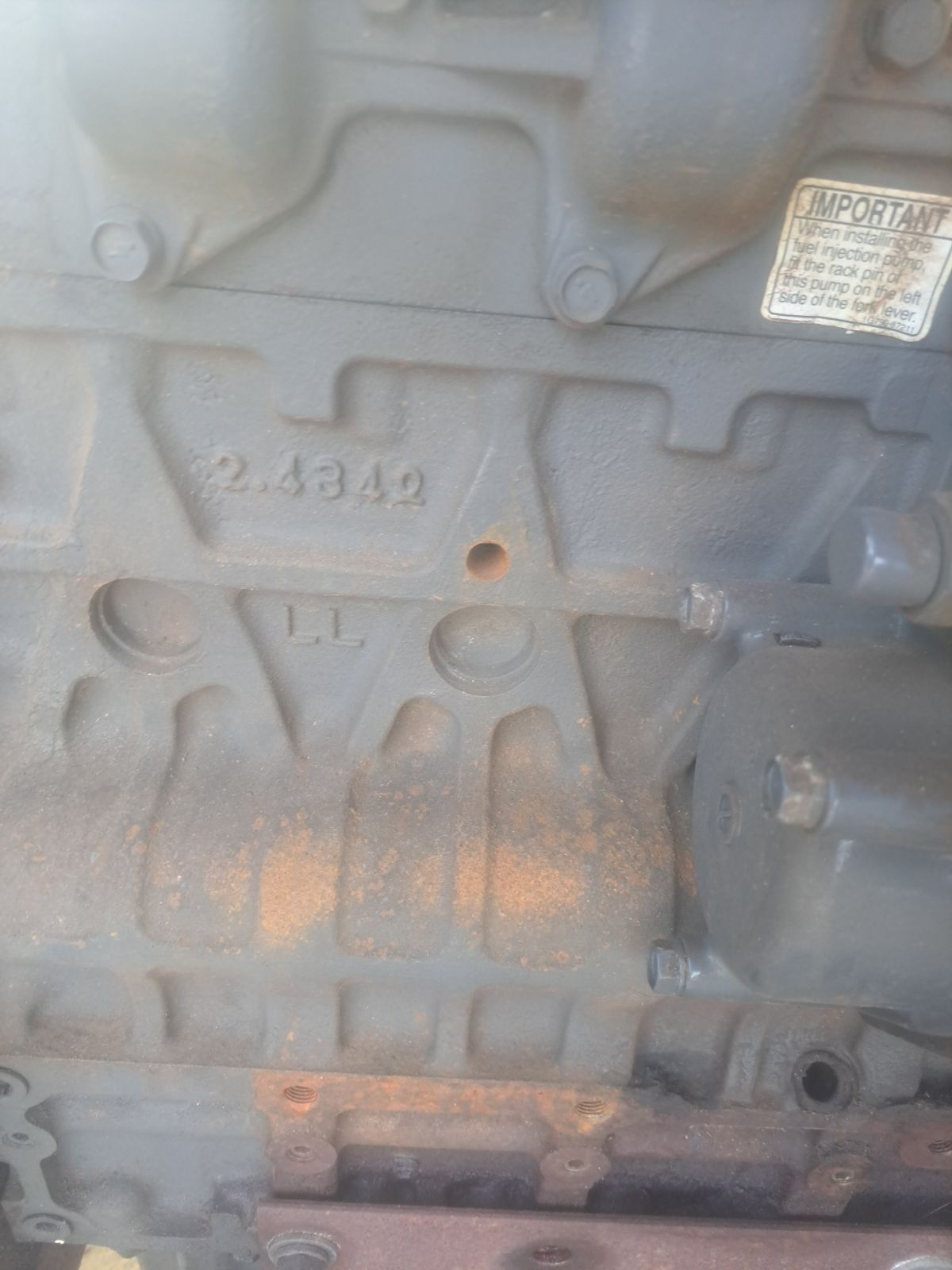

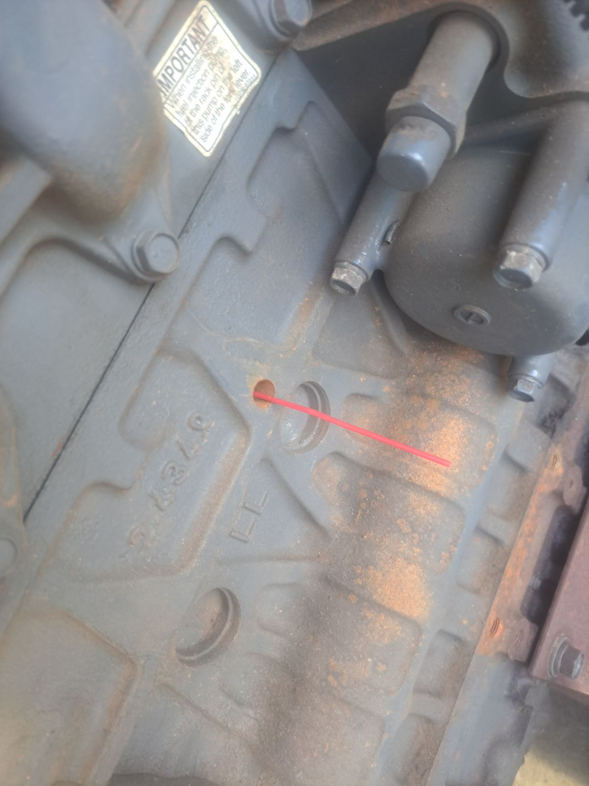

I had the dealer install a new engine in my Kubota L4740 when it spun a bearing
In order to get the new engine from Kubota, they required the dealer to drill the block
Now I would like to rebuild this engine and am wondering what it would take to repair the drill hole
See pics

If it's only into water jacket, I would venture to guess to tap threads into in and install a plug.... It's drilled all the way into a cylinder, it's pretty much dead.... IF drilled all the way into cylinder you "might" sleeve it but it would be rather ifie....
What is the concern with sleeving if into the cylinder?
/ Repairing Drilled Engine Block #4
If it was drilled into a cylinder a sleeve would fix it unless the sleeves were the ones with seals on the ends to keep coolant out. Then you'd need to plug the hole. You could do that with epoxy if you can get tools in through the water jacket. Or cut a larger hole in the outside of the water jacket, weld up the hole and then welt the cut out part back in.

No experience with this, but could you pull the sleeve for that cylinder, tap all the holes in the block, put in a set screw with the threads covered with epoxy in each hole in the block, then put in a new sleeve?
/ Repairing Drilled Engine Block #7
Rebuild kits for the V2403 engine show replaceable liners. Both holes through the casting would have to be tapped and plugged. The outside hole may have to be bigger to allow the tap to reach the inner hole. Use a high temp thread sealer.

Is that all they did to the block? It wasn’t uncommon to pour glass shards in the oil and run them until they seized. As for the hole it could be brazed over and a cylinder sleeve installed if needed.

As mentioned, the depth of hole is important as well as what it hit. That doesn't look too different from the freeze plug just below it. So if it looks to only be in the water jacket, perhaps just pound in a new freeze plug the size of the hole.

From the pics, it looks like that red depth probe goes all the way into a cylinder, which would make repairs pretty difficult. If it's a sleeved engine, you might be able to punch out the outside hole a bit bigger so you can tap the inner one for a plug, seal it good with JB or braze, smooth it down with a die grinder, then tap the outer one or size it for a drive in frost plug. Seems like a lot of work for an iffy repair at best.

Time to invest in one of those $79 borescopes and take a closer look at what they drilled into! If it didn't hit anything important, it might be do-able.
