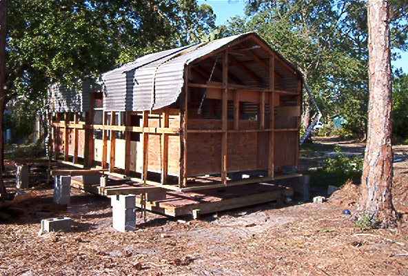

#14
Here it is on the set-up blocks with the 4x4x16's slid under the footers.

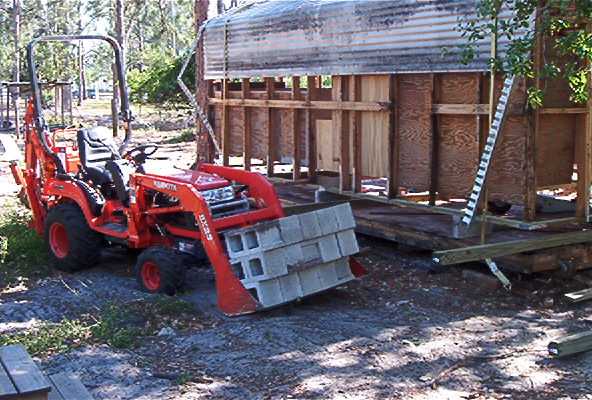

#15
The BX23 bringing in the blocks for the columns.

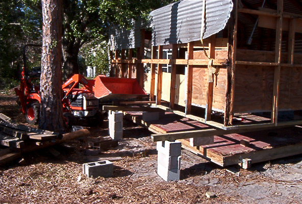

#16
BX23 lifting the shed into position so the 4x4's can be placed on top of the blocks.

#17
And it's on the blocks

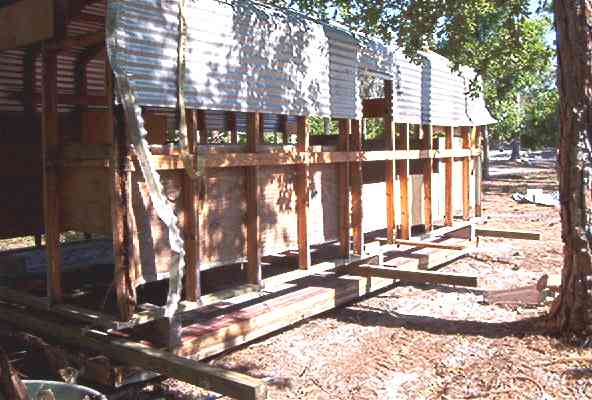

#18
Strapped down at corner so it doesn't blow away

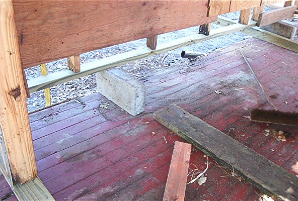

#19

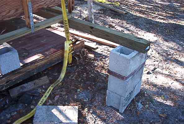

Double posts in the center under the butt joints at the footer. After taking this picture I realized I had both posts supporting the same side of the butt joint, so I picked up the footers with the floor back in the pic, and re-positioned the one post to the other side of the joint.
And this is it for tractoring this weekend. Thursday last week I had 36 ebay auctions end, and I've only packed and shipped 29 of those itesm. I need to go pack up the rest so they can ship Monday.
Next week after work I'll slowly be tearing up the tongue in groove floor, and replacing any rotted floor structure, and putting down 3/4" PT plywood as a new floor. Then I drop the shed back on the floor.
